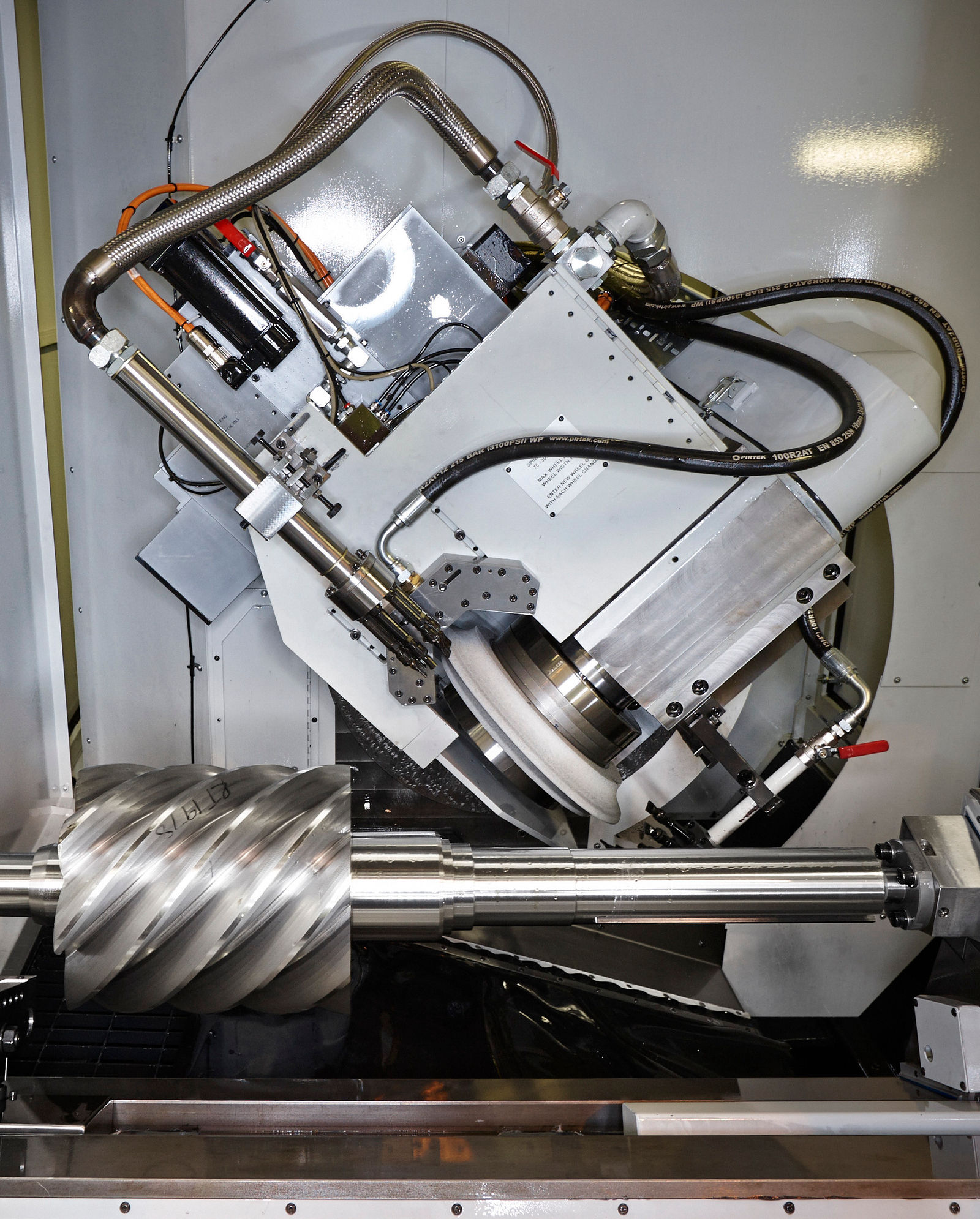

PTG Holroyd’s TG Series is widely regarded as setting the industry standard for high speed, high accuracy, and efficient stock removal. With the inclusion of the Sinumerik One CNC, the machine tool manufacturer believes its TG range of helical rotor and thread grinding machines will be even more appropriate to its global customer base. Enhanced connectivity is provided via additional Profinet interfaces, OPC/UA interfaces, and increased performance–all made possible thanks to a PLC that is 10x faster than earlier Siemens controls. From a machine tool manufacturing perspective, using the CNC’s Create MyVirtual Machine capabilities, in tandem with its internal design packages, will enable PTG Holroyd’s design teams to develop all software and PLC controls on the desktop. “Just as with our HG range, this will reduce lead times significantly,” adds Mark Curran, “avoiding the need to have the physical machine on the shop floor before commencing software development.”
Equally suited to prototyping, batch, and volume production, PTG Holroyd’s TG Series machines are designed primarily for the finish grinding of helical screw components such as worm screws and rotors after they have been milled to a rough or semi-finished state. The TG range starts with the TG50E, a machine designed to precision grind components of up to 50 mm in diameter and 610 mm in length, with models offering stepped increases in capability up to the production of helical components measuring 450 mm in diameter and 2020 mm in length. Each machine’s advanced automation means reduced setup time and significant production time can be saved because diamond dressing discs are continuously dressed during the semi-finish grinding cycles.
TG models offer production rates and accuracies to suit precise manufacturing strategies. Fully automated on-machine probing provides closed-loop feedback of corrections to the dresser wheel and does not require a high level of operator skill.
