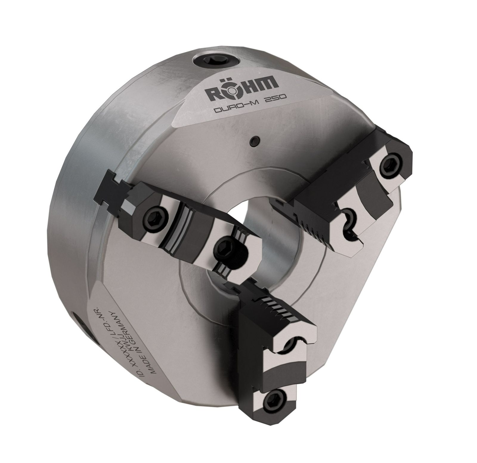

The variable machining of turned parts has never been easier. This is made possible with Duro-M, the new geared scroll chuck, innovative lens geometry and optimized power transmission by Röhm. The company supplies its new lathe chuck generation across the whole range with two, three, four or six jaws. This way, even particularly thin-walled workpieces can be clamped and machined perfectly.
“The Duro-M is our new series of lathe chucks for the clamping of turned parts on turning and milling machines, rotary tables and dividing attachments with conventional clamps. We have the right Duro-M solution for every application, so that all metal workers can truly benefit from the many advantages of our new geometry,” said Jörg Bauriedl, product manager for the manual lathe chuck division at Röhm.
The new Duro-M series has a noticeable lens recess, which provides users with a whole host of benefits. Thanks to this significant recess, the lathe chuck becomes lighter. With its reduced weight, the Duro-M goes easier on the bearings of the turning machine spindle compared to other lathe chucks, and at the same time it enables acceleration with less demand for energy.
There is an added benefit with regard to the workspace, so that the machining tools are better accessible, and for example drilling or milling operations on the turned parts near the clamping position can be much more flexible than before.
“As the milling cutters do not need to be unclamped as far, the risk of oscillations is reduced. Machining is safer and more precise – this enables higher cutting speeds,” said Bauriedl.
The new Duro-M series impresses with an excellent power transmission, so that the maximum clamping force can be achieved with low expenditure of energy. For particularly quick and precise alignment of the Duro-M series’ lathe chucks with the machine spindle, they are equipped with a control edge. This enables the user to optimize concentricity using the dial gauge already during setup, saving time during commissioning of the machine.
