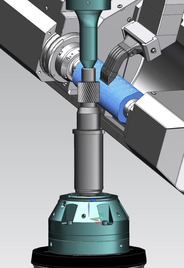

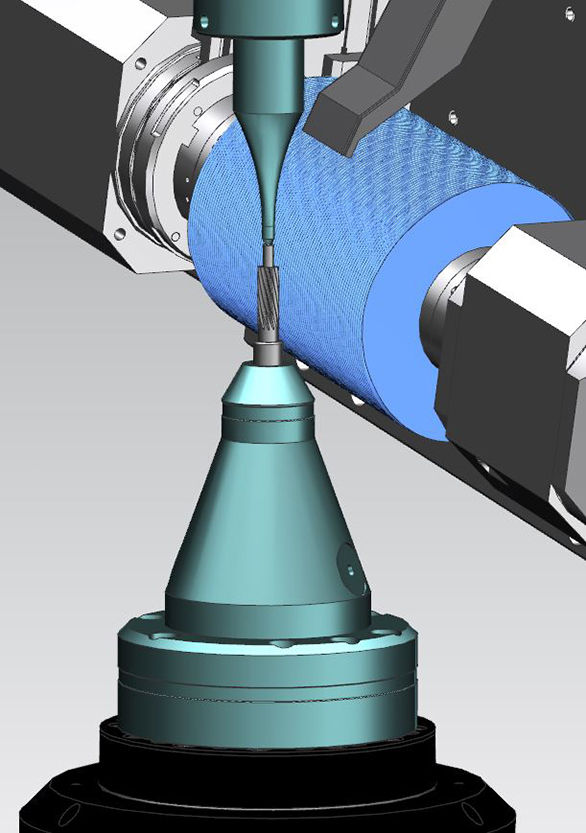

Up to now, the hard finishing of gears with interfering contours has mainly been accomplished by discontinuous profile grinding or gear honing.

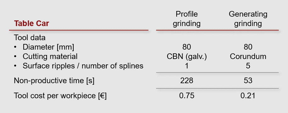

Compared to continuous generating grinding, both aforementioned processes feature different disadvantages in terms of productivity, economic efficiency or quality consistency. The problem is that the common grinding worms measuring 300 mm in diameter are too large to handle components with interfering contours. At the same time, smaller tools require higher speeds in order to achieve high cutting speeds. However, previously implemented machine concepts were not designed for the high dynamic requirements regarding tool and workpiece drive. New types of high-speed spindles in combination with a dynamic direct drive of the workpiece axis offer a solution. This enables the exploitation of the advantages provided by generating grinding – a process that features shorter machining times, lower tool costs and a very high level of quality consistency. The economic efficiency of generating grinding in direct comparison to profile grinding can be demonstrated by means of the two selected components "car" and "bike" (as shown in Figures 1 and 2). The corresponding tables ("Car" and "Bike") provide an overview of the related time and cost benefits.
| Figure 1 Workpiece “bike”: Tip diameter: 11.8 mm; module: 0.72 mm, number of teeth: 13, face width: 12 mm | |
Figure 2 | |
