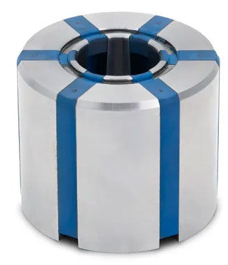

The latest generation of segment collets from Gleason ensures exceptionally accurate and reliable clamping in the part bore, while the new segment clamping sleeves’ universality enables clamping a wide range of components.

Segmented collets usually consist of an assembly with segments made of high-strength steel, which are joined with vulcanized high-tech elastomer using an injection molding process. This combination provides a larger expansion range than steel alone and also dampens vibrations. The expansion (chucked) or contraction (de-chucked) of segmented collets is usually carried out with an expander, which is actuated by a draw rod within the production machine. When the drawbar is actuated, the expander causes the segmented collets to expand and exerts a particularly rigid clamping effect via the end face, respectively, a pulling effect on the workpiece.

Gleason segmented collets are recognizable by the typical blue color of the high-tech elastomer and can be used on workholding devices from all common manufacturers. The standard product line of segmented collets covers a range from 20–120 mm in fine increments of 0.25 mm, with an excellent concentricity of ≤ 0.005 mm. Additionally, Gleason manufactures clamping collets according to customer specifications on request.
