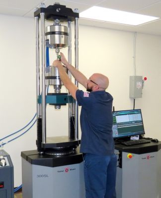

Solar Atmospheres has traditionally outsourced all tensile testing by utilizing excellent locally accredited independent laboratories. Due to shipping and transporting test specimens to these laboratories, a delay of 24 to 48 hours before the lab even received the specimens was normal. With a keen ear to our customers' needs of receiving tensile results faster and more efficiently, Solar Atmospheres of Western PA set out on a continuous improvement initiative to bring tensile testing in house. In the summer, Solar took delivery of a new Tinius Olsen 300SL Universal testing machine and installed it in a temperature controlled environment. In addition, in order to custom machine test specimens, Solar Atmospheres of Western PA purchased a new Haas Model TL-1 CNC lathe. Both units are physically located in a brand new 10,000 square foot facility adjacent to its 75,000 square foot state-of-the-art vacuum heat treating production facility.
