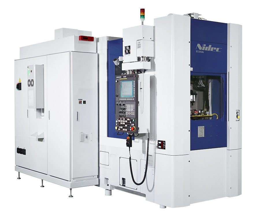

Both Nidec and Wenzel can utilize the international VDI/VDE gear data exchange format. Our joint effort with Wenzel offers gear manufacturers the ability to automatically make corrections to the process based on inspection data. This was shown at IMTS on our internal gear generating grinder, the ZI20A-G.
