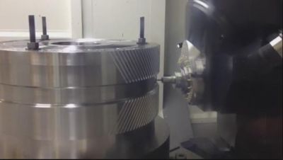

Timken Power Systems equipped the facility with two 5-axis machines that employ gear milling technology instead of the traditional hobbing process. These machines can perform up to six different operations used to produce helical gears, shafts and pinions from raw material, with the potential to reduce the OE production cycle by weeks.
"The gear milling process, for example, can reduce pure machine time of a standard-sized gear from 110 hours to 25 hours," said Boyd Swearingen, general manager of the new facility, as well as Timken Power Systems' business in the Gulf Coast, Latin American and Middle East regions.
The milled gear teeth are finish ground on a traditional Hofler form grinder to achieve the required AGMA 14 quality level of Philadelphia Gear drives. Before shipment, each gearbox then undergoes a full-speed no-load spin test that measures sound levels, temperatures and vibration.
