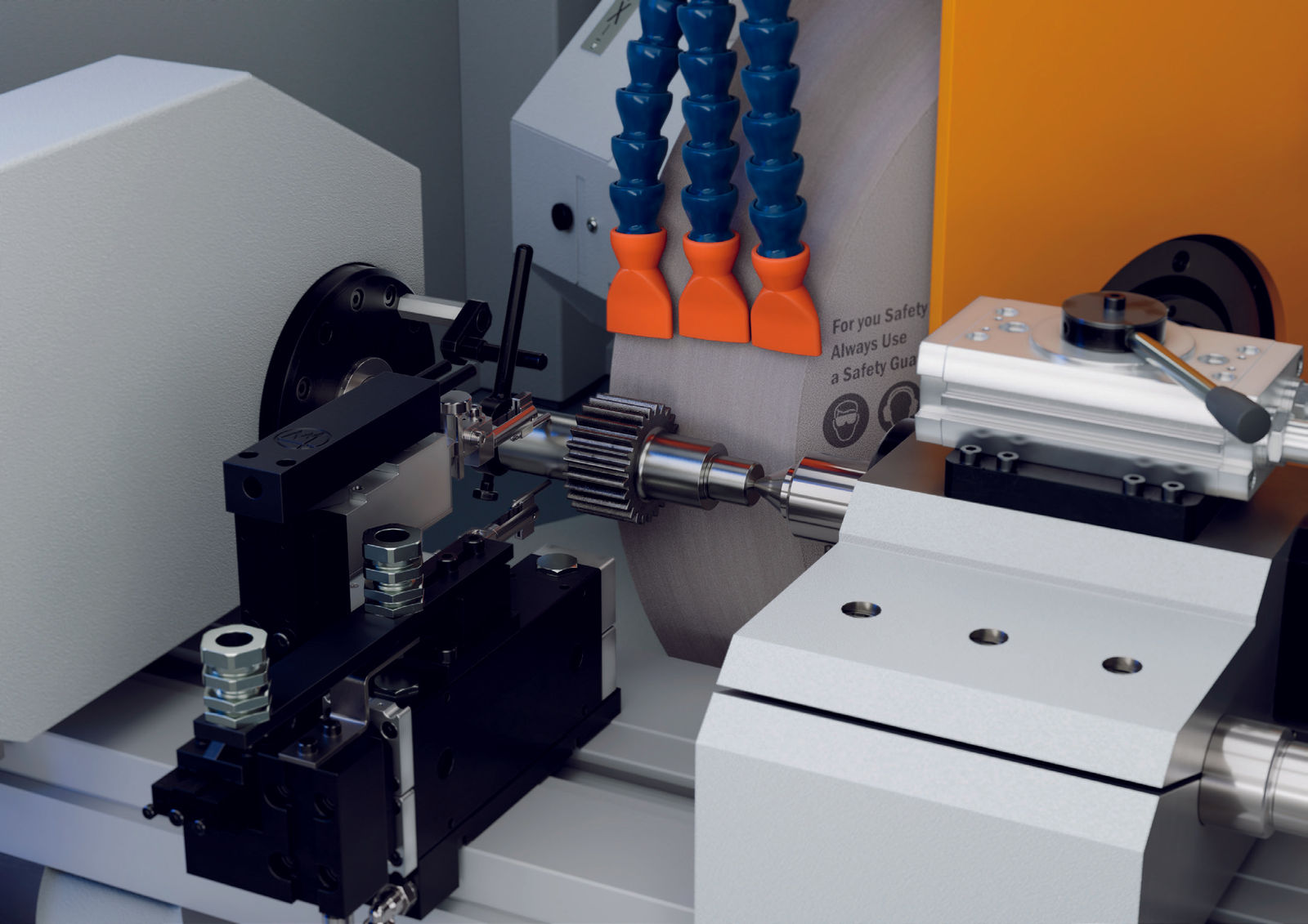

In-process measurement control enables the grinding machine to measure the grinding process and to adjust accordingly, improving the precision and accuracy since deviations can be detected and corrected in real time.
In-process measurement control enables the grinding machine to measure the grinding process and to adjust accordingly, improving the precisionand accuracy since deviations can be detected and corrected in real time.

  • Probing and Sensing Technologies: Advanced optical and tactile probes enable in-situ measurement, reducing the likelihood of dimensional errors. In-process measuring systems contact the part during the grinding. Once the desired diameter is reached, the program disengages the wheel and the process continues.
  • Force Monitoring Systems: Continuous monitoring of grinding forces helps in detecting anomalies such as tool wear or excessive heat generation. Production parts often arrive to the grinding process with too much or too little grinding stock. The grinder’s built-in ability to monitor these differences, called “GAP and Collision Control,” improves cycle times and avoids damage to equipment and scrapped workpieces.
