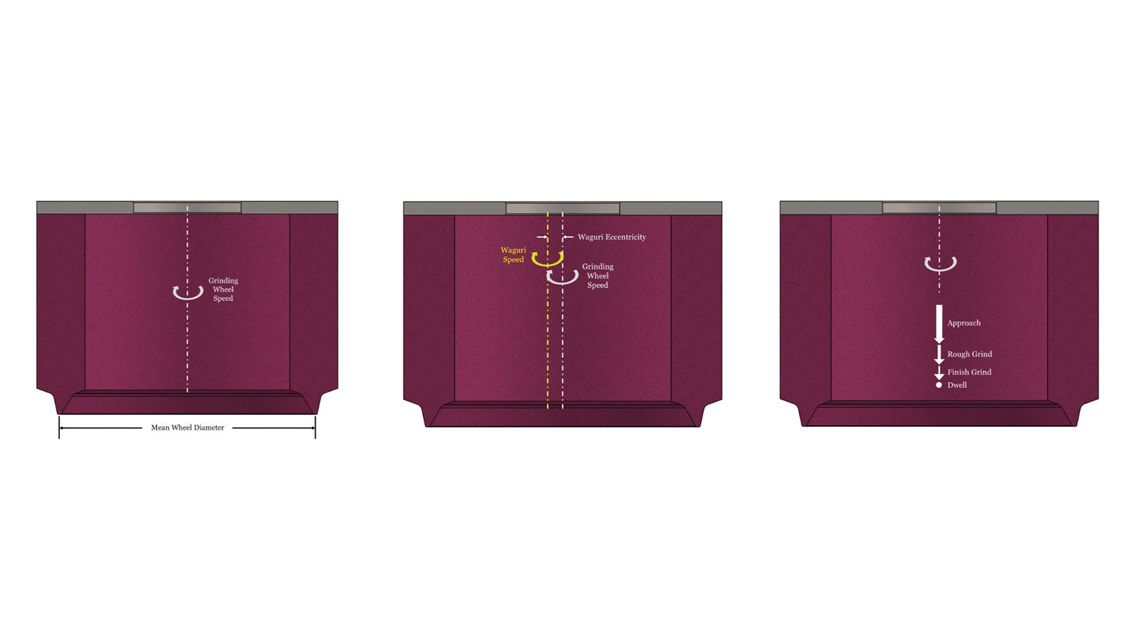

Grinding Wheel Surface Speed
This article appeared in the July 2024 issue.
The peripheral speed of the grinding wheel is programmed using the mean wheel diameter, which is calculated using the center of the profile. Lower grinding wheel speeds will make the wheel act softer and reduce grinding temperatures, but often at the expense of wheel wear and surface finish. Higher grinding wheel speeds will make the wheel act harder and reduce surface finish, but at the risk of increased grinding temperatures. The recommended range for grinding wheel speeds with plunge grinding is 23–25 m/s.
Figure 1—Grinding wheel speed/mean diameter.

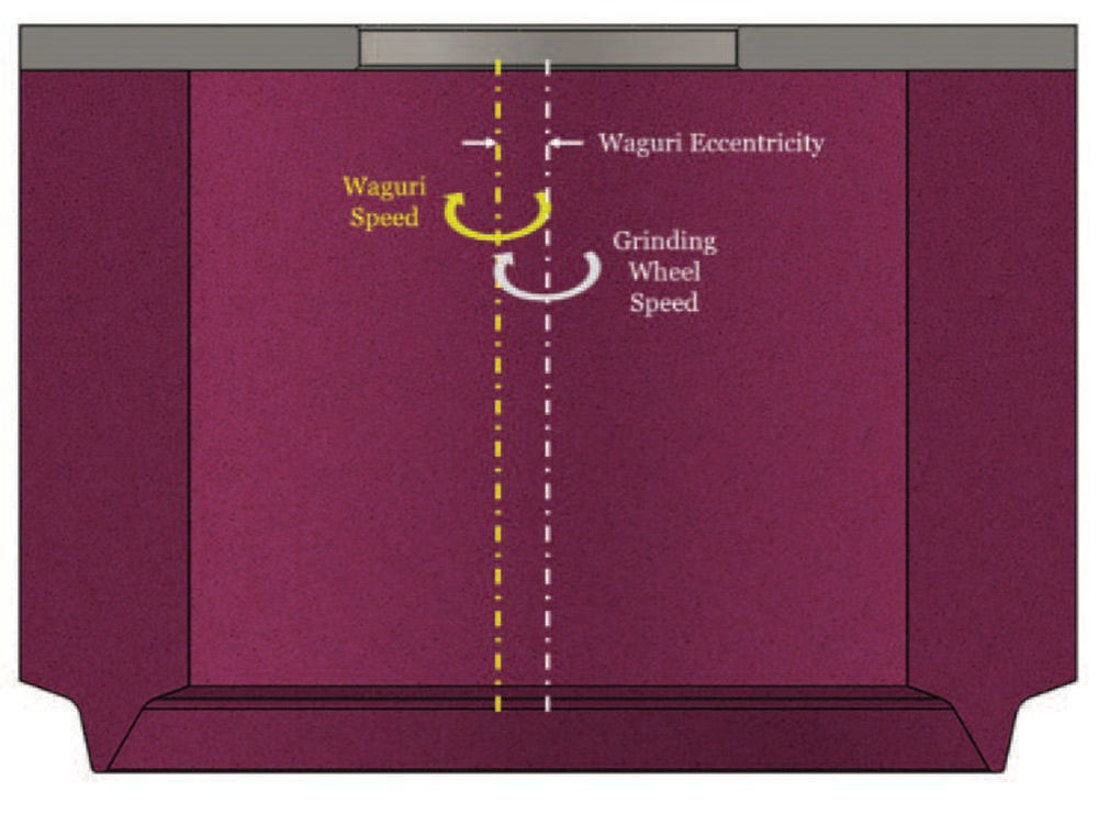

Waguri Spindle Speed
For plunge grinding operations, an eccentric spindle called a Waguri spindle is used. The Waguri spindle rotates the entire grinding wheel spindle by a small eccentric amount, typically 0.05–0.2 mm to create space for coolant to enter the grinding zone. The Waguri speed is typically around 2,000 rpm which is 200–500 rpm less than the grinding wheel speed. The grinding wheel spindle and Waguri spindle always spin in the same direction as one another.
Figure 2—Waguri spindle rotation.

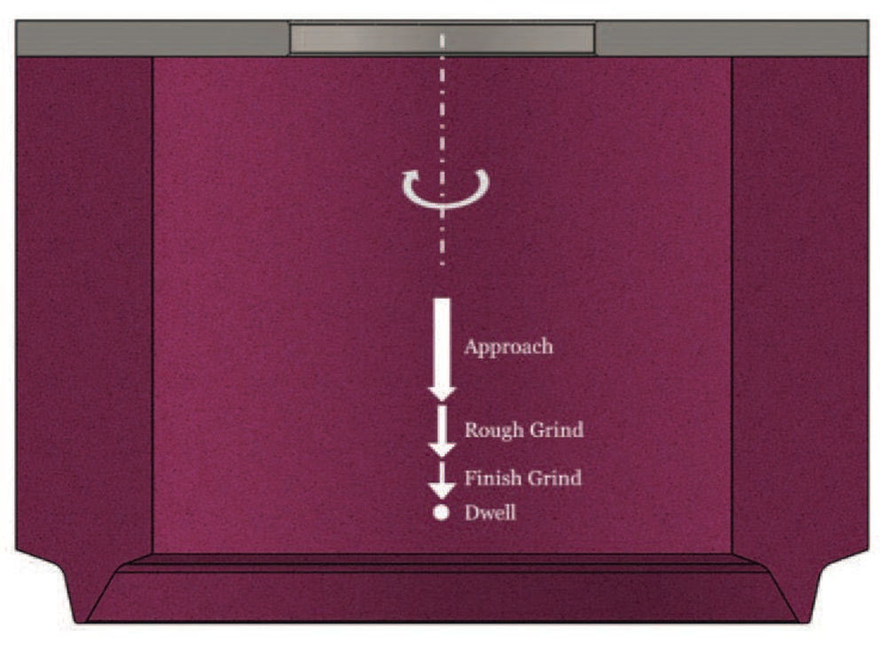

Plunge Feed Rates
Plunge feed rates are programmed in mm/min and use two to three feed rates per grinding cycle. The first feed rate is used for fast positioning, and this value is usually set by the machine manufacturer to minimize cycle time. The second feed rate is for rough grinding, and this value is set based on what is called the specific material removal rate or Q’, which is explained in more detail in Figure 3 and Equation 1. The final feed rate is set based on the required surface finish and gear quality level -- feed rates for this step are typically in the range of 10–40 mm/min.
Figure 3—Example grinding plunge cycle.

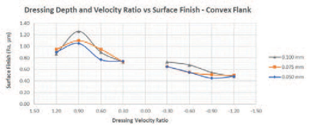

Dressing Velocity Ratio
The dressing velocity ratio (see Equation 4) is the ratio of the dresser surface velocity versus the grinding wheel velocity. Lower velocity ratios will result in lower surface finish and higher grinding forces/temperature, while higher velocity ratios will give higher surface finish and lower grinding forces/temperature. The charts shown below are from an excellent thesis by Nicole Weßels at RWTH Aachen University in 2009, showing the relationship between dressing parameters on surface finish and grinding spindle load.
(4)
qd=dressing velocity ratio
υs=grinding wheel velocity (m/s)
υd=dresser velocity (m/s)
gt0724_Page_34_Image_0002.jpgFigure 14—Dressing depth and velocity ratio vs. surface finish—convex flank (Ref. 2).
Figure 15—Dressing depth and velocity ratio vs. grinding spindle load (Ref. 2).
