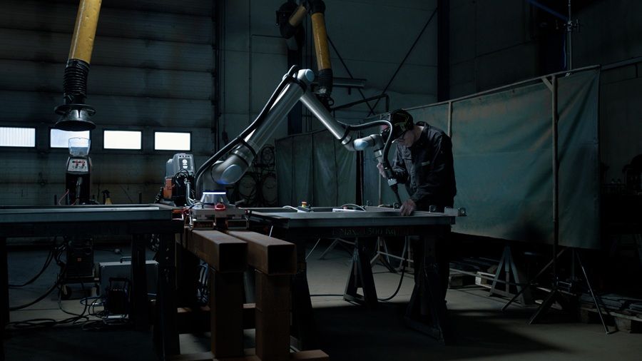

Universal Robots (UR) has introduced a new addition to its portfolio, the UR8 Long. Showcased for the first time at Fabtech in Chicago, the long-reach industrial collaborative robot is designed to tackle the most demanding automation challenges across industries.
With the same 1750 mm (68.9 in) reach as the popular UR20 and a significantly slimmer profile, UR8 Long combines reach, stability and precision in a rugged, compact, lightweight form, featuring an 8 kg (17.6 lbs) payload. This makes it ideal for space-constrained setups and industrial tasks, from complex weldments to precision dunnage picking and flexible multi-point inspections.

Ideal for welding
With its long reach, advanced motion control and stellar precision and repeatability, UR8 Long is ideal for welding. “UR8 Long delivers an easier teaching experience than traditional welding robots, better weld quality than manual welding, and less overall rework, saving time and money,” said Will Healy III, global industry manager for Fabricated Metals at Teradyne Robotics. “Following feedback from fabricators around the world, the UR8 Long was designed with the collaborative welding process in mind, boosting productivity and helping leaders to attract new talent who are often more motivated to operate a robot than perform repetitive manual welding.”
