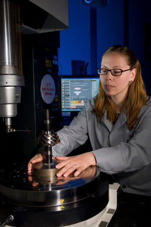

Suzanne Canning measuring a bevel gear artifact on a Leitz PMM.
