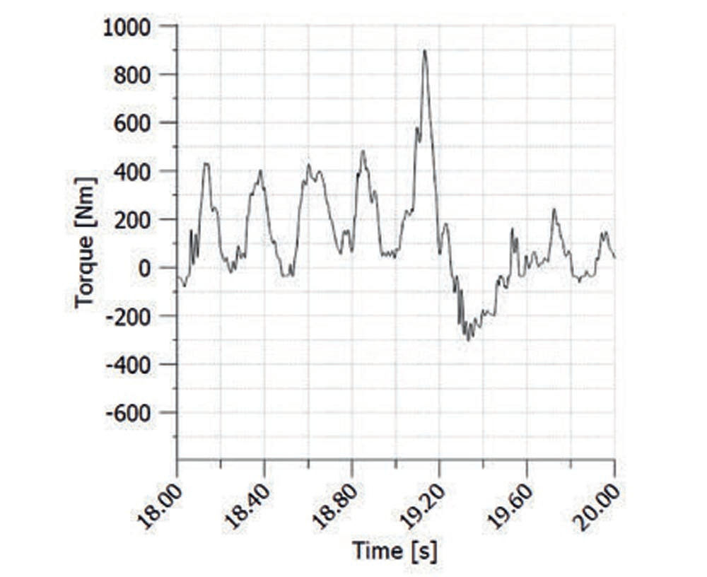

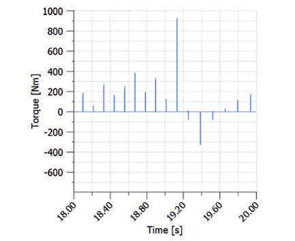

Figure 1—Torque over time in the time series (top). Torque on the tooth of the pinion at angular position 215 degrees (bottom).
Extract of the load on a particular tooth from a time series
The process to generate a load spectrum is complex (Figure 3). As the first step, it must be considered, that a tooth experiences load only once per revolution of the gear. The time series signal must therefore be modified before it can be used for further processing. This is shown in Figure 1.
