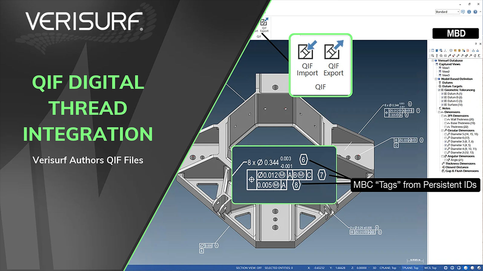

  • Create QIF files from native engineering models. Import supported native computer-aided design (CAD) files containing semantic Product and Manufacturing Information (PMI), then export QIF files while preserving the PMI, engineering-defined inspection characteristics, and their associated Persistent Identifiers (PIDs). Semantic PMI lets software read and use the model’s dimensions, tolerances, and related requirements directly, reducing manual data entry and the risk of transcription errors.
  • Automatically generate inspection plans from QIF. Create the inspection plan directly from supported engineering information in an imported QIF file, including features, dimensions, geometric dimensioning and tolerancing (GD&T), datums, tolerances, and reporting relationships. This reduces manual programming and keeps the plan tied to the engineering requirements.
  • Connect engineering intent to objective evidence. Preserve the original PIDs through inspection planning, measurement, reporting and QIF Results export. Each measured result stays connected to the engineering characteristic being evaluated, giving manufacturers a traceable record of what was measured, how it was evaluated, and whether it met the requirement.
