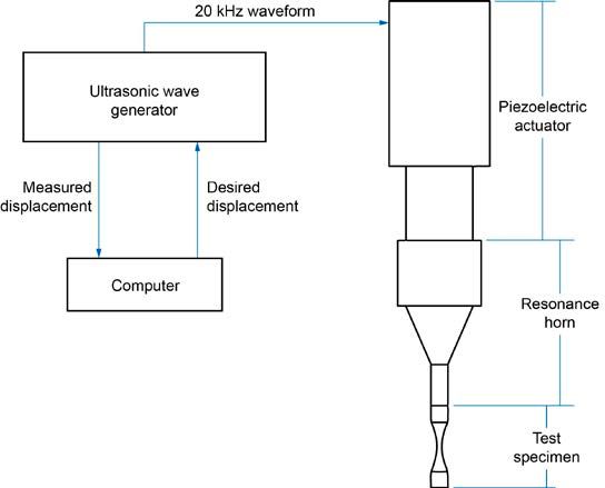

Traditional methods of predicting gear fatigue strength past 107 cycles rely on empirical extrapolation of the 107traditional fatigue strength of the material (Refs. 5 and 6). Extrapolation is used because data for gear steel strength past 107 cycles is rare due to the time and cost of testing to these high cycle counts using traditional fatigue testing methods. Ultrasonic fatigue testing is a material testing method that allows fatigue stress cycles to be generated in a specimen at 20 kHz. Correspondingly this method is practical for creating material fatigue data in the very high cycle fatigue regime (107 to 1010 cycles) (Ref. 1). Ultrasonic fatigue can lead to slightly different material fatigue strength predictions relative to predictions obtained with traditional fatigue test methods due to environmental effects, temperature rise, and the low stressed volume in the specimens (Ref. 7).

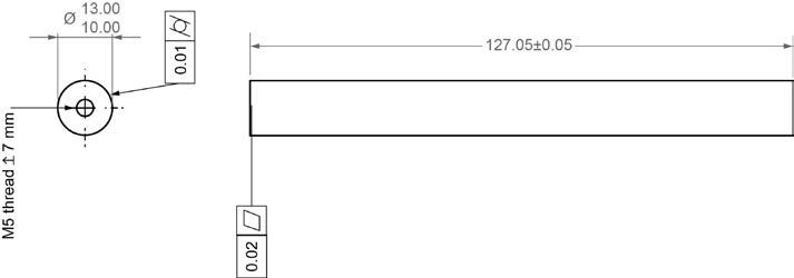

Past work by the author (Ref. 10), showed that using an axial ultrasonic fatigue specimen design as described in Reference 1 led to significant uncertainty of the stress state of the specimen since the ultrasonic horn used to excite the test specimen has an observable displacement noise level of ~0.05 μm. For the specimens in this paper, a new specimen design was carried out with the goal of reducing the uncertainty of the stress state to less than 1 percent. The dynamic modules of test specimens were measured using the method described in Ref. 1. A mean value for the measured material dynamic module based on seven specimens was 201.8 GPa. This measured value was used in all specimen modeling. Appendix A provides the specimen drawing (Figure 4) and specimen test results (Table I) for the dynamic modules of core hardened AMS 6308.

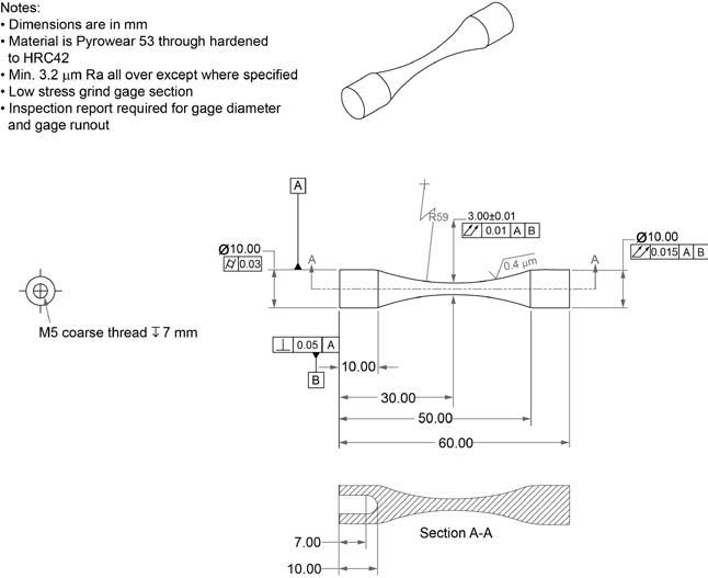

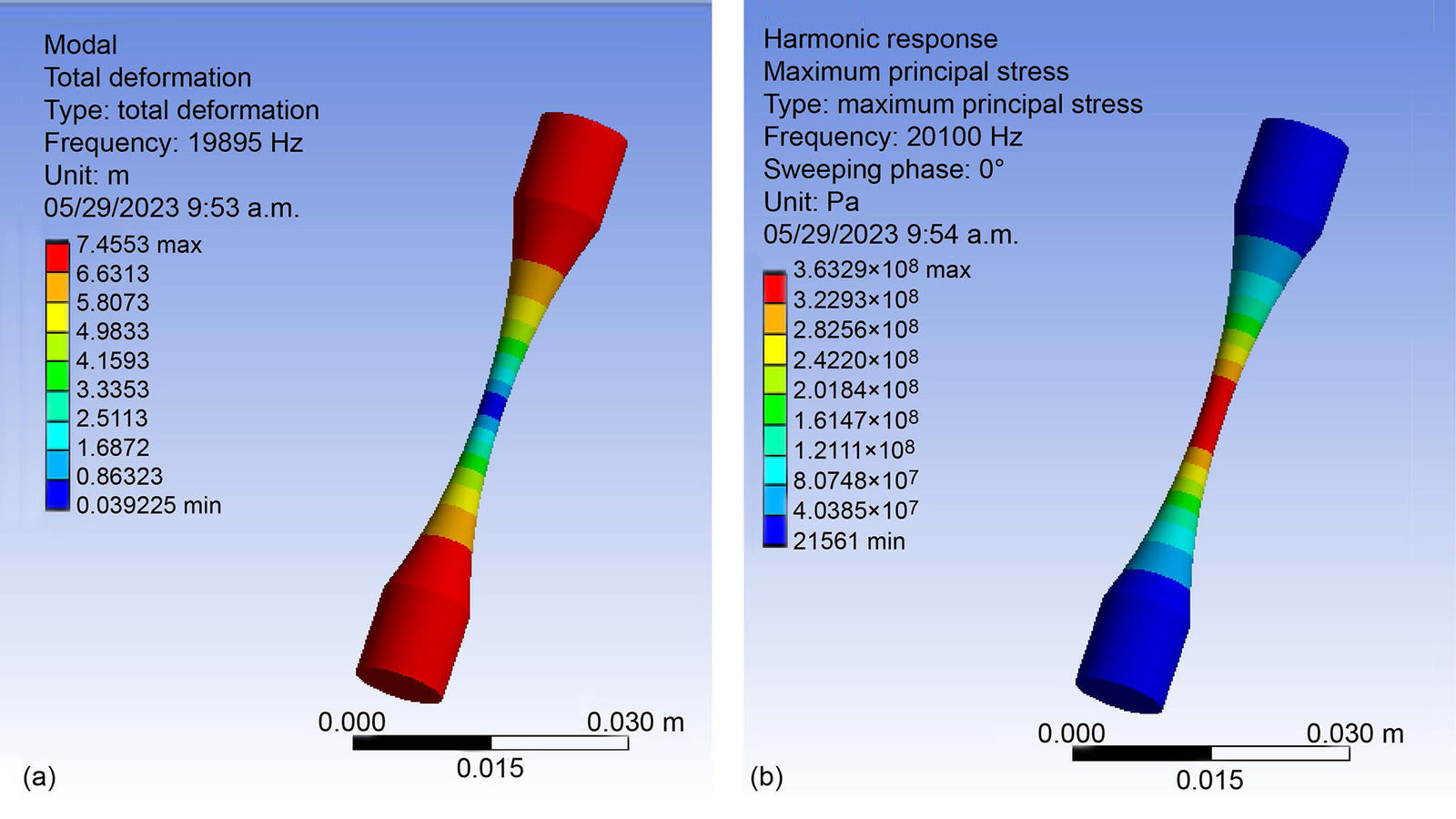

Appendix B provides the drawing for the developed AMS 6308 specimen (Figure 5). Minimum size end sections that are 10 mm long are used to reduce the slope of the stress versus displacement response of the specimen such that a 0.05 μm displacement uncertainty results in a stress uncertainty of ~1 MPa. Finite element analysis was used to achieve the specimen design. Figure 1 shows the FEA model results for specimen mode shape deformation and stress response.

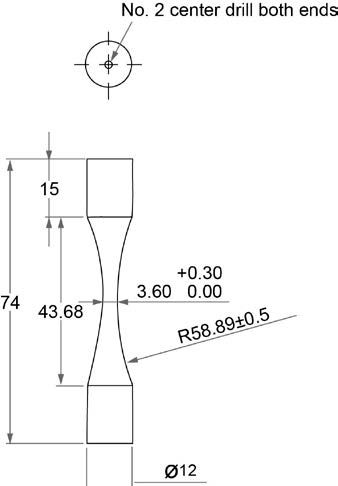

- Premachining per drawing (Figure 6) in Appendix C.

- Final machine the part to length. Appendix B provides final part geometry (Figure 5).
