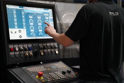

With the new iControl process monitoring system, WFL gives the future machine operator a whole bundle of functions to ensure reliable and economical production, particularly in series production. On the one hand, the machine and tools should be used with maximum productivity; on the other hand, the process should run as stably and reliably as possible. The software package that WFL provides for this is extremely diverse and offers a suitable monitoring tool for practically every processing situation. The up to 16 process signals to be monitored are configured by WFL at the factory according to the machine equipment and displayed live on the control screen. Important process signals include the forces or torques of the NC axes and spindles, but also the signals from integrated sensors (vibration, pressure, flow, temperature, etc.). These are built into machine components or tools and can be used for a wide variety of applications such as process control, optimization or monitoring.
