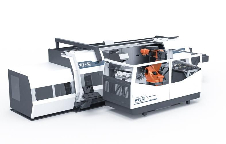

Two new M20-G MILLTURNs will be featured at the event. One of the counter spindle machines is equipped with an innovative automation solution – the intCELL. The turning-boring-milling unit with integrated spindle motor and a B-axis with torque motor is completely new. Another highlight is the individual tool holder with B-axis on the lower slide. The upper and lower system can be used simultaneously. Both systems are supplied from a joint magazine by a reliable, dynamic tool changer.
Visitors to the trade fair will be able to watch a technologically challenging chuck part being machined live on the M20-G. Special gear technology such as gear skiving of internal and external gears as well as complex turning, drilling, and milling operations on the main and counter spindle will be shown. The automatic tool change on both individual tool holders will also be demonstrated.
Using intelligent software in combination with the relevant automation solutions not only enables workpieces to be loaded and unloaded but also means that machining centers can be supplied fully automatically with tools and clamping devices. As an innovative automation partner to WFL, FRAI is presenting its mobile robot system, which responds to this trend, at the event on the M65 MILLTURN.
