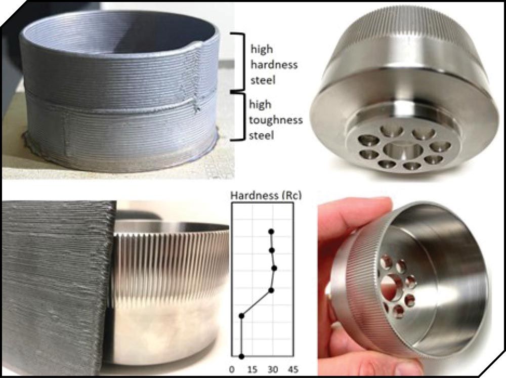

Amorphology Inc. has partnered with Additive Technologies (AddiTec). Together, Amorphology and AddiTec are developing the additive manufacturing of multimetal and functionally graded gear components for robotics.
Building on their previous collaboration of 3D printing large-scale strain wave gear flexsplines using directed energy deposition (DED), the partnership between Amorphology and AddiTec has now turned to the development of multimetal and functionally-graded gear components, combining two different steels together within a single part. Similarly, you can use other alloys such as titanium.
The three-inch diameter flexspline demonstrator is part of a zero-backlash strain wave gearbox used in robotic arms and precision-motion mechanisms. The thin-walled flexspline has competing requirements of wear resistance in the teeth and a fatigue-resistant body that motivates the use of two different materials during 3D printing. The steel in the toothed region is a precipitation hardening martensitic stainless steel typically used in high-strength applications with an average hardness of 35 Rc. In contrast, the steel below the toothed region is known for high toughness with a lower average hardness. By combining the two steels strategically in a gear, it becomes possible to tailor the mechanical properties to take advantage of the benefits of each alloy.
Through its exclusive licensing agreement, Amorphology is developing its intellectual property around multimetal 3D printing, specifically functionally graded metals, which allows for the strategic transition between more than one metal during 3D printing to produce multifunctional parts that are free from cracks and unwanted phases. The core technology, developed over a decade ago at JPL, focuses on the design of multimetal transitions to achieve predictable mechanical or physical properties in the printed part. Unlike conventional claddings or overlays, functional grading aims to achieve the best possible properties at the interface between dissimilar metals or composites in a 3D printed part, which is useful for preventing failures such as those caused by thermal mismatch or fatigue cracks. Tailoring the interface between different metals during printing can be achieved through diffusion at the interface by allowing the disparate metals to mix or by adding one or more intermediate compositions at the transition. The prototype developed in the current partnership was produced through wire-fed DED by printing the base of the gear from high-toughness steel and then sharply transitioning to the high hardness steel at the vertical location where the teeth begin, using the melt pool to diffuse the layers. The materials could have also been transitioned by mixing powders of the two materials in the powder-blown configuration of the DED printer.
“Functional grading with multiple materials allows us to develop gear components for robotics that cannot be fabricated with conventional metallurgy. The ability to tailor the properties of a gear via alloy composition gives us an entirely new design freedom when developing precision mechanisms,” said Dr. Glenn Garrett, Amorphology CTO. “Whether it's improving the wear resistance of gear teeth while maintaining toughness in the rest of the part or using high-value steel in combination with low-cost steel to save cost, additive manufacturing is allowing us to innovate in the way that we approach gears for robotics. We can tailor properties for machinability, cost, hardness, strength, corrosion resistance, even density. For large gears where it makes sense to use additive manufacturing to save machining costs, this could be a real advantage.”
“Meltio's dual-wire DED technology provides an ability to change from one material to another material automatically during the fabrication of metal components. This results in gradual change in properties and functions which can be tailored for enhanced performance,” said Dr. Yash Bandari, business development manager at AddiTec.
The multimetal flexspline demonstrator from Amorphology and Additec is designed so that the high-performance high-hardness steel resides in the gear teeth and the rest of the cup is made from highly machinable tough steel. The as-printed hardness of the gear teeth through DED was measured to be around 30 Rc while the base of the cup measured at around 7 Rc (87 Rb). A further increase of the gear teeth hardness is possible through subsequent heat treatment. Future work will focus on different combinations of steels, and the development of localized heat-treating strategies to optimize the properties of each metal in the bimetallic gear. Amorphology is actively developing other applications for functionally graded metals in applications such as thrusters, rockets, robotics, and gears, and is seeking partners for further development and licensing.

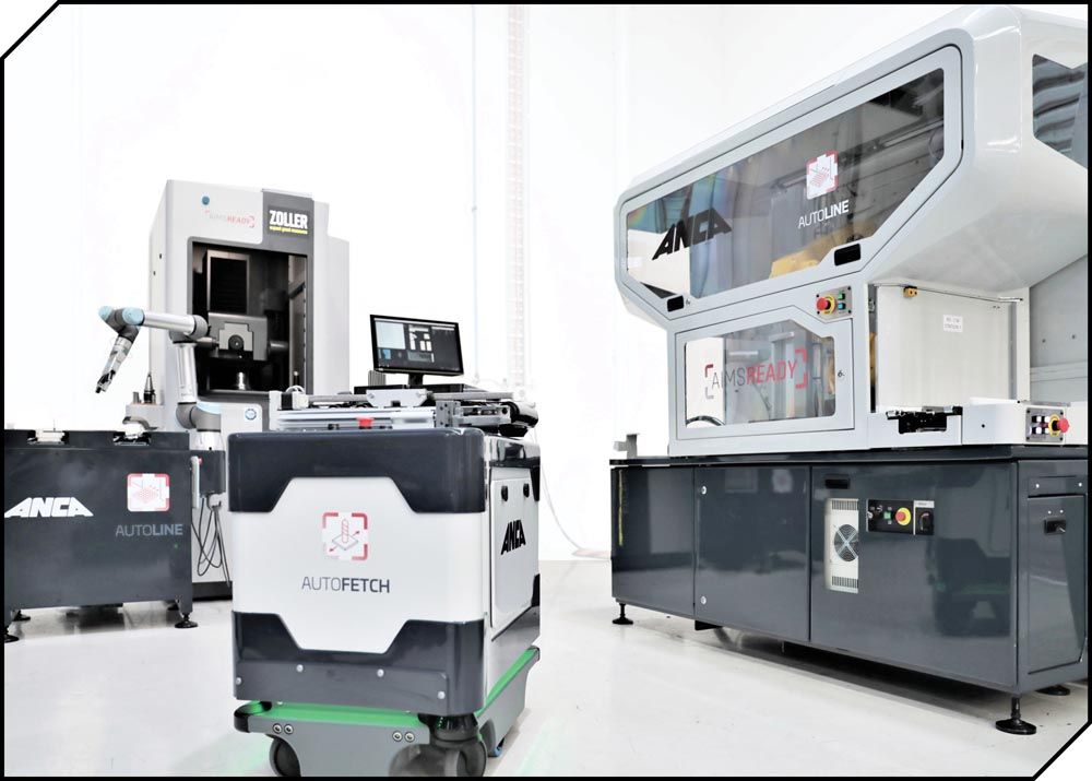

The ANCA Integrated Manufacturing System (AIMS) optimizes cutting tool production through streamlined manufacturing, automation, and connectivity. With ANCA and AIMS, customers can achieve continuous, unattended production that dramatically reduces non-productive machine time, with smart automation that connects sequential tool production processes and offers connectivity across the whole factory.
This is Industry 4.0—factory-wide integration. The technology considers a factory as a single machine, rather than separating it into many different process elements. This concept brings together one ecosystem and builds it to be as efficient as possible. AIMS, being a modular solution, can be deployed in stages, allowing for easy, gradual, and smooth transition from traditional to automated and integrated manufacturing.
A fully operational manufacturing cell will be displayed at IMTS, demonstrating a fully automatic process of tool manufacturing, from blanks to ground tools. Included will be ANCA’s latest premium machine MX7 ULTRA capable of manufacturing high quality cutting tools, along with an AutoSet job preparation station, AutoLine for pallet and tool transfer as well as AutoFetch—a robot responsible for material transfer between processes—pallet and individual tools between job preparation, grinding and tool measurement on Zoller measuring machine.
Jan Irzyk, AIMS product manager said: “AIMS can be configured in many ways but at IMTS visitors can see an unattended manufacturing workflow of two varieties of endmills on one MX7 machine. An important part of this workflow is closed loop measurement and compensation process using Zoller Genius as a measurement station. Depending on an individual customer’s requirements, our system can automatically transfer a tool from the ground batch, clean it, measure required geometries and transfer the results to the respective grinder where grinding parameters compensation is taking place to achieve required dimensional tolerance of the batch.”
