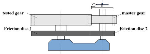

The transmission error (TE) of gear is a fundamental concept in the field of gear transmission engineering. It is utilized in guiding high-performance gear design, characterizing gear quality, analyzing gear process errors and predicting dynamic properties of gears (such as vibration and noise). The definition of TE is relatively simple, yet it encompasses a wealth of implications. Understanding the role of TE is essential; however, more importantly, recognizing its limitations is crucial (Ref. 1). Unfortunately, there has been insufficient research on the shortcomings of TE to date. As a result, when applying the concept of TE, its limitations and deficiencies are often overlooked, leading to conclusions that warrant further discussion.
In the study of TE, there is a widespread belief in the current literature that research on TE began in the 1950s. In 1958, Harris (Ref. 2) introduced the concept of gear TE while studying gear vibration and noise. His work also laid the theoretical foundation for modern TE research. Undoubtedly, Harris’s contributions to TE research are significant, but the above statement requires further investigation. Upon examining the history of gear technology, it becomes clear that there have always been two forces driving TE research: one group consists of researchers engaged in gear quality control and measurement technology, and the other comprises those involved in gear design and dynamics. As early as the 1930s, to control the quality of gear transmission, researchers obtained the single flank composite error, i.e., TE, of a pair of gears through comparative measurement with standard discs, as shown in Figure 1. This achievement then enabled the control of gear transmission accuracy, and the study of TE originated from this very effort (Ref. 3).
Figure 1—The origin of gear single flank testing.
In 1963, Harris introduced the Harris graph, a graphical representation of the relationship between quasi-static load and TE for modified gears (Ref. 4). This graph aimed to provide a theoretical prediction of load-bearing deformation. During the 1960s, R.G. Munro (Ref. 5) developed an optical-grating instrument for single flank testing, which became the first apparatus to utilize a grating technology for TE measurement. This breakthrough marked a significant advancement in the potential for high-precision dynamic measurement of TE. In 1970, Huang Tongnian from China first proposed the concept of Gear Integrated Error (GIE) and developed the measurement technology for GIE (Refs. 6–8). This technology utilizes a specific multi-start worm to implement single-flank testing, as shown in Figure 2. This innovation represented a significant advancement in TE measurement technology and effectively addressed the limitations associated with TE measurement. Concurrently, in the 1980s, the pursuit of smooth gear transmission led Litvin et al. (Ref. 9) to incorporate TE as an objective function in gear design. This approach sparked new developments in the field of gear design.

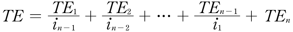

A gear transmission chain refers to a system consisting of multiple gear pairs. In such a chain, TE is defined as the difference between the actual position of the output end gear and its theoretical position based on the input end gear. The mathematical expression for TE of a gear transmission chain is provided in Equation 2 (Refs. 17–19). Among them, TEn is the TE of the nth level transmission, and in-1 is the total transmission ratio of the transmission chain of n pairs of gears.
(2)

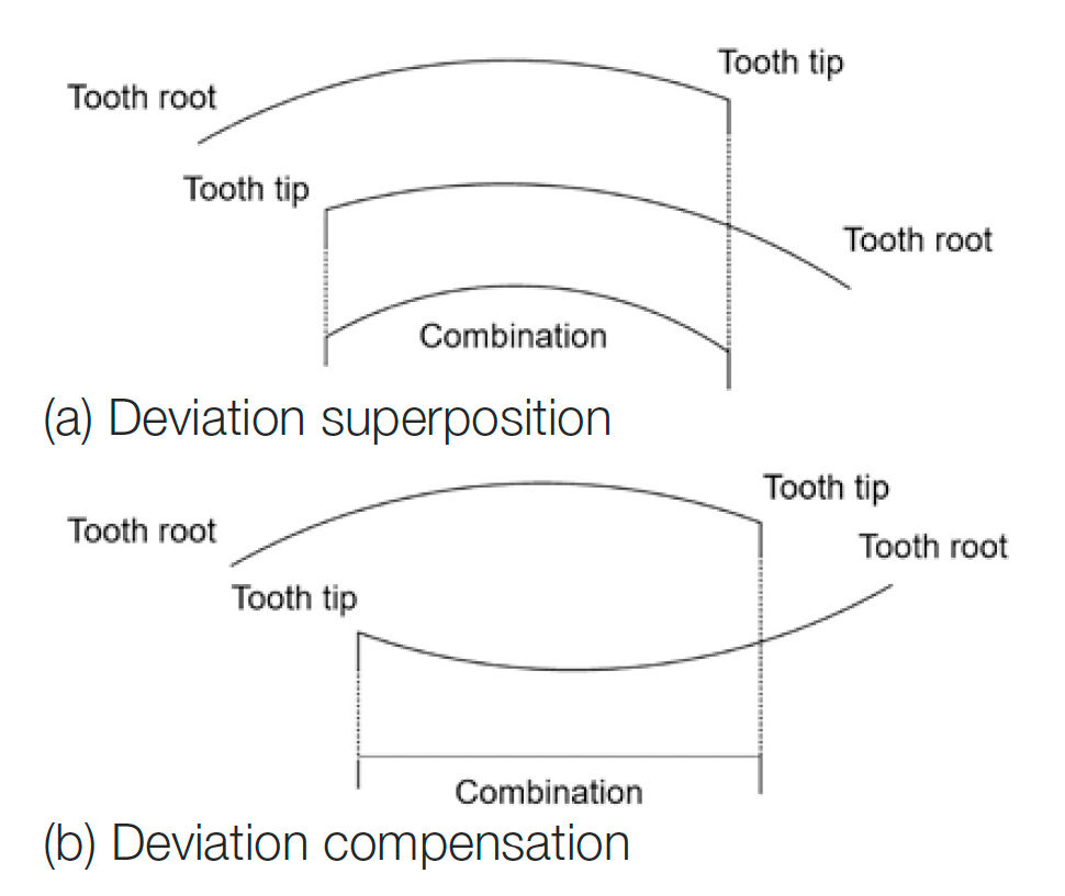

The Relationship Between TE and Gear Elemental Deviations
Gears exist in pairs, and TE is a comprehensive representation of the elemental deviations of both the driving and driven gears. However, it is not possible to derive the elemental deviations of the driving and driven gears from the TE of a gear pair. Figure 4 reflects the combination of tooth profile deviations (Ref. 16). In 1969, R.G. Munro (Ref. 20) conducted theoretical and experimental research on single-flank and double-flank testing of gears. Munro also provided composite error curves for single and double testing that correspond to the combination of various tooth profile deviation shapes of involute gears.
Figure 4—Profile deviations combination.

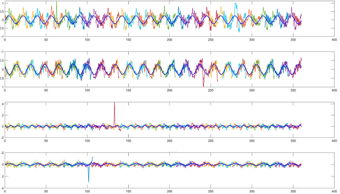

It is difficult to separate the elemental deviations of gears from the TE curve alone, which means it is impossible to analyze the main factors affecting gear transmission or to clarify the process of TE generation. The GIE measurement technique proposed by Huang Tongnian has solved the above problems. A typical GIE curve is shown in Figure 5, where the TE curve is the outer envelope of the GIE curve. By examining the GIE curve, one can clearly observe the change-over process from 2-pair-teeth contact to 1-pair-teeth contact, distinguish between the 1-pair-teeth contact zone and 2-pair-teeth contact zone, and isolate the elemental deviations, which cannot be achieved through the TE curve alone.
Figure 5—Comparison between GIE and TE.

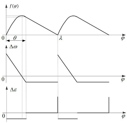

Dynamic TE (DTE)

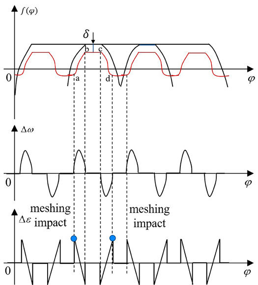

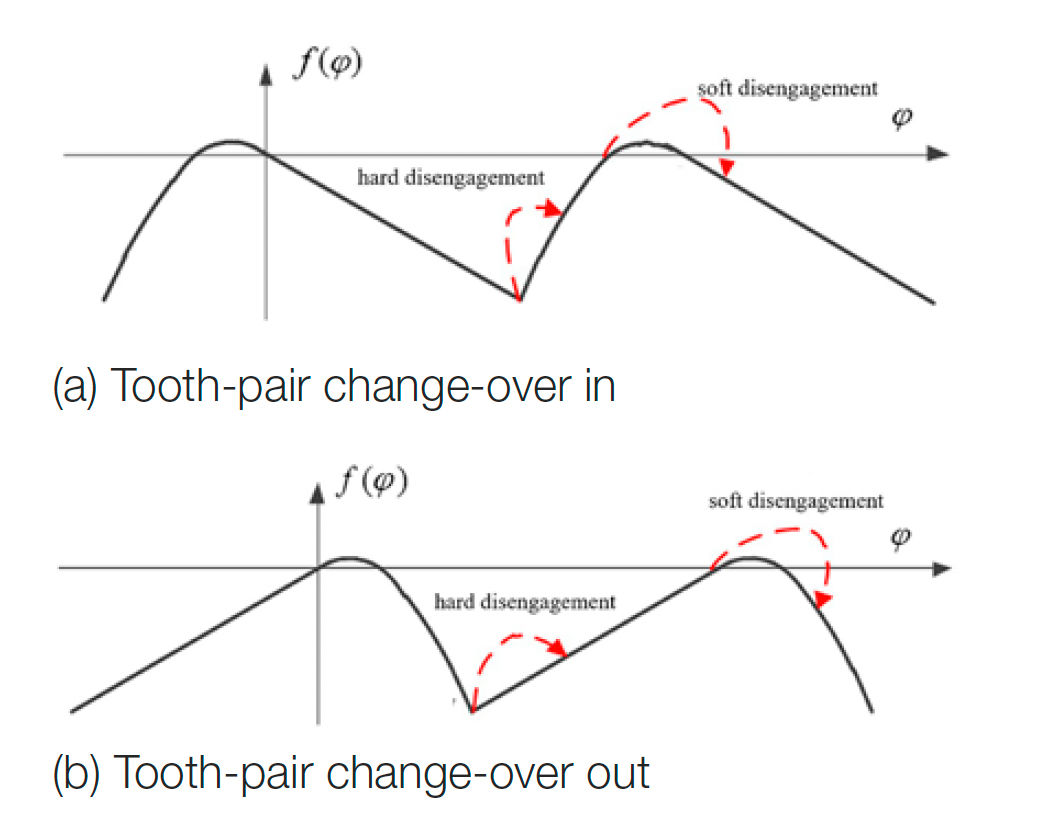

QSTE is measured at low speeds and under load, without considering the impact of acceleration and deceleration on TE during high-speed operation of gears. As the rotational speed increases, the transmission error caused by acceleration and deceleration becomes more apparent and may even lead to the tooth-pair disengagement of the driving and driven gears, resulting in a clash due to disengagement.
Disengagement is divided into hard and soft disengagement. Hard disengagement refers to the situation where the driven gear is suddenly accelerated during tooth shifting, causing the tooth profiles of the driving and driven gears to disengage. Soft disengagement occurs when the driven gear attempts to maintain its original speed due to inertia during deceleration, leading to the disengagement of the tooth profiles. Hard disengagement generally occurs at the point of tooth alternation, while soft disengagement typically occurs during deceleration. As shown in Figure 6, the solid line represents the TE curve, and the dashed line represents the TE curve after disengagement. Soft disengagement is generally easier to occur, while hard disengagement can only happen under certain conditions. Typically, as the gear rotation speed increases, the likelihood of disengagement also increases. As the load increases, the likelihood of disengagement decreases. Due to the impact of disengagement, the continuity of gear transmission is lost.
Figure 6—Detachment impact (Ref. 21).
DTE takes into account the combined effects of geometric error, kinematic error, and dynamic error. It is essential to measure DTE at high speeds in order to obtain a comprehensive understanding of the transmission system’s behavior. It can be represented by formula (5), where η represents gear kinematic error.

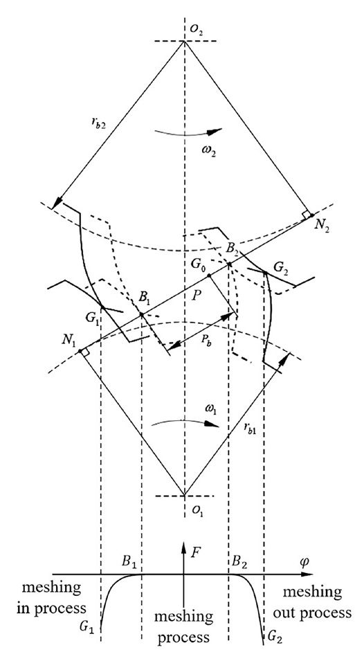

Gear transmission operates by utilizing the interaction between the teeth of the driving gear and the teeth of the driven gear. This process entails the sequential engagement of the conjugate tooth surfaces. Figure 7 illustrates the meshing process of involute cylindrical gears, where two involute gears (labeled as o1 and o2) rotate around their respective fixed axes. o1 represents the driving gear and o2 represents the driven gear, and the base circle radii are rb1 and rb2, respectively. P is the pitch point. As gear o1 drives gear o2, the path of moving of contact point of the conjugate tooth surfaces is the line of action B1 – B2. The driving gear transfers motion and force to the driven gear by their interaction, along the direction of the line of action (Refs. 22–23).
Figure 7—The meshing process of involute gears.
During the transmission cycle of a pair of teeth, the contact point starts from the point G1, and the meshing sequence is G1B1, , and B2G2. The G1B1 segment represents the entry stage, which is the edge contact section of the driven gear, where the contact point moves from the tooth mid to the tooth root on the tooth surface of the driving gear. The B2G2 segment is the exit stage, which is the edge contact section of the driving gear, with the contact point moving from the tooth root to the tooth mid on the driven gear’s tooth surface. For involute spur gears, the GIE curve during the edge contact segment is parabolic. The segment illustrates the normal involute contact process, corresponding to the middle smooth section on the GIE curve, where the contact point moves from the tooth root along the involute to the tooth tip on the driving gear’s tooth surface, and from the tooth tip along the involute to the tooth root on the driven gear’s tooth surface.

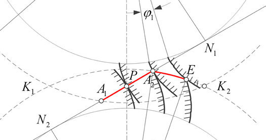

Figure 8 illustrates the meshing phase of a pair of gears. The driving gear is perfect, while the driven gear exhibits a positive base pitch deviation Δfpb, with the driving gear rotating at a constant speed. In this case, the driving and driven gears cannot directly enter the involute meshing segment, resulting in the meshing process EA2 shown in Figure 8. In the EA2 segment, the contact point first appears at point E, and then moves from point E to point A2 on the tooth surface of the driving gear. Starting from point A2, it enters the involute contact section, where the contact point gradually moves from the tooth root to the tooth top on the driving gear tooth surface.
As depicted in Figure 8, for the driving gear, the radius of point E exceeds the radius of point A2. This procedure signifies a transition from the tooth apex to the tooth root direction, constituting the meshing process of the upper edge of the driven gear.
Figure 8—Gear meshing process with positive base pitch deviation.

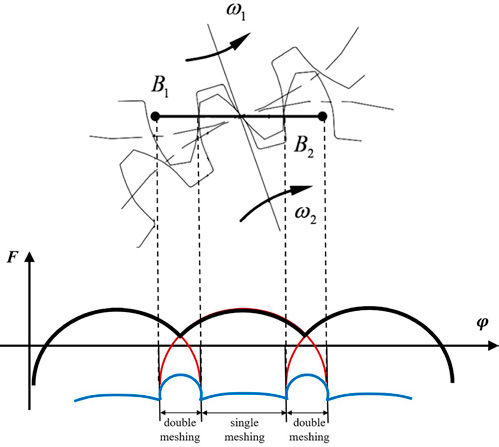

Gear Pair Under Load

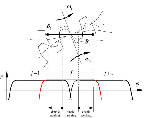

Figure 10 displays the GIE curve of a perfect gear pair. During light load transmission, there is no error, as indicated by the non-fluctuating portion of the TE curve in the figure. However, when the gear pair bears the load, the teeth of the gears bend, causing the TE curve to sink as a whole. This leads to the driving gear moving backward and the driven gear moving forward, as depicted by the red curve in the figure.
Under the action of load, the dynamic performance of a perfect gear pair deteriorates. On one hand, the driven gear tooth tip enters into contact with the driving gear tooth root ahead of time in the meshing process, causing meshing-in impact; on the other hand, after the ideal meshing is interrupted, the driving gear tooth tip still contacts the driven gear tooth root, causing meshing-out impact when they separate. Due to the meshing in and out impacts, the gear speed loses continuity and fluctuates, resulting in degraded performance of the ideal gear.
Figure 10—TE curve of a perfect gear pair under load.

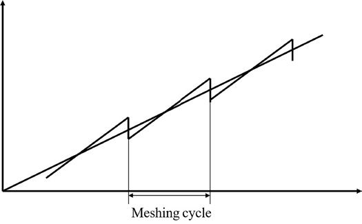

In gear design, TE curves are commonly employed as a reference for design guidance, particularly in the modification and utilization of high-order polynomial functions of transmission error (H-TE) (Refs. 24–27). The concept of H-TE was originally developed for spiral bevel gears, where the transmission function ideally exhibits linearity. However, due to assembly errors, the transmission function becomes piecewise linear, resulting in a larger amplitude of geometric transmission error at the tooth pair transition point. This adversely affects the dynamic performance of the gear and can lead to meshing apart in severe cases, as depicted in Figure 14.
Figure 14—Piecewise linear function of TE.

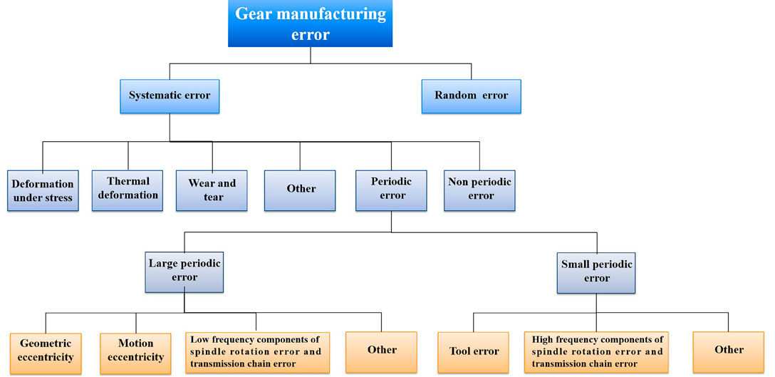

Process Error Analysis
Gear machining errors can stem from various factors (Refs. 28–30), and based on their manifestation, they can be classified as follows, as illustrated in Figure 16.
Figure 16—Gear machining errors and their causes.

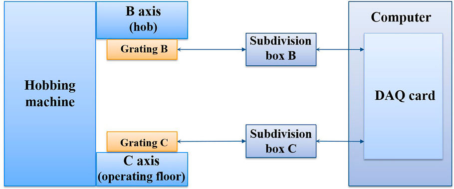

Figure 20 demonstrates the measurement principle for TE within the hob machine tool’s transmission chain. Both the hob shaft and the end of the workbench are fitted with circular gratings B and C, respectively. As the workbench and hob shaft rotate, the two circular gratings produce sinusoidal signals. An interpolator, also known as a subdivision box, processes and subdivides these two signals. The digital signal acquisition card then detects the falling edge of the two signals. Subsequently, a calculation program reads the count values and computes the rotation angles of both the hob shaft and the workbench. This ultimately allows for the determination of the transmission chain’s TE. Beyond just machine tools, accurate TE measurement is also imperative for precision transmission machinery like observatories, radars, weapon systems, and printing machinery. This is necessary to ensure the transmission chain’s quality and precision. Once the TE of the transmission chain is obtained, it becomes necessary to trace and compensate for any identified error.
Figure 20—Measurement principle of TE for transmission chain of hobbing machine tools.

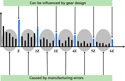

With the advancing electrification of the automotive industry, electric vehicles demand higher standards for noise, vibration, and harshness (NVH) in their transmission systems. In traditional internal combustion engine vehicles, the engine noise eclipses that of the gearbox, thereby reducing the need for stringent control of gearbox noise. However, in electric vehicles, the gearbox becomes the primary source of noise. This noise becomes even more critical as motor speeds in newer electric vehicles reach or exceed 30,000 rpm, necessitating effective control over gearbox noise and setting standards for individual gear noise levels.
TE stands as a crucial metric for quantifying gear noise levels. By charting the TE curve of a singular gear and carrying out order analysis, the noise level of the gear can be assessed (Refs. 35–36). Gear transmission noise originates from two key sources: firstly, the noise generated by impacts during the alternate meshing transmission of crossing teeth, which predominantly contributes to high gear noise, and secondly, resonances caused by gear rotation due to eccentricities and other long-term errors. An inspection of the TE curve alone does not allow for the identification of the single and double meshing zones. Therefore, when employing the TE curve to predict gear transmission noise, only resonance-generated noise can be analyzed, while impact noise remains unpredictable.
Currently, the state-of-the-art technique for predicting gear noise both domestically and globally involves assessing gear noise levels by analyzing gear surface waviness, which fundamentally employs TE (Refs. 37–38). The red curve in Figure 21 is derived by aligning the tooth profile deviation of each tooth on the gear with the rotation angle and tooth pitch. The blue line is produced by the gear’s radial runout, and the ripples on the tooth surface are clearly visible in the figure. This ripple is precisely what gives rise to the gear’s noise characteristics. An order analysis and separation are then performed on the curve shown in Figure 21.
Figure 21—TE from profile deviations and Fourier analysis.
