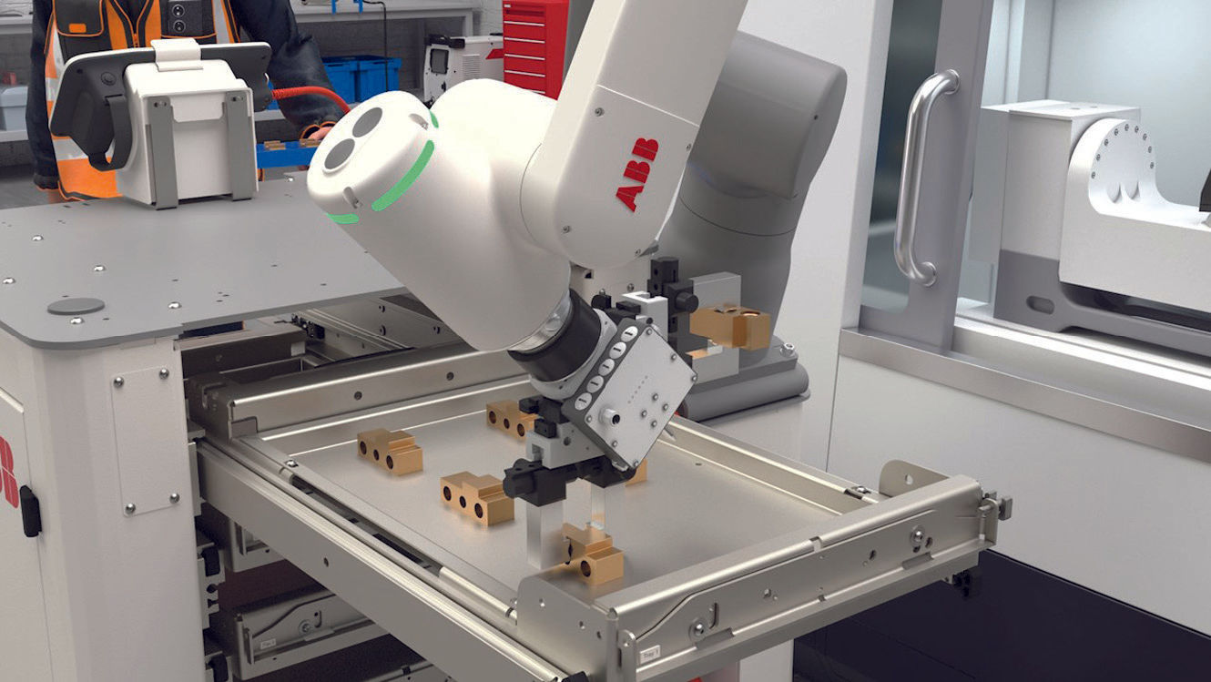

Andie Zhang, global collaborative robot product manager, ABB Robotics, believes a good first step would be to identify repetitive, labor-intensive, or precision-critical tasks that a robot could improve and ensure that it is feasible for the robot to integrate with conveyors and processing equipment.
“Another key step would be to determine whether a collaborative robot or a traditional 6-axis robot are more feasible for the application to be automated. Cobots are ideally suited for applications that require an operator to frequently interact with the robot—like in the case of high mix, low volume production runs,” Zhang said.
The reduced time it takes for an operator to enter the collaborative robot cell, whether behind a fence or not, makes changeovers far quicker and less disruptive. Also, for tasks that require a lot of path programming, a cobot solution can be a good fit due to simplified programming methods.
Though cobot reach and payload capacities have grown and are expected to continue to, there are still limiting factors that would eliminate a cobot from consideration.
“Traditional industrial robots are better suited for very complex operations or processes requiring high speeds to achieve the necessary throughput and handling heavy objects,” Zhang added.

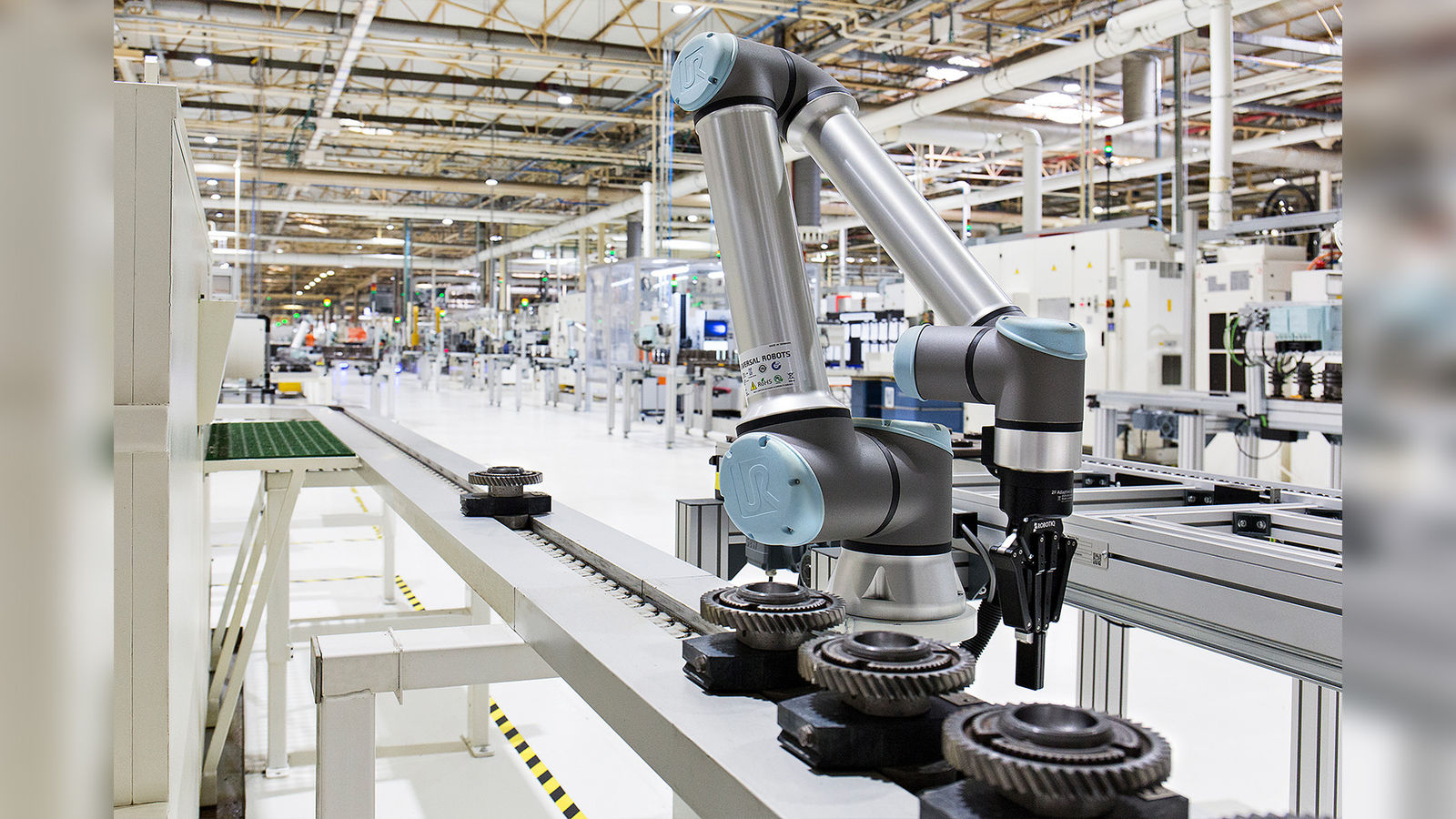

In gear manufacturing, cobots can be implemented most effectively by focusing on tasks that benefit from consistency and precision. Machine tending is a prime example, according to Savoia.
“They excel at loading and unloading CNC machines, allowing for continuous operation and freeing up workers for more complex tasks. Quality inspection is another area where cobots shine. Equipped with vision systems, they can perform consistent, tireless inspections, ensuring high quality standards. Packaging and palletizing are also great applications for cobots in gear shops. They can handle the repetitive work of preparing finished products for shipping, reducing strain on human workers. Assembly operations, particularly for smaller gears or components, can also be effectively automated,” he said.
The key is to identify tasks that are repetitive while allowing your skilled workers to focus on more complex, value-added activities that require human expertise and decision-making.
ABB focuses on cobot solutions providing quick installation and operational efficiency.

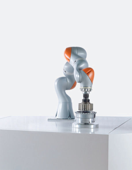

With its integrated torque sensors, the KUKA LBR iiwa enables the automation of delicate assembly tasks for force-controlled joining operations and process monitoring.

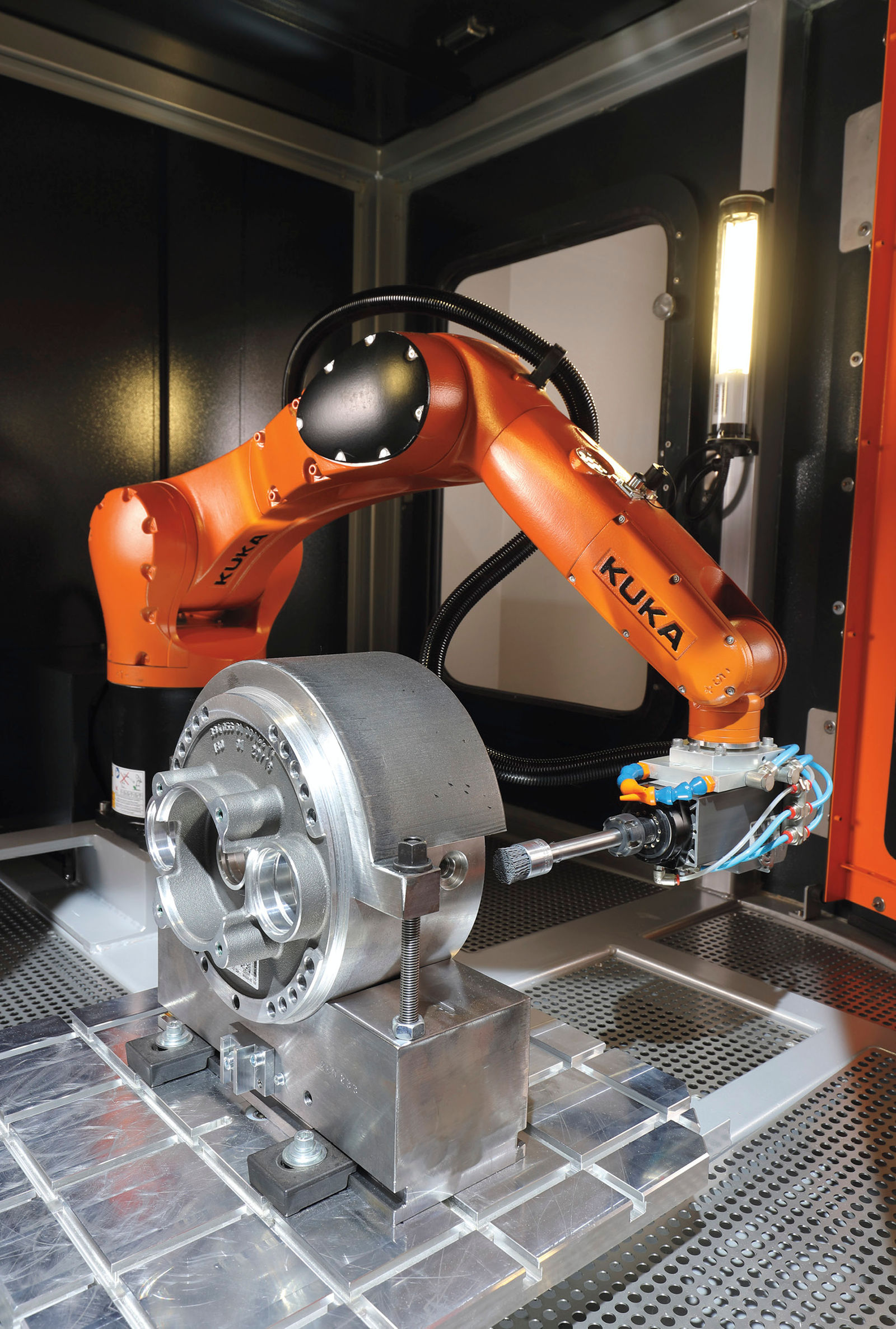

The KUKA KR Agilus is used to deburr a gear housing.
“The introduction of block programming, rather than writing code textually, is a very big part of what makes cobots useful to shops. Advances in force control technology have made them even more deployable, but perceptions have also changed. Initially, people would not accept a robot being able to operate without a fence, but now attitudes have changed 100 percent on that,” Ryan said.
