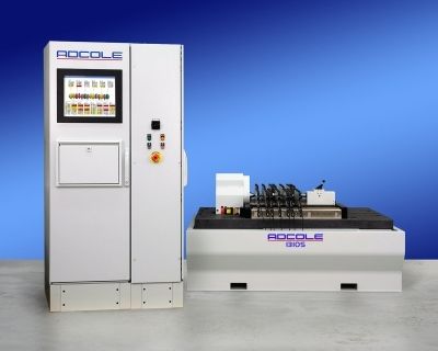

Adcole Corporation recently introduced a new high-speed, fully automated end-of-line camshaft measuring machine that features sub-micron accuracy and sub 25 second cycle times.
The Adcole Model 1310S Inline Camshaft Gage can measure up to 28 features including lobes, journals, chatter, and timing references with sub-micron accuracy and repeatability. Designed to be gantry or robot fed for 100% end-of-line inspection, this high-speed gage is fully automated to maintain the production machining process for up to 200 parts per hour in real-time.
Incorporating proprietary follower modules capable of 3,600 data points per revolution per follower, the Adcole Model 1310S Inline Camshaft Gage has an adjustable tailstock and headstock which engages all follower modules simultaneously. To assure high reliability, there are minimal moving mechanisms and the menu-driven software provides instant data collection.
