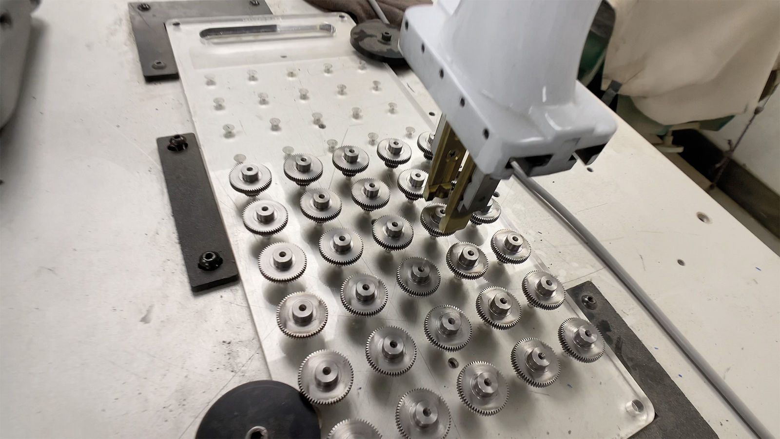

An OB7 cobot picks from a loaded tray of spur gears at Productive Robotics’ Santa Barbara factory. Each tray holds 30 to 50 parts, depending on size; the robot’s grid function interpolates every pickup position from four taught corner points. (All images: Productive Robotics)

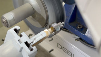

Having the robot hardware was a starting point, not a solution. Getting to a reliable automated deburring process took about four years of tweaking gripper tooling, part fixturing, media selection, wheel placement, and table layout. The nitroloy at 28 Rockwell called for a specific abrasive: a 320-grit Scotch-Brite embedded nylon wheel, available from several manufacturers. Kirby’s team now specs that media for customers running similar jobs.
A cluster gear contacts the 320-grit Scotch-Brite embedded nylon wheel.

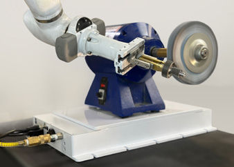

The key development was a pneumatically controlled deburring platform. Early attempts ran parts directly against a stationary wheel, but as the abrasive wore down, contact pressure dropped, and results drifted. The platform fixes that with adjustable air pressure and an offset dial—the part meets the wheel with a uniform force regardless of wear.
The pneumatically controlled deburring platform sits beneath the blue motor housing.
“We developed our deburring platform,” said Kevin Meister, the company’s application specialist. “It uses air pressure to make sure that the part’s constantly hitting with the same amount of force.” Meister has helped over 100 companies automate processes ranging from welding to finishing.

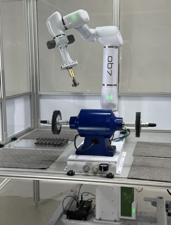

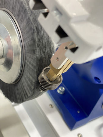

Two wheels sit on either side of the work area. The robot presents one side of the gear’s flanks to the first wheel, moves to the second for the opposite side, and works through the ODs, tooth flanks, tooth ends, gear faces, and bearing journals in one cycle. On the 0.3-module and 0.4-module, 20-degree spur gears demonstrated in the webinar, the process holds an edge radius of about 0.002 to 0.003 inches across tooth tips and flank edges.
A cluster gear at the second Scotch-Brite wheel.

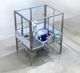

Open Cell and Enclosed Cell
Productive Robotics offers the system in two configurations. The open-cell version puts the robot, deburring platform, and part trays on Productive Robotics’ extra-large machine table. Operators load their existing shop trays—the system was designed around standard fixturing rather than custom holders—and the robot works through the tray while the operator does something else. Kirby said operators typically check back every half hour or so, inspect the last finished part, and adjust the offset if the wheel has worn slightly before reloading.
Inside the enclosed cell, the OB7 holds a part between dual deburring wheels. The offset and pressure adjustment dials are visible on the platform base.
The enclosed cell adds four-sided walls with access doors. Besides containing dust, the enclosure lets the robot run above the 10-inch-per-second collaborative speed limit without needing an external LiDAR scanner for human detection. Productive Robotics runs this version for both pre-heat-treatment deburring and post-heat-treatment finish polishing.
Overhead view of the enclosed deburring cell on the Productive Robotics shop floor. The aluminum-frame enclosure allows the robot to run above collaborative speed limits.

For tray work, a grid function handles part locations. The operator teaches four corner pickups and enters the row and column count; the robot interpolates the rest.

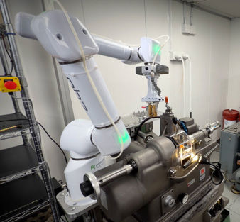

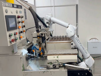

The deburring application wasn’t the end of it. During the webinar, Kirby showed OB7 robots loading and unloading the company’s Mikron 132.02 and A33/0 hobbing machines—retrofits done entirely in-house, no integrator involved. The robot picks from standard trays, re-grips for machine-loading orientation, loads the workpiece, closes the door, starts the cycle through an I/O connection, then unloads and blows off the part before placing it back in the tray.
An OB7 Stretch alongside the Mikron A33/0 hobbing machine.
Kirby said they’ve run thousands of parts this way, cycling four different part numbers of similar configuration through the A33 on one setup.
The OB7 at the Mikron 132.02.
