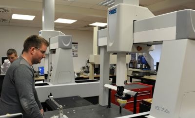

Before beginning the search for a new solution, the quality department outlined its desire to utilize multi-sensor technology in the reorganization of the facilities. After consulting several CMM vendors, an Altera 8.7.6 CMM from LK was identified as the ideal solution. The decision was made to install two of them, each providing multi-sensor capability complemented by LK Camio software.
In addition to a Nikon LC15Dx digital laser scanner, the new CMMs include a Renishaw TP200 tactile measuring probe. An ACR3 change rack ensures smooth, automated exchange between tactile and non-contact probes, controlled by the Camio acquisition and processing software.
