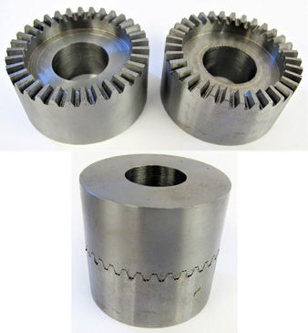

An optical example is given with the coupling in Figure 1. The two halves are fitted together in their operating position. There is no possibility of relative motion or a tooth rolling action, as the photo clearly shows.
Figure 1—Hirth coupling members, engaged.

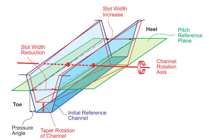

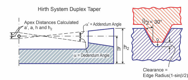

The design of a duplex taper is shown in Figure 2. The initial reference channel is defined at the center of the face width, with a parallel root width. Then it is rotated about the channel rotation axis until a slot width reduction at the toe and a slot width increase at the heel (measured in the pitch reference plane) is achieved. The slot width changes results in a slot width tapering along the face width, which is proportional to the circumference of the radius at the respective face width position (Ref. 2).
Figure 2—Cutting channel rotation to achieve a Duplex Taper.
The duplex taper makes it possible to machine the Hirth coupling slots, each in a single stroke with a disk milling cutter with cutting edge angles matching the pressure angle of the teeth. The root is fully rounded with a constant radius between toe and heel.

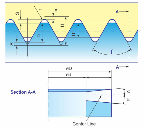

In Figure 3, there is a principal graphic of a Hirth coupling with the basic design parameters shown. The name Hirth only stands for the coupling design; there is no dedicated manufacturing process.
Figure 3—Basic design parameters of Hirth coupling.
Legend to Figure 3:
r    Root fillet radius
s    Root clearance
H    Theoretical tooth depth
h    Actual whole depth of teeth
U    Profile contact area
x    Access depth of pointed rack (2•x)
β    Included pressure angle
D    Outer diameter
d    Inner diameter
l    Face width
α    Dedendum angle
α'    Addendum angle

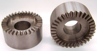

Figure 4—Typical Coniflex coupling parts.
The Coniflex Clutch input screen in GEMS gives the possibility to enter a desired root angle, to duplicate, for example, the Hirth duplex taper. The input also covers a depth factor, which can be used to match the depth of a Hirth coupling. In connection with the Hirth coupling pressure angle and the fully rounded root, a perfect duplication of the Hirth geometry is possible.

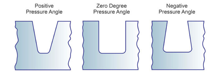

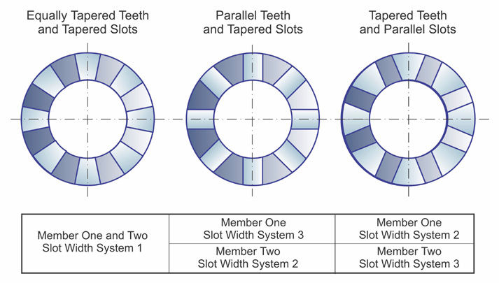

Three Slot Width Systems
In the Coniflex Clutch GEMS program, the choice is between three different slot width systems given. These systems are shown in Figure 6. Equally tapered teeth and slots are the most common system (left in Figure 6). System 2 has parallel slots and tapered teeth as shown in the center of Figure 6. The coupling member with slot width system 2 has to be paired with a member that consists of slot width system 3. Slot width system 3, as shown to the right in Figure 6, has tapered slots and parallel teeth and fits in a member having slot width system 2. Some industries require, for some reasons, designs where one member has parallel slots, and the second member has tapered slots. One frequently mentioned reason for this design is the improved self-centering, which, however, has not been scientifically proven and is solely based on practical experience.
Figure 6—Three slot width systems of Coniflex couplings.
Free Choice of Pressure Angles
A significant advantage of Coniflex is the possibility to manufacture on standard Phoenix machines not only couplings with positive pressure angle (Figure 7, left side), but also to choose zero degree or negative pressure angles as shown in Figure 7, center and at the right side.
Figure 7—Three slot width systems of Coniflex couplings.
Due to the peripheral Coniflex Plus cutters, any customary pressure angle can be realized with the same cutter and even with the same cutting blade geometry. There is no negative machine root angle required, as in many cases of Curvic couplings with negative pressure angles. The radial tilt required for Curvic couplings with negative pressure angles requires negative machine root angles, which are limited on standard bevel-gear machines.

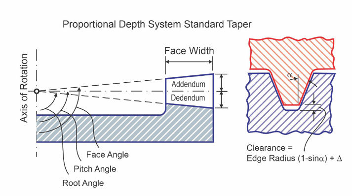

Coniflex Clutch designs use, as default, a standard taper. Standard taper means that the extension of the face line, the extension of the pitch line, and the extension of the root line all meet and intersect with the axis of rotation. This principle is shown in Figure 8. A standard taper delivers the strongest coupling regarding root bending stress of the coupling teeth. Slot width and tooth thickness are equally spaced, which means that both members have equally strong teeth.
Figure 8—Standard taper.

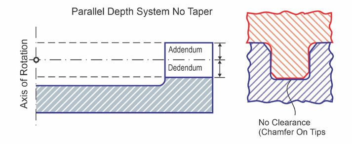

Parallel depth couplings are often chosen as fixed couplings where the members are permanently bolted together. The graphic shown in Figure 9 has a pressure angle of zero degrees and is assembled without top-root clearance and without any backlash as a transitional fit.

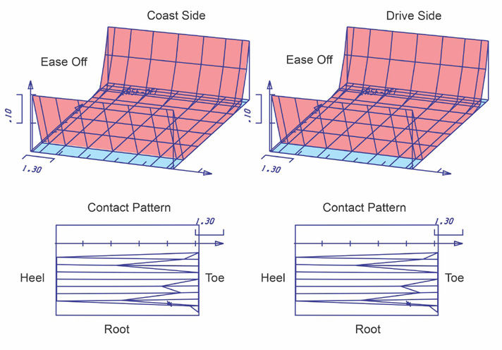

Flank Surfaces and Tooth Contact Analysis

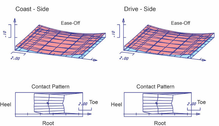

Flank surface generation and tooth contact analysis are standard features in the GEMS software system for Coniflex couplings. In Figure 11, a tooth contact analysis with Ease-Off and contact pattern is shown. The Ease-Offs have a length crowning of 20 microns and no profile crowning. Length crowning is realized as in regular Coniflex with a cutter dish angle. Because the Coniflex Clutch machining is a non-generated process, profile crowning cannot be generated kinematically as it is done in regular Coniflex. The only possibility to generate profile crowning is the application of curved blades.
Figure 11—Tooth contact analysis.

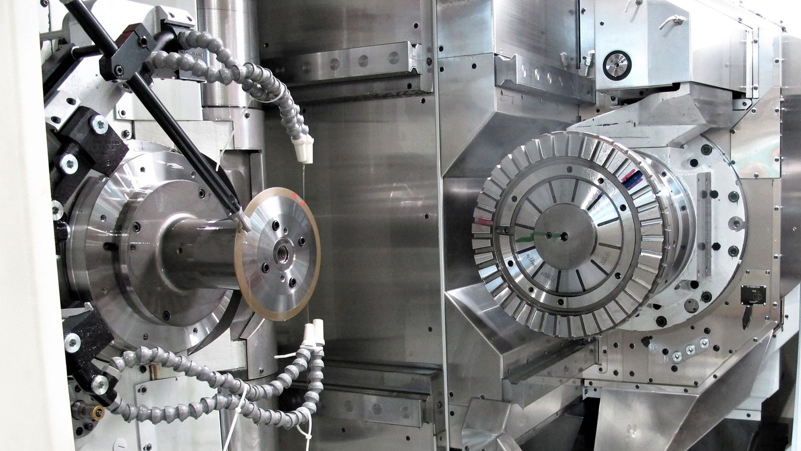

As mentioned above, both members for Coniflex couplings are cut or ground in a non-generating process. Only plunging is possible to form the flank surfaces. The lower flanks are plunged first, as shown in Figure 12. After all lower flanks (flanks 2) are cut, the cutter changes from the lower to the upper position, where it plunge cuts all flanks 1.

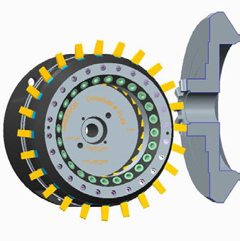

Figure 12—Cutting of a Coniflex coupling–CAD model.
If the slot bottom is wide, like in cases of zero degree and negative pressure angle, the fin removal function can be applied to have the blades sweep in the root width direction and clean out remaining fins or ridges. It is possible to save time for fin removal by using an increased blade point width. This has the advantage that the chip load during the plunge is not applied to a small cutting blade tip but to a wider and flat top cutting edge. Cutting with wide tips can result in a step or a fin. If sufficient top-root clearance is given, then an elegant solution is to create a gable bottom by using blades with a positive top slope angle, which is a standard in Curvic couplings (Ref. 3).

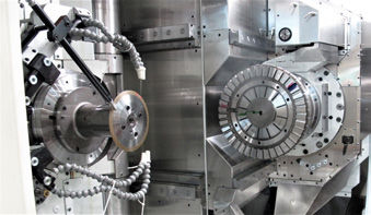

Coniflex couplings can be ground after heat treatment. Dressing of grinding wheel profiles is not possible for Coniflex gears and couplings because of the slim profile and the fact that dressing axially to the profile would change the grinding wheel diameter, which in turn would change the root geometry from part to part. The solution for Coniflex grinding was the use of permanently coated and non-dressable CBN grinding wheels.
The process in Figure 13 is not a standard Coniflex coupling grinding process. Based on the large part and the large face width, the Uniflex process was applied (Ref. 4). In Uniflex, the grinding wheel moves along the face width and produces a straight root line, independent of the grinding wheel diameter.
Figure 13—Grinding of a Coniflex coupling with a CBN-grinding wheel.

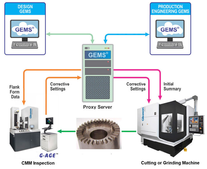

Like in regular Coniflex straight bevel gear calculations, GEMS produces a download file with flank form coordinates, normal vectors, and correction matrices for coordinate measurements with G-AGE correction output. Together with a company network, a fully automated closed-loop manufacturing can be set up.

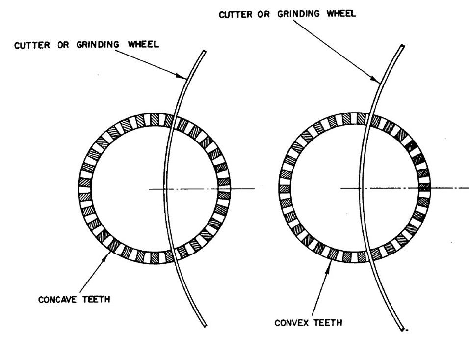

The main characteristic of Curvic couplings is the shape of the teeth. One member has barrel-shaped teeth while the other member has hourglass-shaped teeth. With this geometry, every single tooth, when engaged in a slot of the opposite member, contributes to self-centering between the two members. Other couplings like Coniflex or Hirth require two opposite teeth and slots to achieve a centering of a shaft in the face width direction.
A graphic of the orientation between the grinding wheel and Curvic coupling members is shown in Figure 16. In this graphic, the outside of the grinding wheel profile forms two concave flanks of the member with hourglass-shaped teeth (left). In one revolution, all teeth are finish ground. The opposite member is ground with the inside profile of a different grinding wheel and forms two convex flanks simultaneously, which results in hourglass-shaped teeth (right graphic in Figure 16). The wheel point diameter between the left and right graphics is adjusted such that either a full-face width contact or a located contact pattern is achieved. Profile crowning is also possible by dressing a curved grinding wheel profile.
Figure 16—Grinding of two convex flanks simultaneously.
It becomes clear that a single tooth and slot centering force requires a high accuracy of the tooth surfaces. In many steam turbines, more than 50 rotors are bolted together to one unit. The radial centering must provide low radial runout, but also the axial runout has to be in the fractional micron range in order to minimize the unbalancing of a long rotor unit. There is software available which uses spacing measurement results from coordinate measuring machines to calculate an optimal timing between two rotors. If all rotors are assembled with their optimal Curvic coupling timing, then the overall runout and unbalance of a long rotor unit can be minimized to sustain the highest rotational speeds.

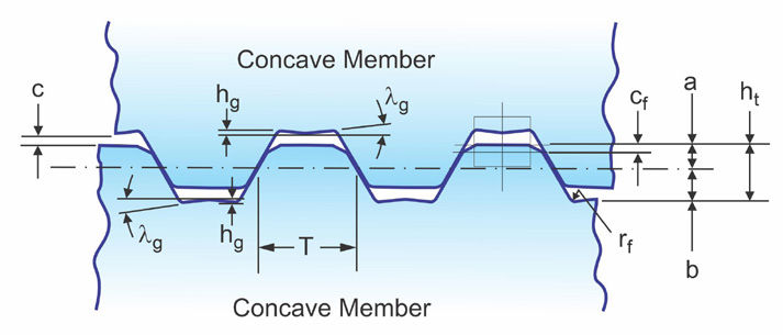

Figure 17 shows the nomenclature of Curvic coupling tooth profiles. The tooth depth of all Curvic couplings is uniform between toe and heel. The face width should be 12.5 percent or more of the outside diameter. The three types of Curvic couplings are explained in the next section.
Figure 17—Nomenclature of Curvic coupling profile.
Legend to Figure 17:
c    Clearance
hg    Gable height
λg    Gable angle
cf    Chamfer width
rf    Fillet radius
a    Addendum
b    Dedendum
ht    whole depth
Curvic couplings do not have a fully rounded root as the Hirth coupling. The stub tooth proportions of Curvics still allow sufficient fillet radii and a large area with a gable bottom (Ref. 2).

Figure 18—Curvic contact analysis.
The contact patterns in Figure 18 show a full flank surface contact, which is on top and root only limited by the topland chamfers. Coordinate measurements with nominal flank coordinates and normal vectors are possible with the flank form generating module in GEMS, which generates CMM download files and also has corrective information for G-AGE corrections.
