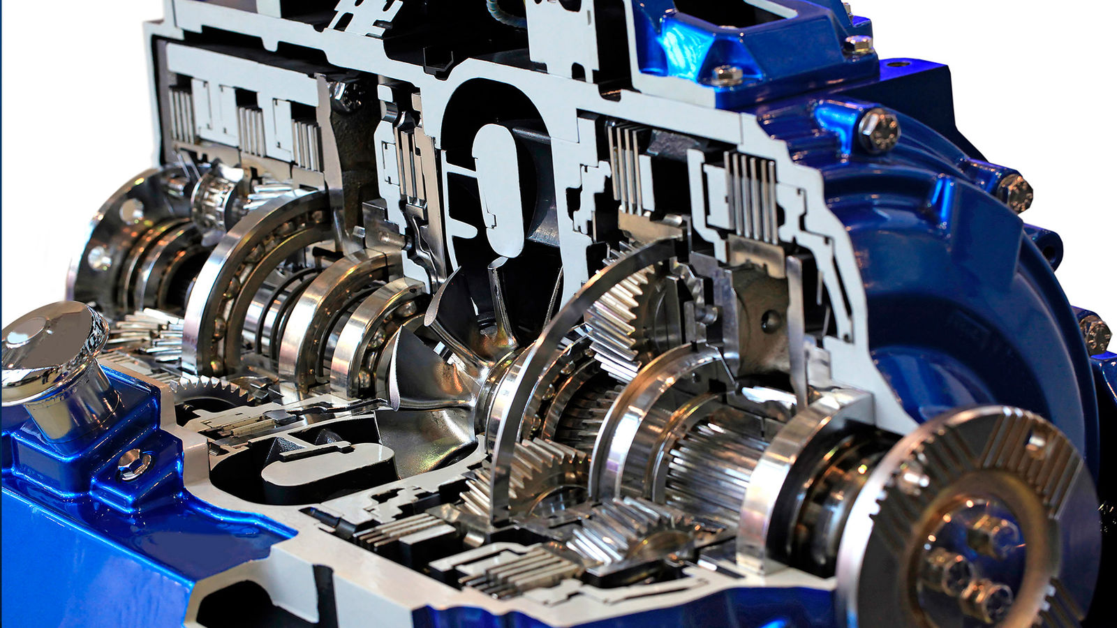

Automotive Technical Epicyclic Gears Planetary Gears
Cross-Correlation of Design Variables for Epicyclic Systems
The automotive industry pays great attention to the concept of power density and friction losses concerning mechanical transmission systems. Moreover, installation benefits and weight reduction are achieving higher density power. Another important study is about mechanical efficiency: their reduction allows to minimize the heat exchange; the power dissipation problem—produced by friction—must be addressed. Therefore, the gear designer is obligated to incorporate additional cooling systems, or with higher capacity, to address this problem.
Nowadays, electrical units must operate at higher speeds, and they also must manage two-way loading operations, especially hybrid transmissions. The combination of speed and torque must be managed by designers, considering load histories, and evaluating them appropriately.
In this context, the planetary gear systems meet the requirements of compactness and allow obtaining a high power density, especially compared with classic transmission systems obtained by cylindrical gear pairs. High transmission ratios can be reached thanks to these systems; as the target transmission ratio increases the comparison of mechanical epicyclic systems shows even more complex advantages. It is the task of the gear designer to choose the most suitable solution for his application.
Today lacks (focusing on the design of epicyclic gear drive systems) a tool that allows evaluating a series of them with defined constraints. The layout of interest chosen for this analysis involves a fixed ring gear, sun gear in speed out, and carrier as input. The study presented in this paper aims to show a flow of operation that allows the systematic study of gear train families, and it’s able to balance the pros and cons through correct visualizations.
