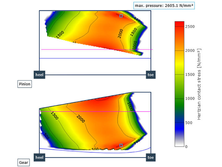

The first example is a differential gear that was initially designed as a classic forged bevel gear differential, with modified tooth root on toe side. While differentials were largely inconspicuous with classic drive technology, the situation with regard to the requirements for differentials has changed fundamentally with the increasing introduction of hybrid and electric drives. In particular it should be emphasized that due to the recuperation mode and the increased drive power when cornering, e-drive solutions also lead to significantly higher torques. Above all, this means that the very high Hertzian pressures on the flanks no longer occur predominantly only when driving straight ahead and thus when the differential is stationary, but also when cornering. This leads to a significantly higher risk of flank damage such as pitting or flank breakage.
Following the macrogeometry data for the original bevel gear design:
  • Number of teeth: Pinion z1 = 11, gear z2 = 16
  • Mean normal module: mmn = 3.792 mm
  • Face width: b = 22 mm
  • Ball diameter: de = 80 mm
  • Pressure angle: an = 22.5°
  • Two output bevel gears, four planets (pinions)

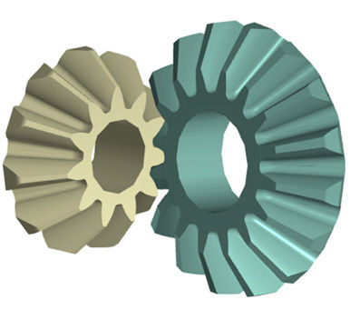

The total gear output torque (design torque) is 4,026 Nm, which, with two output gears and four pinions, results in a pinion torque of the single mesh of Mt1 = 346 Nm with the given transmission ratio. These are forged bevel gears with tooth root geometries adapted to the toe to enable the largest possible internal diameters. The weight of the pinions is approx. 0.3 kg each, that of the wheels approx. 0.7 kg each. The total weight of the complete wheel set is therefore approx. 2.6 kg. Figure 1 shows the design model of a pair of bevel gear sets that was created using gear design software (Ref. 4).
Figure 1—model of a differential bevel gear set.

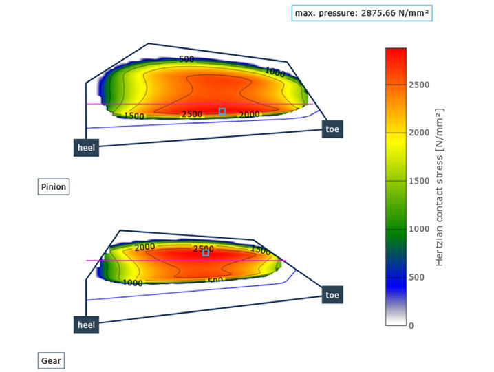

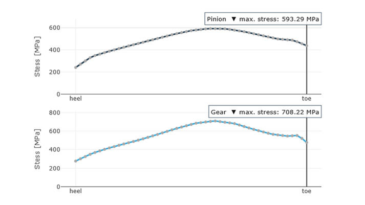

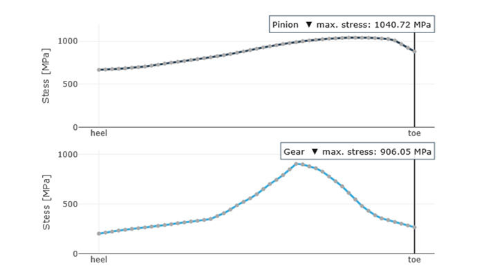

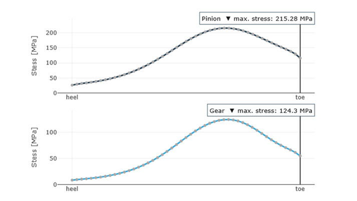

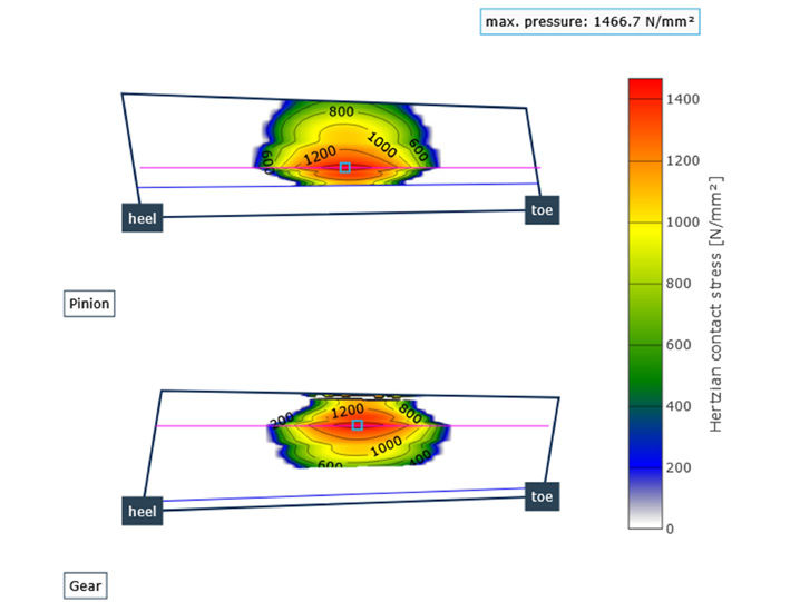

For a pair of gears described above, the microgeometry and target-oriented ease-off were first developed using the design software. The Hertzian pressure and tooth root stress for the design torque were then calculated using LTCA software (Ref. 5). Figure 2 shows the distribution of the maximum Hertzian pressure on the tooth flank, and Figure 3 shows the course of the maximum tooth root stress over the face width.
Figure 2—Hertzian Pressure of a differential bevel gear set.
Figure 3—Tooth root stress of a differential bevel gear set.

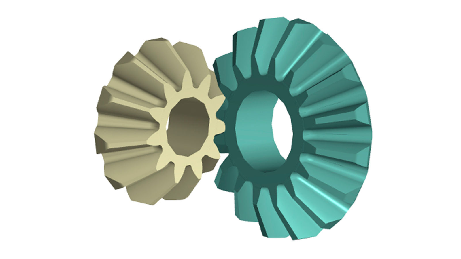

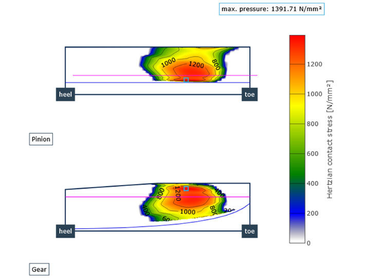

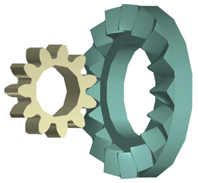

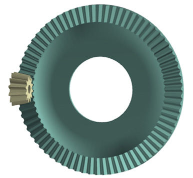

In a further step, a crown gear differential with the same number of teeth was developed. It has approximately the same Hertzian pressures at the design torque as the bevel gear differential. Again, a gearing model was initially developed with the help of the design software. During development, it immediately became apparent that the realizable face width of crown gears is limited, especially with such small ratios, as already described in the introduction, the tooth root fillet starts too close to the tooth tip when the inner diameter becomes too small, and the tooth tip becomes too pointed when the outer diameter becomes too large. This results in a smaller face width compared to the bevel gears, which may have to be compensated for by an overall larger diameter.
The following macrogeometry of the crown gear pairing has proven to be promising in this specific case:
  • Average normal module: mmn = 4 mm
  • Face width: b = 15 mm
  • Outer wheel diameter: de2 = 100 mm
  • Pinion pressure angle: an1 = 20°
The weight of the pinions is approx. 0.1 kg each, that of the crown gears approx. 0.5 kg each. The total weight of the complete gear set is therefore approx. 1.4 kg and is thus approximately 45 percent lighter than the bevel gear set. Figure 4 shows the design model of the crown gear set that was created with the help of the same design software as used for the bevel gear set.
Figure 4—Model of a differential crown gear set.

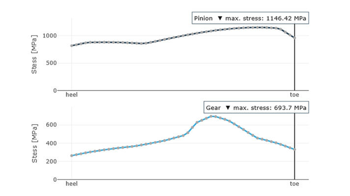

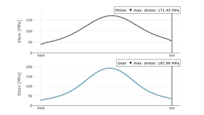

In the next step, the LTCA software was again used to calculate the Hertzian pressure and the tooth root stress for the design torque. This is possible because the software in question works with the aid of point clouds and is no longer tied to an integrated bevel gear flank generator. The design software provides the point clouds for the crown gears in the same way as those for the bevel gears. Figure 5 shows the distribution of the maximum Hertzian pressure on the crown gear tooth flank; Figure 6 shows the course of the maximum tooth root stress over the face width.
Figure 5—Hertzian pressure of a differential crown gear set.
Figure 6—Tooth root stress of a differential crown gear set.
In comparison with the results for the bevel gear set, the Hertzian pressure on the crown gear set is more or less at the same level. However, higher tooth root stresses are to be expected, especially for the pinions. This means that the crown gear set would have approximately the same flank load capacity, a significantly lower weight, and considerably simplified bearing of the pinions due to the lack of axial force, with less risk of scoring in the pinion hub. However, with a slightly smaller overall width, this results in a slightly larger diameter of the crown gear and lower tooth root load capacity on the pinions. In contrast to bevel gears, the pinions of crown gear sets cannot be forged, but must be milled or even ground. The crown wheel can also be forged, which may even be easier. In addition, no adjustments need to be made to the tooth root geometry of either component, as is usually the case with forged bevel gears. Figure 7 shows a realized crown gear differential including the differential housing.

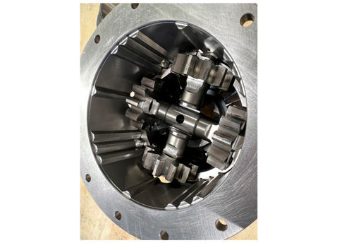

Figure 7—Photograph of a realized differential with crown gears.

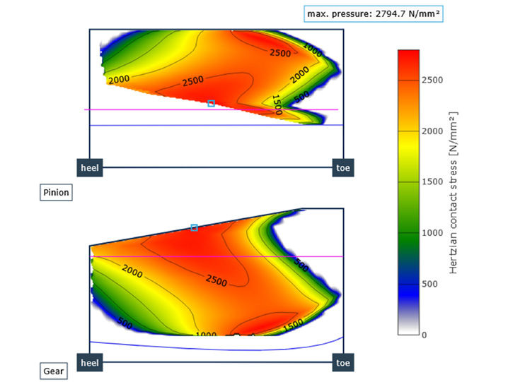

Figure 10 shows the bevel gear set model, Figure 11 shows the Hertzian pressure at a pinion torque Mt1 = 1 Nm, and Figure 12 shows the tooth root stress at the same torque.
Figure 10—Design model of an actuating bevel gear set.
Figure 11—Hertzian pressure of an actuating bevel gear set.
Figure 12—Tooth root stress of an actuating bevel gear set.
The high effort required to adjust the contact pattern proved to be unfavorable for this gearbox, as the overhung pinion could only be installed and removed with great effort. In addition, relatively large bearings had to be used to absorb the axial force from the pinion. It was therefore investigated whether this gearbox could be replaced by a crown gear gearbox.

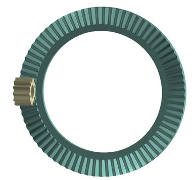

Due to the significantly larger transmission ratio compared to example 1, the same face width can be realized with the crown gear as with the bevel gear. Apart from a slightly reduced normal module of mmn = 0.8 mm, the macrogeometric data are the same as for the bevel gear set. Figure 13 shows the gear set model, Figure 14 shows the Hertzian pressure at a pinion torque Mt1 = 1 Nm, and Figure 15 shows the tooth root stress at the same torque.
Figure 13—Design model of an actuating crown gear set.
