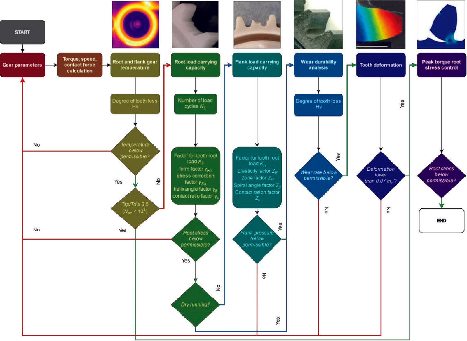

Figure 2—Failure mode control process within the plastic gear’s design phase as recommended by the VDI 2736: Part 2 guideline for cylindrical gears.
Step 1. Calculate the operating temperature for the gear pair under design
To ensure the reliable operation of a plastic gear, its operating temperature needs to be lower than the permissible temperature for a continuous load. The coefficient of friction for the selected material pair is needed in this step to be able to calculate the heat generated by friction.
Step 2. Root strength control
The actual stress in the tooth’s root needs to be lower than the material’s fatigue limit at the desired number of load cycles (1 rotation of the gear is 1 load cycle on each tooth). Knowledge of the material’s fatigue strength is required to complete this step.
Step 3. Flank strength control against pitting
This step is usually performed only for plastic gear pairs running in oil, as this is the only operating condition where pitting on plastic gears is sometimes observed. For dry-running or grease-lubricated plastic gears, root fatigue or wear are the most frequent failure modes.
Step 4. Wear control
Needs to be conducted for dry running plastic gears. It is recommended to do this control step also for grease-lubricated plastic gears if the plastic material is reinforced with fibers. Pulled out and cracked fiber particles tend to mix with the grease, forming an abrasive medium. The wear factor for the material pair of choice is required to conduct this step.
Step 5. Teeth deflection control
Excessive deflection of teeth should be avoided to prevent teeth jamming and irregular meshing. Elastic modulus is required in this step to be able to calculate the tooth’s deflection.
Step 6. Control of the static load
In some applications, the gears are loaded with a high static load, e.g., holding some weight in a defined position. In that case, the gears need to be rated against a static load, and knowledge of the material’s tensile strength is required.
It is not necessary to always conduct all the design rating steps. Step 1, Step 2 and Step 4 are advised to be always conducted, while others are case dependent.

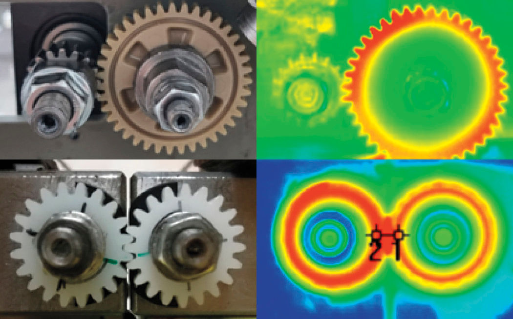

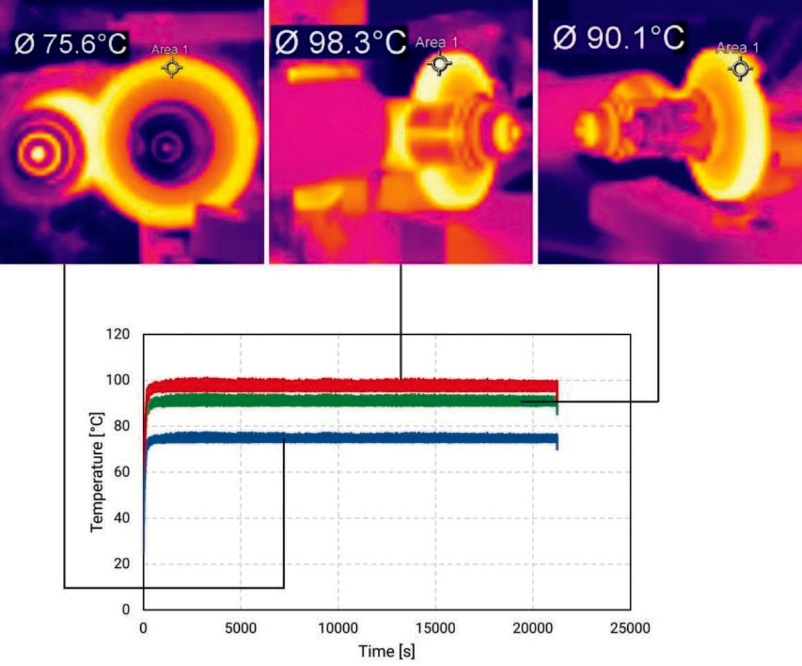

Gears heat up during operation. An exemplary temperature measurement conducted by a thermographic camera is shown in Figure 3. Friction between the meshing teeth and hysteretic effects are the main reasons for the temperature increase in plastic gears. The rate of heat generation and the resulting temperature rise depend on several factors, e.g., torque, rotational speed, coefficient of friction, lubrication, thermal conductivity, convection, gear geometry, etc. To ensure the reliable operation of a plastic gear, its operating temperature needs to be lower than the material’s permissible temperature for a continuous load.
Figure 3—a) Thermal image of a Steel/Plastic gear pair during operation, b) Thermal image of a Plastic/Plastic gear pair.
Figure 3—a) Thermal image of a Steel/Plastic gear pair during operation,b) Thermal image of a Plastic/Plastic gear pair.
The first rating point for plastic gears is the prediction of the operating temperature to ensure no thermal overload (Figure 1c) occurs under the specified operating conditions. The VDI 2736 guideline employs a slightly supplemented Hachmann-Strickle model (Ref. 23), which was presented in the 1960s. The Hachmann-Strickle model was later supplemented by Erhard and Weiss (Ref. 24). The guideline goes further and proposes a model for calculating the temperature in the tooth’s root:

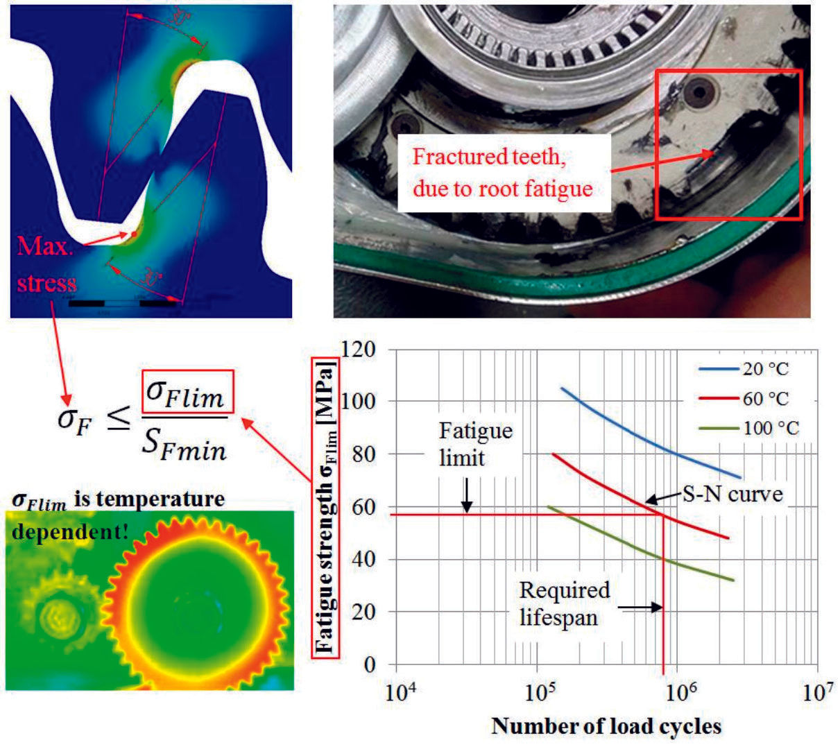

To avoid root fatigue fracture, which is a fatal failure, the root stress σF in a gear needs to be lower than the material’s fatigue strength limit σFlim for the required operating lifespan (Figure 4). To account for unexpected effects some additional safety SF is usually also included.
(3)
To calculate the root stress, the VDI 2736 guideline proposes the same equation as provided by the DIN 3990 (Method C) (Ref. 28), which is a standard for steel gears:
(4)
The guideline further simplifies the equation by assuming that for plastic gears, if the condition b/m≤12 is met, the root load factor can be defined as KF=KA∙KV∙KFβ∙KFα≈1….1.25.
While Equation 4 is simple to use and familiar to any gear design engineer, the major drawback is that it does not account for the load-induced contact ratio increase, hence overestimating the actual root stress values. A more accurate root stress calculation can be achieved by employing numerical manners, e.g., by FEM simulation. FEM-based methods are, however, labor and cost-intensive.
Assuming the root stress for the gear design under evaluation is calculated, it needs to be compared to a fatigue limit σFlim which is a material property and needs to be characterized by extensive gear testing on a dedicated test bench. For plastic materials, the σFlim is temperature dependent; therefore, several S-N curves generated at different gear temperatures are required (Figure 4).
Figure 4—Temperature-dependent S-N curves are needed to conduct root strength control.
Figure 4—Temperature-dependent S-N curves are needed to conductroot strength control.

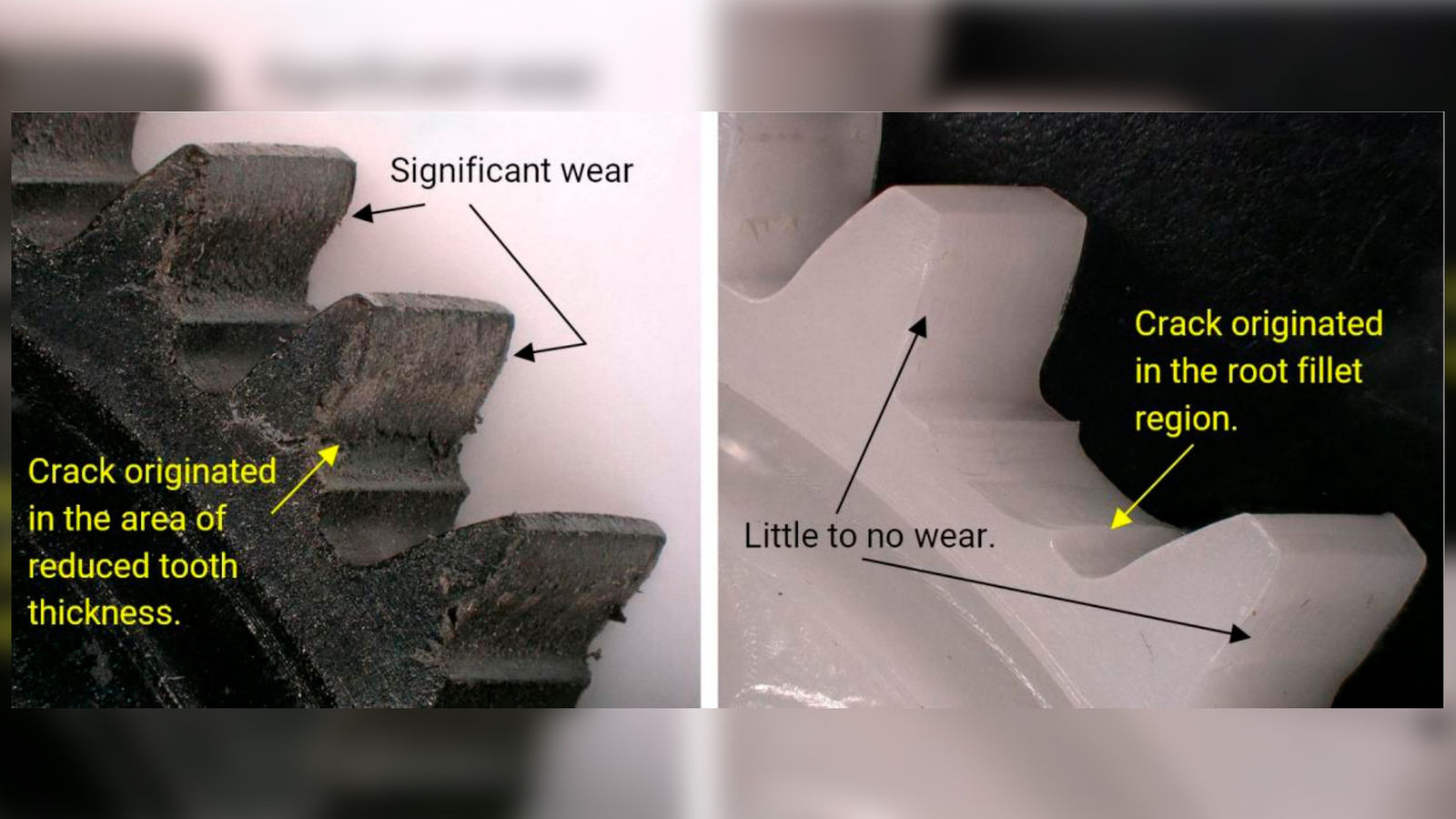

Wear Control

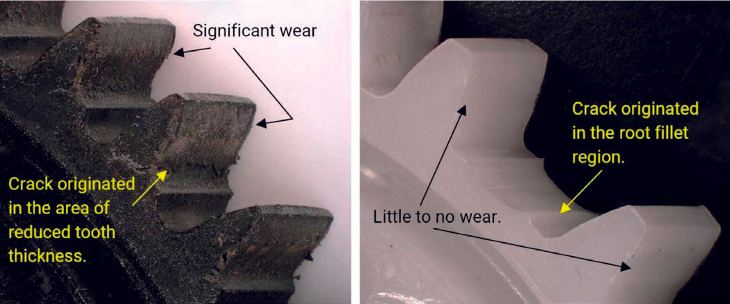

Wear is a common damage mode for dry runs and some grease-lubricated applications with plastic gears. It can lead to a fatal failure where teeth are worn to the degree that they break instantly under load or that fatigue cracks originate at the worn section (Figure 5a). The wear of plastic gears, in the final stages, leads to fracture (assuming gears are not replaced before). The crack initiation location in such cases often differs from what is expected of a classic root fatigue failure mode (Figure 5b). Due to the reduced tooth thickness, stress concentration and, consequently the crack initiation location can be often found higher in the dedendum area, in the region where the active tooth flank starts. In several applications, the gears might not have failed; however, they do not fulfill the application requirements if they are worn to an acceptable degree, e.g., in high-precision applications. The following equation:
(7)
is proposed by the VDI 2736 guideline for wear control. The only material-dependent parameter is the wear factor kw which considers the wear properties of the material pair under evaluation. It is important to note that the wear behaviour of plastic gears is dependent on both materials in the pair.
Figure 5—a) Severe wear, leading to fatigue-induced cracks at the worn section of the tooth profile, b) Root fatigue failure mode—crack originates in the filleted root section.

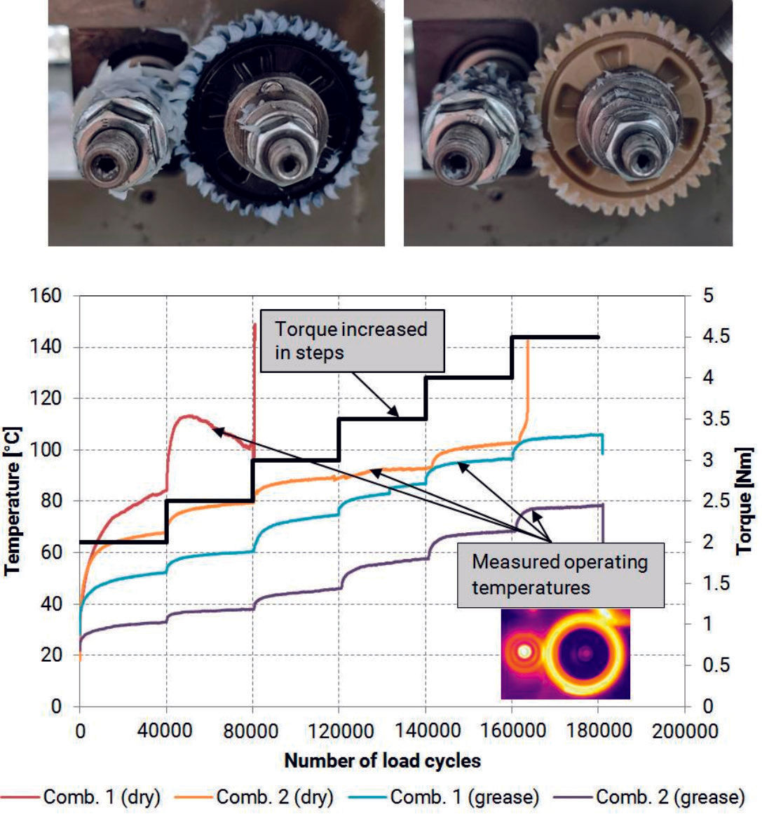

  2. For initial material screening, accelerated (step) tests can be employed (Figure 7). These enable the evaluation of a large set of different materials (or material pairs) in a rather quick and cost-efficient way. Such tests need to be conducted in precisely controlled operating conditions. Usually, the torque is increased in steps until the final gear failure, and the rotational speed is kept constant. When dealing with plastics, the operating temperature is a highly important parameter. In step tests, there are two possibilities, depending on what the research focus is.
    1. If the focus is to compare the material’s load-bearing capacity under fatigue load, it is better if the plastic gear’s temperature is controlled.
    2. If the focus is to study tribological behavior, it is more convenient to let the gear pair evolve its operating temperature. This way, material combinations that exhibit a lower friction can be identified. By employing the same approach, different lubricants can also be evaluated and the best one for your gear application can be selected.
      Figure 7—The accelerated gear testing methodology.

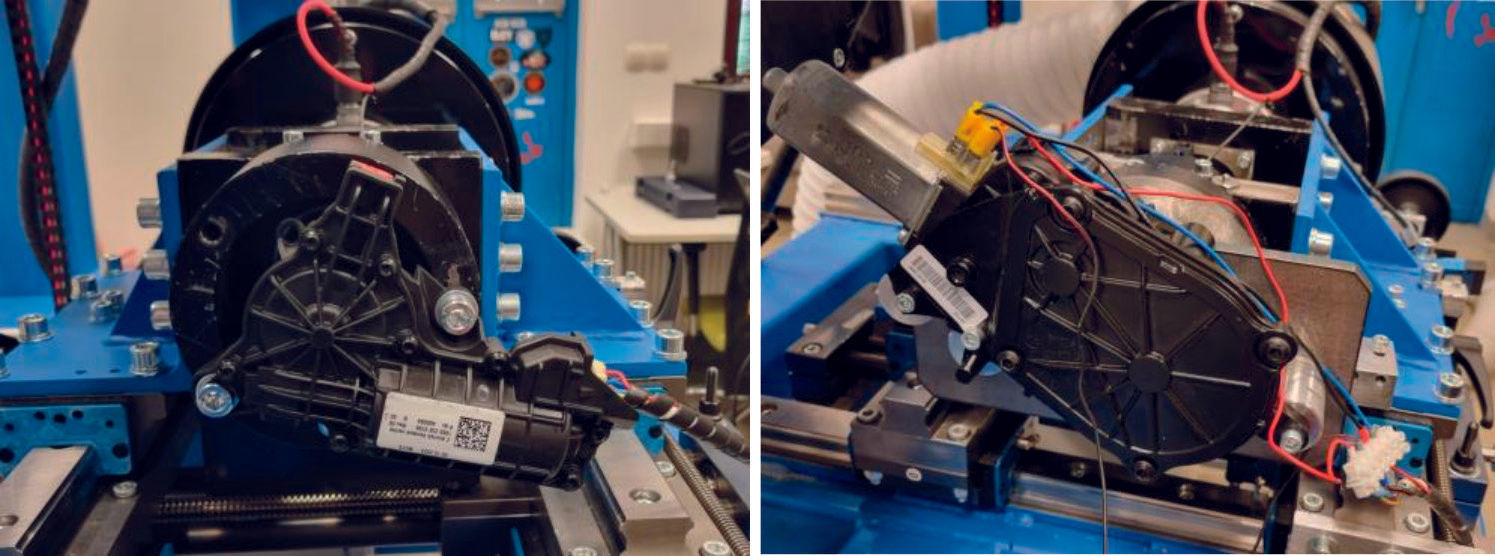

  5. Testing of gears in the final application—product validation, as shown in Figure 8. The production of tools for injection molding is expensive and time-consuming. It is important to do all the previous steps well and produce the tools only once.
Figure 8—Validation on the final application.

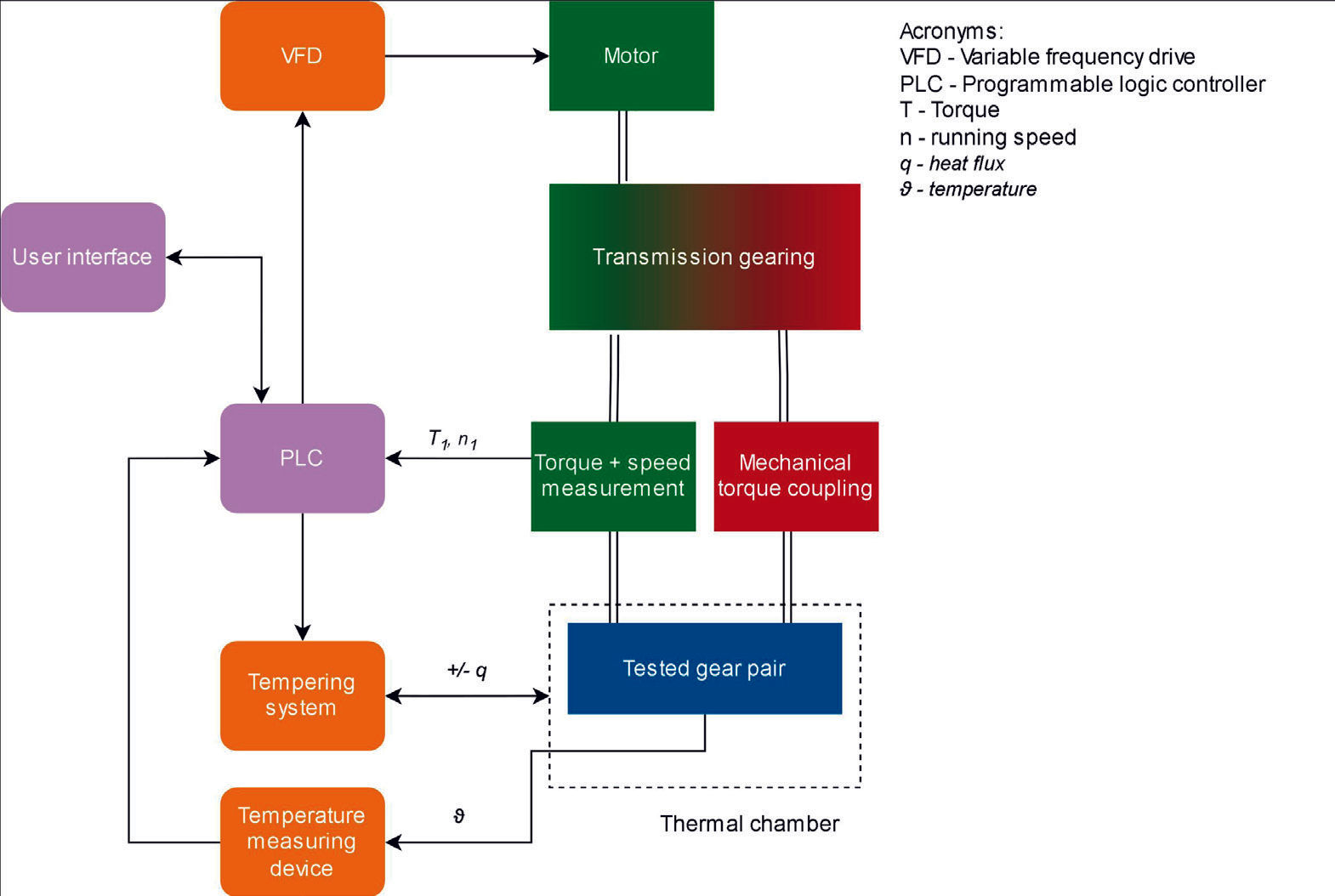

There are three main test rig layouts used for gear testing. The back-to-back test rig, presented in Figure 9, is a very well-known concept that has been widely used for the testing of steel gears. For the testing of plastic gears, the basic concept of this test rig has some limitations. In a back-to-back test rig, the torque on the tested gear pair is applied by a rotational displacement of a loading clutch. Plastic gears deflect under load significantly more than steel ones. Due to the teeth deflection, some of the torque applied with a rotational displacement of the loading clutch is lost. Additional torque loss occurs during the test duration due to the viscous properties of plastic materials and additional deflection of teeth due to creep. As plastic gears wear quite significantly during operation, another portion of torque loss occurs due to tooth wear. This problem can be solved by applying a continuously adjustable electromechanical or hydraulic torque application system, which significantly complicates the test rig’s design and control, adding to the overall cost of the test rig. Another disadvantage when it comes to gear testing is that the center distance is fixed and determined by the master gear pair.
Figure 9—Schematic representation of a closed-loop, back-to-back gear test rig.

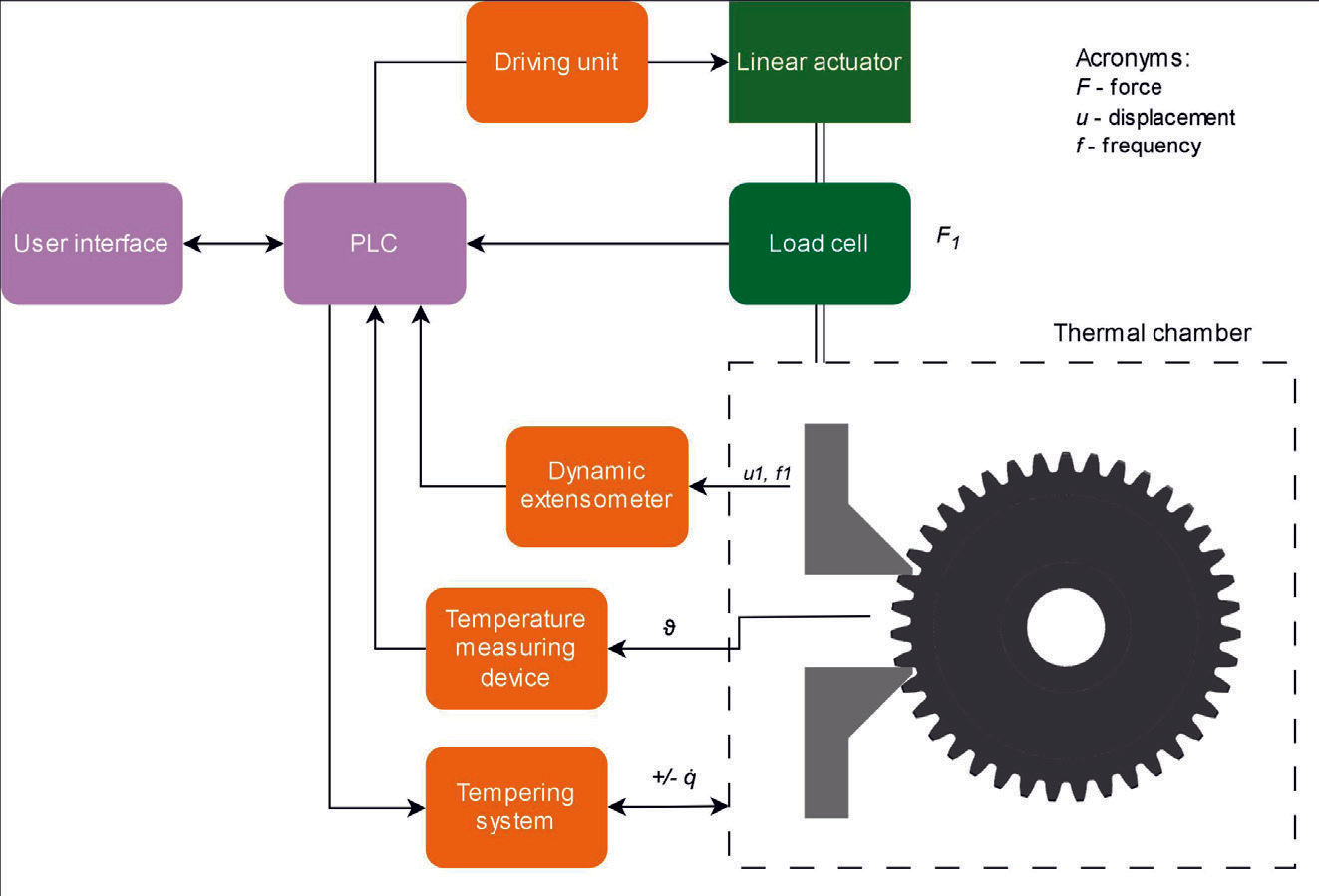

The fourth possible layout is the pulsator test rig, also called a single-tooth bending test machine (Figure 12). In this type of test rig, a single tooth is subjected to pulsating cyclic loading in the tangential direction relative to the gear tooth. The limitation of the test rig is that it can only be employed to study root fatigue, while other possible failure modes, e.g., wear, pitting or thermal overload, cannot be observed. Another limitation is that the load on the tooth is not applied in the same direction as when gears are meshing, requiring a suitable analytical model to correlate the results with gear-meshing conditions.
Figure 12—Schematic representation of a pulsator test rig.

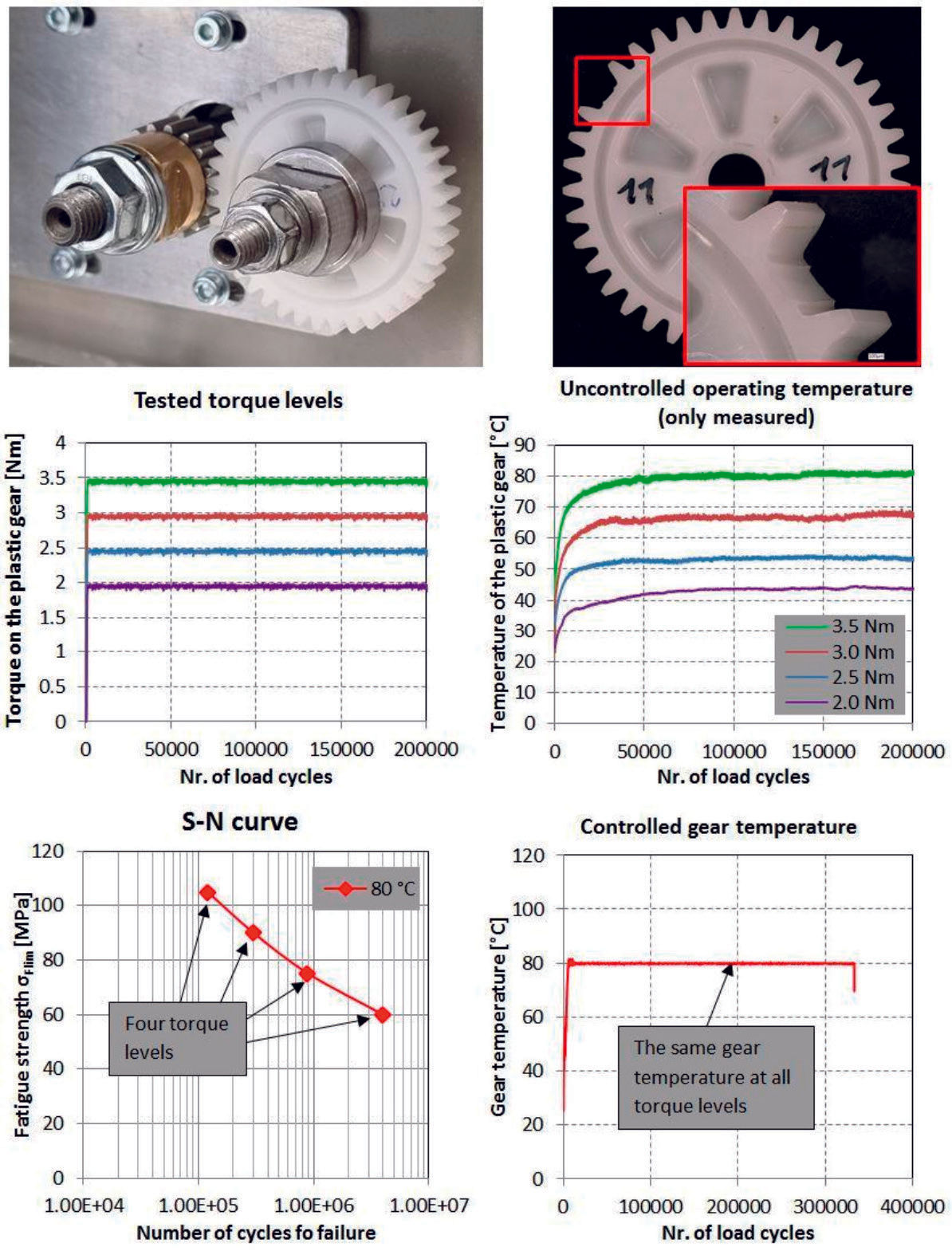

Irrespective of the test rig design, the most important testing conditions, i.e., the transferred torque, the plastic gear’s temperature and the rotational speed, need to be precisely controlled during the entire test. While torque and speed control can be quite easily achieved, controlling the plastic gear’s temperature is a bit more challenging. Tests conducted for S-N curve generation are usually performed at a selected rotational speed and various torque levels. The rate of heat generation and the resulting temperature rise depend strongly on the transmitted torque. A sophisticated gear-temperature control system is therefore required to control the plastic gear’s temperature at a selected level, irrespective of the tested torque and rotational speed.
The increase in gear temperature significantly impacts the durability and fatigue resistance of polymer gear pairs. S-N curves, which chart stress against the number of cycles to failure, must be assessed as a function of temperature. Typically, these curves are characterized as a function of bulk root temperature. However, as seen in Figure 13, the choice of a measurement point greatly affects the results. The images depict a gear test conducted under controlled conditions (with a temperature set at 90°C), selecting three different points for measurement. These varying points can yield substantially different outcomes.
VDI 2736 offers general instructions for measuring root temperatures, yet a more precise specification is advisable. It is recommended to place the measurement sensor at the midpoint of the gear’s face width and on the passive flank side. This location typically provides an average temperature that accurately reflects the root temperature, given that the passive tooth flank does not heat up substantially compared to the root temperature, and it will therefore influence the measurement only marginally. Conversely, placing the sensor on the side surface beneath the root tends to produce significantly lower temperature readings compared to those at the center of the face width.
Figure 13—Tested loads and the controlled operating temperature of the plastic gear.
Figure 13—Tested loads and the controlled operating temperature ofthe plastic gear.

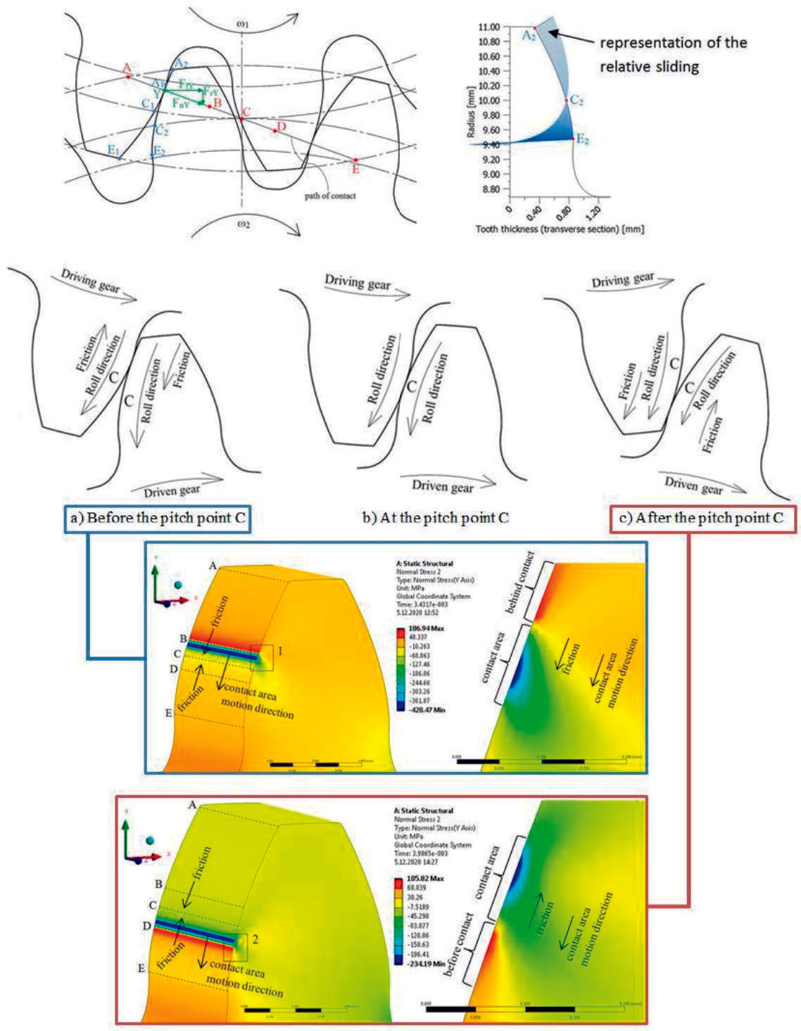

The contact conditions between the two meshing flanks are shown in Figure 15; rolling and sliding motions are present between the surfaces in contact. The direction of sliding and the frictional force are reversed when passing through the pitch point C. On the driven gear, the direction of sliding points always towards the pitch point C, so the kinematic line is usually clearly visible on the worn gear surface. The main difference, when compared to the disk-on-disk test, is that with the disk-on-disk test, the sliding rate is constant all the time, and the direction of the frictional force remains the same. The pin-on-disk test is even less suitable since there is only sliding motion present in contact without any rolling.
Figure 15—Contact conditions during gear meshing. The direction of friction changes once the contact passes the pitch point. The frictional force is on the driven gear and always oriented towards the pitch point and vice-versa on the drive gear.
Figure 15—Contact conditions during gear meshing. The directionof friction changes once the contact passes the pitch point. Thefrictional force is on the driven gear and always oriented towards thepitch point and vice-versa on the drive gear.
The gear-meshing process is presented in Figure 15. The theoretical path of contact of the involute gears pair has the shape of a straight line. During operation, gears transfer torque, which results in a normal force FnY acting in an arbitrary meshing point Y between the two teeth in contact (Figure 15). The normal force FnY can be decomposed to radial FrY and tangential force FtY. In involute gear pairs, the normal force acts along the path of contact. The gears start to mesh in point A, this is point A1 on the flank of the drive gear and point A2 on the flank of the driven gear. In the meshing area A-B, two pairs of teeth are in contact; therefore, the transmitted load is divided between them. Point B is the highest point of single tooth contact for the driven gear. In the B-D area, the total load is transmitted only through one pair of teeth. Point D is the lowest point of single tooth contact for the driven gear. At this point, the next pair of teeth comes into contact and the load is in the area D-E again transmitted via two pairs of teeth. Hence, the load on a single tooth is not constant during meshing along the path of contact. Meshing ends in point E, this is point E1 on the flank of the drive gear and point E2 on the flank of the driven gear. When gears are meshing from A to C, the flank part A1C1 on the drive gear is meshing with the flank part A2C2 on the driven gear. Due to the different lengths of the flank parts in contact, specific sliding occurs between the surfaces in contact (Figure 15). Analogously, the same happens in the meshing part from C to E, except that when passing through the kinematic point C, the direction of sliding is reversed. Most sliding occurs in the root part of the tooth, where the greatest wear is to be expected. In theory, there is no sliding at pitch point C, only pure rolling due to tooth deflection; sliding also occurs at point C. Such specific contact conditions can be best represented by a gear-on-gear test.

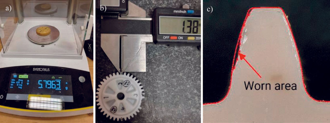

Different wear characterization methods can be used, as presented in Figure 16. The most used ones are the gravimetric method and the tooth thickness reduction method. When employing the gravimetric method wear is characterized as the loss of mass, while in the tooth thickness reduction method, the wear is determined as the reduced tooth’s chordal thickness. Several advanced methods can also be used, e.g., image processing or optical measurements; however, these are more costly and labor intensive. The wear can be tracked during testing by conducting regular checkpoints or the wear is measured after a specified number of load cycles. Different stages of wear a presented in Figure 17.
Figure 16—Wear measuring techniques: a) gravimetric method, b) tooth thickness reduction method, c) image processing method.
Figure 16—Wear measuring techniques: a) gravimetric method, b)tooth thickness reduction method, c) image processing method.
Figure 17—Wear in different stages: a) Initial wear, b) Significant wear, in practice usually still acceptable, c) Critical wear which led to failure.
Figure 17—Wear in different stages: a) Initial wear, b) Significant wear,in practice usually still acceptable, c) Critical wear which led to failure.
