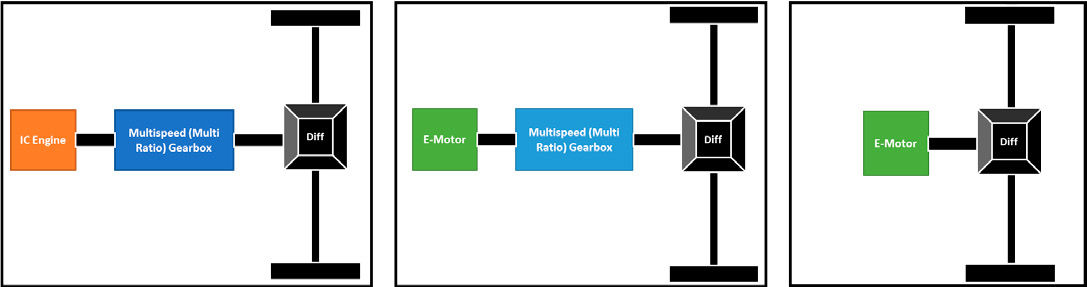

A typical ICE powertrain layout, as illustrated by the block diagram of Figure 1a, is comprised of an engine, a gearbox, and a rear drive axle. For a 14-ton vehicle, a multi-speed (5 or 6 speed) gearbox is generally necessary. Some commercial vehicle manufacturers have initiated the transition to Electric Vehicles, adopting a retrofit approach. This involves replacing the ICE with an electric motor while keeping the rest of the powertrain the same (Ref. 2) as illustrated in Figure 1b. While this approach could potentially reduce initial costs and prolong the lifei of the existing fleet, it may not yield the most efficient solution, even with adjustments to the gearbox (Ref. 2) An alternative approach would be to replace both the ICE and the multi-speed gearbox with a high-torque, low-speed electric motor to directly drive the rear axle as illustrated in Figure 1c.
Figure 1—Powertrain layouts.

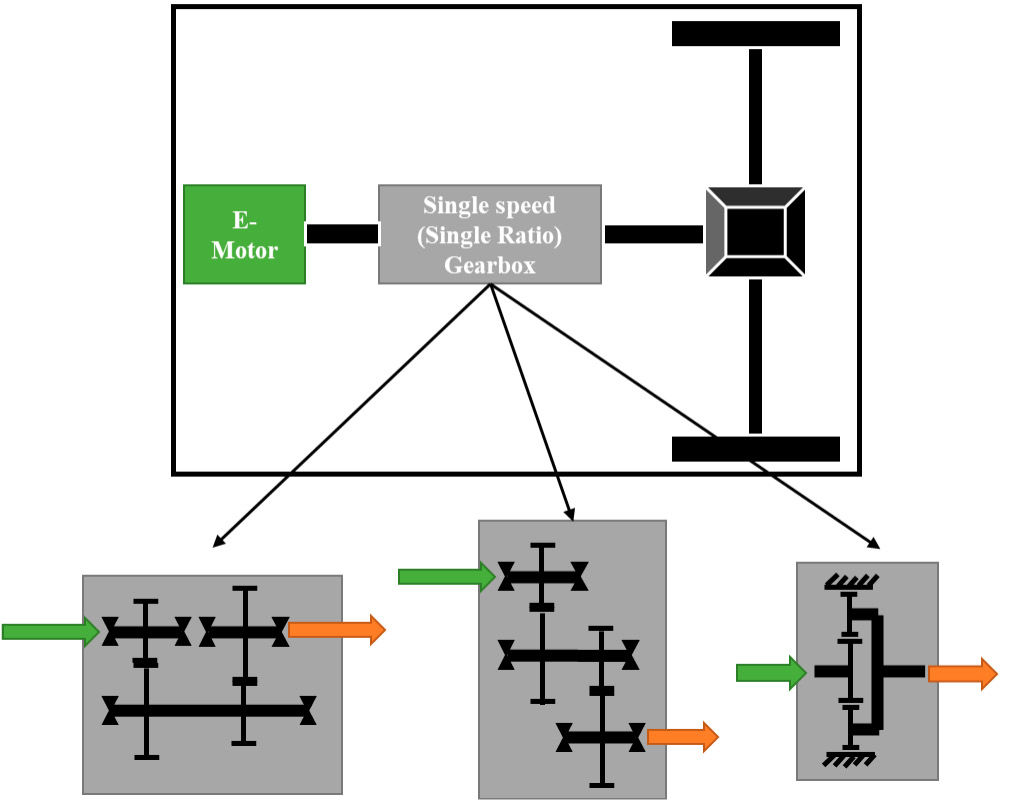

Building on the concept of optimizing electric powertrain layouts, a more effective solution for an 8–14-ton central drive layout emerges. This solution, as shown in Figure 2, uses a power-dense, high-speed (>10,000 rpm) motor coupled with a single-speed reduction gearbox. System analysis shows that a single gear ratio is sufficient to meet the startability, gradeability and top speed requirements of 8–14-ton vehicles. Because of a single reduction ratio gearbox and a high-speed motor, the overall powertrain becomes power-dense. A comparative study between the direct drive layout and a motor with a single reduction ratio gearbox showed a 300 percent weight improvement in the powertrain. Now this single-speed gearbox can further have different configurations as shown in Figure 2.
Figure 2—Central drive system with different gearbox configurations: (a) Coaxial input/output with offset gear layout; (b) Offset input/output with countershaft layout; and (c) Coaxial input/output with planetary layout.

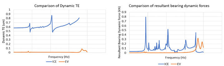

As EV operates at higher input rpm, to quantify the effect of speed on noise, we have compared the dynamic TE over a vehicle speed of 0–60 kmph and its combined effect on the resultant dynamic forces acting at the bearings. Figure 8 shows that the dynamic TE in EV is maintained to less than one-third of that in ICE, thus significantly lower resultant dynamic forces are observed at the bearings. At higher frequencies, the first harmonics of the resultant dynamic forces are a bit higher, but still, the peaks of EV are much smaller in magnitude than the ICE. So, in EV, it is important to minimize static as well as dynamic transmission error, as the input speeds in EV are much higher compared to ICE. As the nominal value for TE reduces, even small variation in TE leads to higher variations in sound pressure level (SPL). So, the gear design should be robust enough that the TE is least sensitive to manufacturing errors to minimize variation in SPL.
Figure 8—Dynamic TE and Resultant Dynamic Force comparison for ICE and EV.
