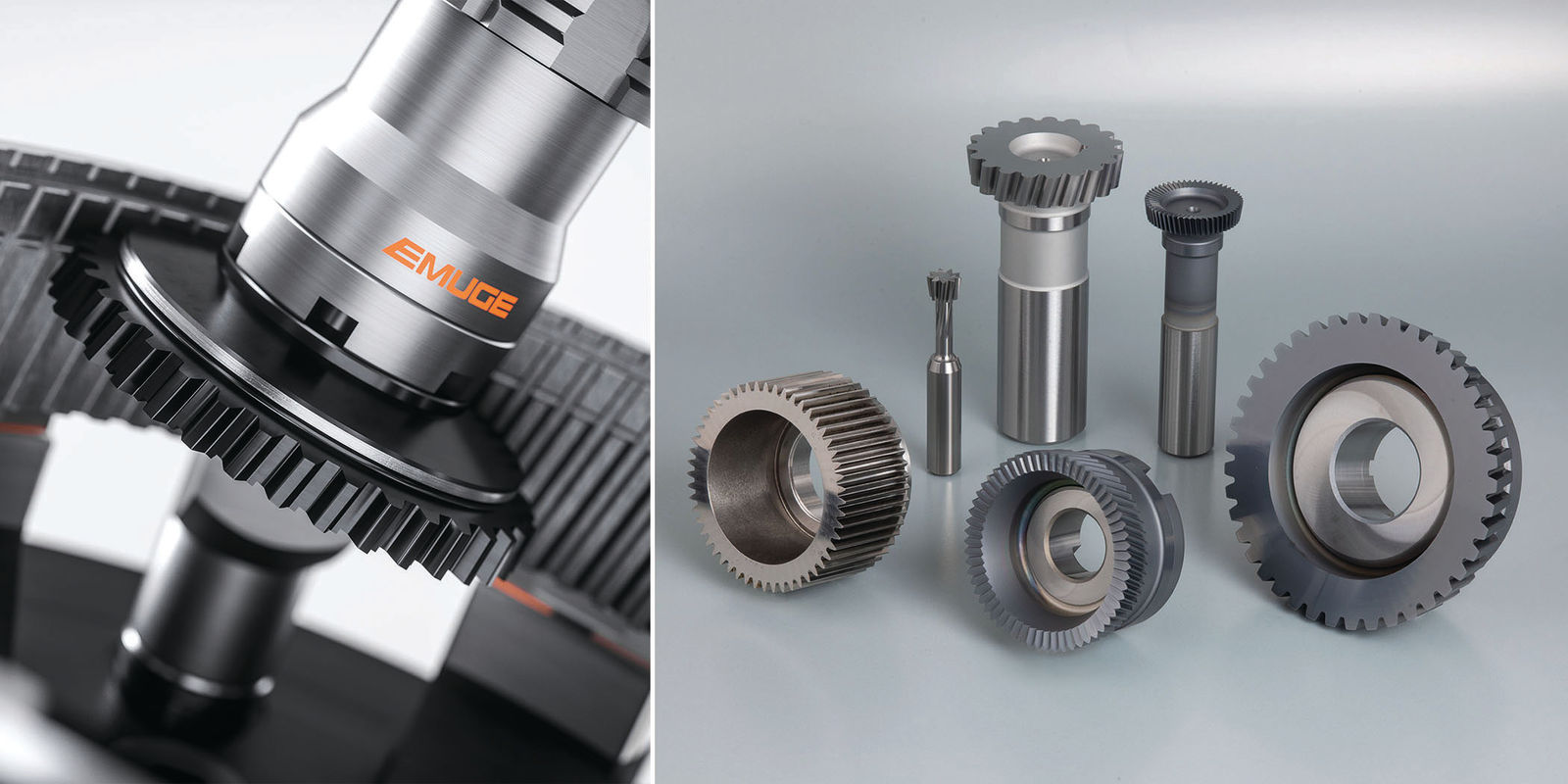

Emuge–Franken USA offers gear manufacturers a single source for a full range of Skiving Tool Solutions including wheels for internal and external gears as bell-type or shank tool variants in the module sizes m 0.4 to m 5, as well as tool and workpiece clamping solutions. Emuge–Franken produces high-precision skiving tools on state-of-the-art tool grinding machines with appropriate grinding software. A measurement report and corresponding technology data are supplied with every delivery of skiving tools. Application specialists are available to assist with the initial use of the tools, and tool repair is also offered.
Skiving tools can be used in a variety of gear applications including the production of ring gears, shafts with internal and external splines and splined shaft profiles. Emuge–Franken Skiving Tools have no restrictions regarding the material to be machined and are highly suitable for the soft machining of internal and external gears, as well as hard machining. The skiving tools can be used on turning/ milling centers with B or A axes (swivel axes).
