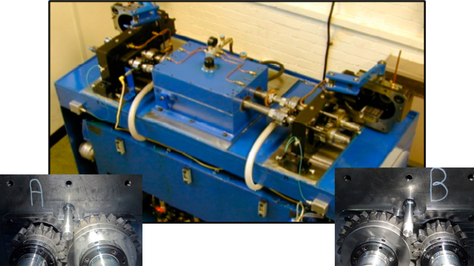

To study the sensitivity of gear surfaces to micropitting, contact fatigue tests were carried out on the back-to-back test rig (Figure 1) developed by Design Unit. This is a gear test rig in an initially closed mechanical loop. This test rig allows two identical gears to be tested simultaneously under the same loading conditions.
Figure 1—Back-to-back test rig (91.5 mm center distance).

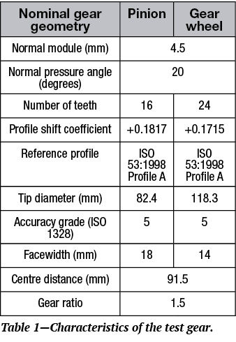

Table 1 below summarizes the macrogeometric characteristics of the test gear teeth. It should be noted that this is the most studied gear geometry in the literature on gear contact fatigue using this type of test rig.

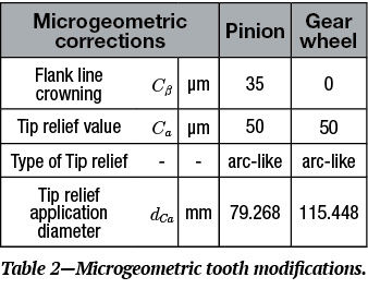

Microgeometric modifications (profile and flank line modifications) are introduced at the teeth of the studied gear to get as close as possible to the definition conditions of industrial gears. Table 2 below summarizes the microgeometric characteristics of the gear teeth used in the tests.
It should be noted that the geometric and loading data are based on the two reference documents which describe tests to be conducted on an FZG type test rig (Refs. 16, 17).

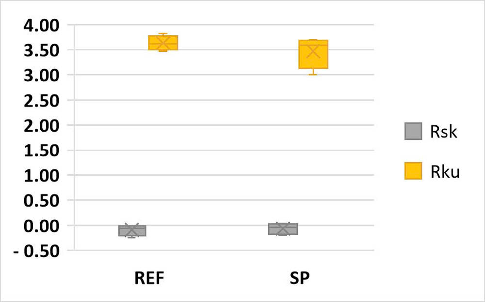

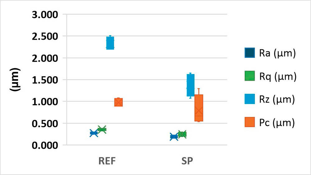

Figure 3—Roughness comparison.

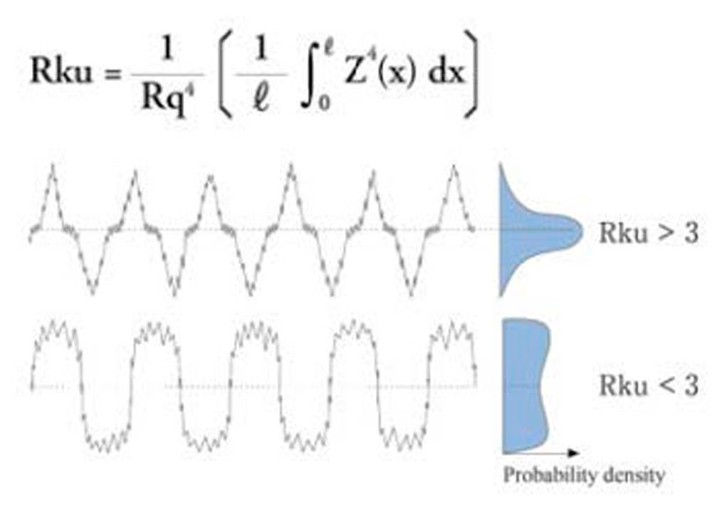

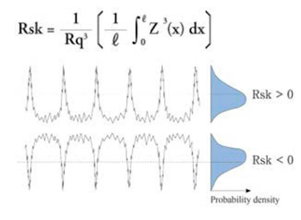

Figure 4—Definition of roughness profile parameters: Kurtosis (Rku) and Skewness (Rsk).

The surface roughness of the flanks of the test gear teeth was measured before testing. The measurements were made on 3 teeth of each gear and on the two flanks of each tooth. The roughness was characterized by white light interferometry using a Bruker noncontact 3D surface roughness machine. The measurement results show that Rsk and Rku have the same orders of magnitude while Ra, Rq, Pc and Rz have lower values on the shot-peened gears (see Figure 3).
We have to remember that Rku describes the peaks shape, and Rsk the presence of peaks or valleys. Based on the diagram in Figure 4, the configuration Rku 3 and Rsk 0 gives logically a surface topography that is unfavorable to the appearance of micropitting. Pc is the mean height of the primary profile element.

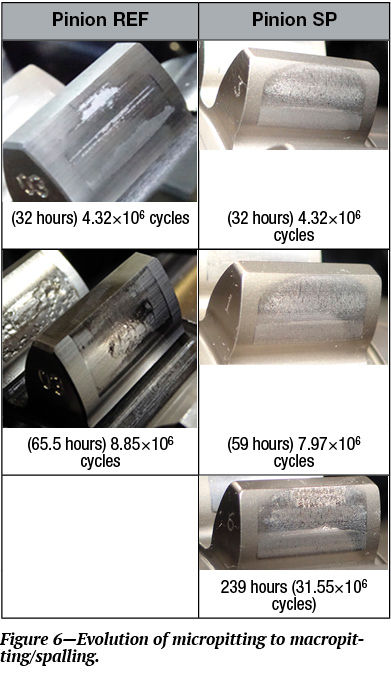

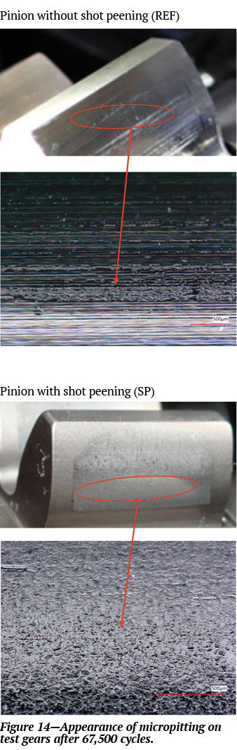

All pinion and wheel teeth are numbered to allow clear identification of damage locations. The test cycle includes stop phases to follow the evolution of the degradation of the active flanks. At each stop, photos of the flanks are taken. The criteria to finish the test is generalized macropitting damage of the active flanks. Photographs of the gear tooth flanks are taken, showing the initial state and after the different loading cycles, enabling observation of the evolution of the damage on the flanks. An example of the results is shown in Figure 5.
For all the tests carried out on the shot-peened gears (SP) and the nonpeened (REF), the micropitting damage on the flanks is initiated in the dedendum zone where the sliding conditions are the most severe.
The observation of the images of the surfaces thus obtained makes it possible to highlight the following points:
  • The micropitting started in the dedendum zone below the pitch diameter of the reference flanks (unpeened) and shot peened (SP) flanks after the same test time or earlier. The micropitting covers a large part of the tooth dedendum on shot-peened flanks.
  • The presence of micropitting around the pitch line of the pinion is also noted, which may have been caused by stress concentration in this area. The occurrence of micropitting is not usual in this area, it is often observed in the tooth dedendum. Similar results have already been obtained in other research from the literature (Ref. 17).
  • For comparable test durations, the micropitting area on the shot-peened flanks (SP) is greater than that on the nonpeened flanks (REF).
  • A difference in the evolution of the micropitting on teeth between REF and SP flanks. Micropitting on REF flanks is progressive.
The tests carried out on gears were conducted until the appearance of Macropitting/spalling on the teeth flanks.
The appearance of spalling on the REF gears was observed after about 8.85×106 cycles of loading (66 hours on average) whereas on the SP gears, macropitting was observed on the pinion after about 28.2×106 (209 hours), the test was conducted up to 32.26×106 (239 hours) but no widespread macropitting / spalling on the flanks was observed.

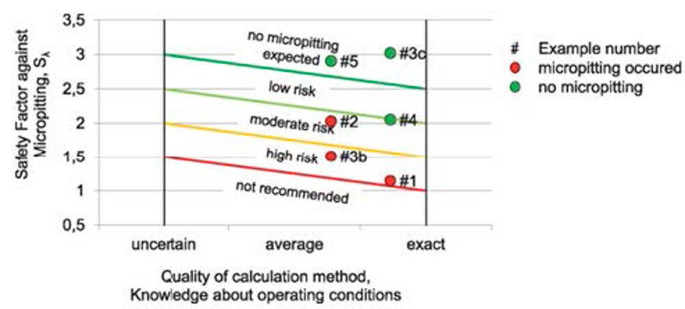

minimum required safety factor
ISO/TS 6336-22 does not give advice on a minimum safety factor that should be applied to avoid the risk of micropitting. Instead, it provides guidance for the selection of its value depending on the qualitative reliability of the assumptions on which the calculations are based and according to the reliability requirements. A recommendation for a reasonable minimum safety factor against micropitting, Sm, is proposed in (Ref. 18) as shown in Figure 7.
Figure 7—Micropitting safety factor according to Ref. 18.

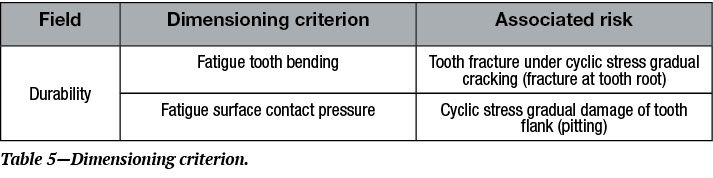

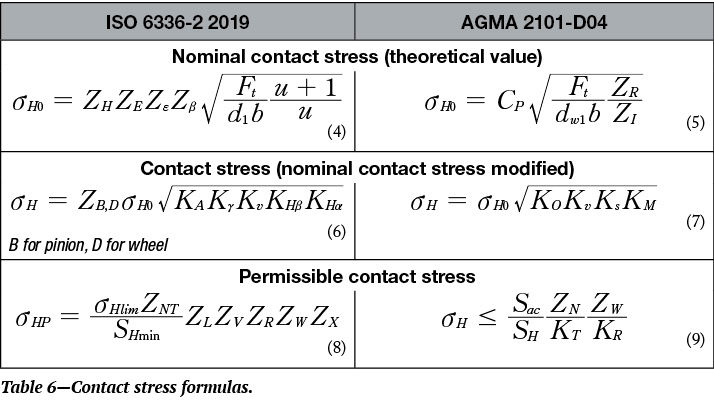

Currently, the most popular standards are ISO 6336:2019 and AGMA 2101-D04, these international methods allow the load capacity of metal gears to be verified by considering the two commonly used sizing criteria:
Generally, these international methods are based on the comparison of applied stresses with allowable stresses.
This calculation is performed using the KISSsoft 2022 software package.
AGMA and ISO design procedures are similar, with minor variations, and contain correction factors obtained from experiments and experience, which consider various uncertainties. These methods consider geometric design, material and heat treatment, manufacturing, and operating conditions.
The gear contact stress calculation is based on the Hertz theory, the formulas of maximum contact stress and the permissible contact stress for the two standards are presented below:
Where:
vH0            is the nominal contact stress
vH            is the calculated contact stress
Ft            is the nominal tangential load
u            is transmission ratio
ZH             is zone factor
ZE            is elasticity factor
Zf             is contact ratio factor
Zb            is helix angle factor
Cp            is elastic coefficient
dw1            is operating pitch diameter of pinion
ZI            is geometry factor for pitting resistance, ZI plays somewhat the same role as the combination of the terms: (u+1)/u, Zf, Zb of ISO
d1            is pitch diameter of pinion
b            is the facewidth
ZR            is surface condition factor is supposed to take into account the surface condition, the residual stress state and the plasticity effects. At the moment there is no development and ZR =1.
To consider loading fluctuations due to the set-up, the driving and driven elements, the behaviour of the gear pair, the standards add K factors, to transform nominal contact stress in contact stress applied on the tooth flank:
KA            (ISO) is the application factor
KV            (ISO & AGMA) is the gear internal dynamic factor
KHb            (ISO) is the face load factor for contact stress
KHa            (ISO) is the transverse load factor for contact stress
Ko            (AGMA) is overload factor
Ks            (AGMA) is size factor
Km            (AGMA) is load distribution factor
vHP            is the permissible contact stress
vHlim            (ISO), Sac (AGMA is the allowable contact stress number which determines the stress level that can be accepted by the material and its associated heat treatment. It is based on a Wöhler fatigue curve determined experimentally.
In this study, according to ISO, the allowable stress number vHlim was obtained from ISO 6336-5. It is derived from the contact pressure that may be sustained for 50×106 load cycles (for case-hardened steel) without the occurrence of pitting for a one percent probability of damage (99 percent reliability). The AGMA method defines the allowable contact stress value Sac for 107 load cycles with also 99 percent reliability.
SHmin is the minimum safety factor which is to be agreed on between the designer and customer. To consider the condition of the material in relation to the experimentally established data in a different environment the ISO & AGMA methods also introduce corrective factors.
ZNT            is the life factor
ZL            is the lubricant factor
ZR            is the roughness factor
ZV            is the velocity factor
ZW            is the work hardening factor
ZX            is the size factor for contact stress
ZN            is stress cycle factor
KT            is temperature factor
KR            is reliability factor which allows the calculation of the gears for reliability levels other than one failure in 100 at 107 cycles
SH            is safety factor for pitting
The contact stress vH should be less than the permissible contact stress for preventing failure. The safety factor against pitting is defined as the ratio between the permissible contact stress and the contact stress.
The AGMA standard includes the effect of surface condition, but it does not provide instructions or guidance for defining its value.

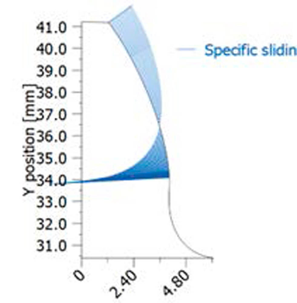

The specific sliding (Figure 8) at the root of the pinion teeth is high (3.75) and exceeds the value generally recommended according to the rules of art (3 in absolute value).
Figure 8—Specific sliding along tooth profile.

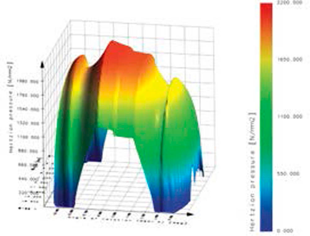

As shown in Figure 9, the maximum contact stresses occur in the pinion flank dedendum between the single contact point B and the pitch point C, when it meshes with the wheel addendum. The contact stress results reveal that micropitting can start in the pinion flank dedendum between point B and point C as this area is subject to a high level of contact pressure stresses.
Figure 9—Distribution of 2D and 3D contact pressures.

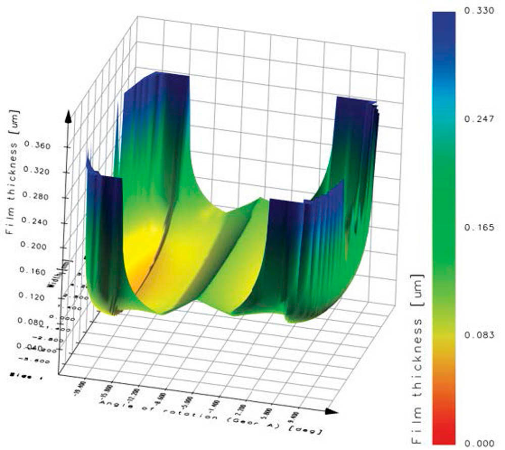

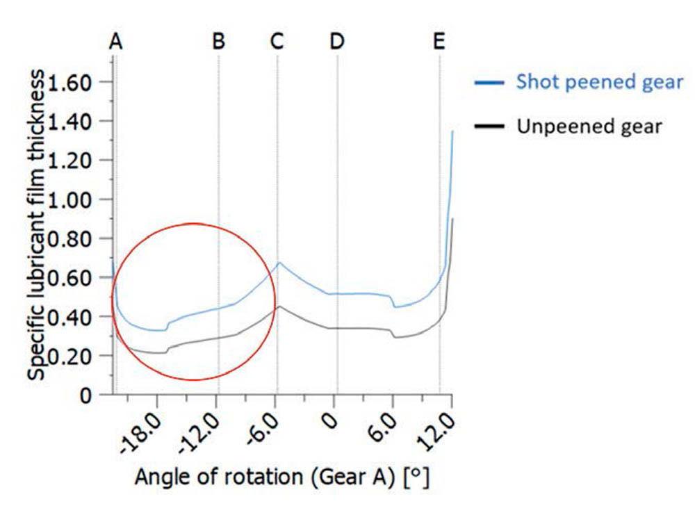

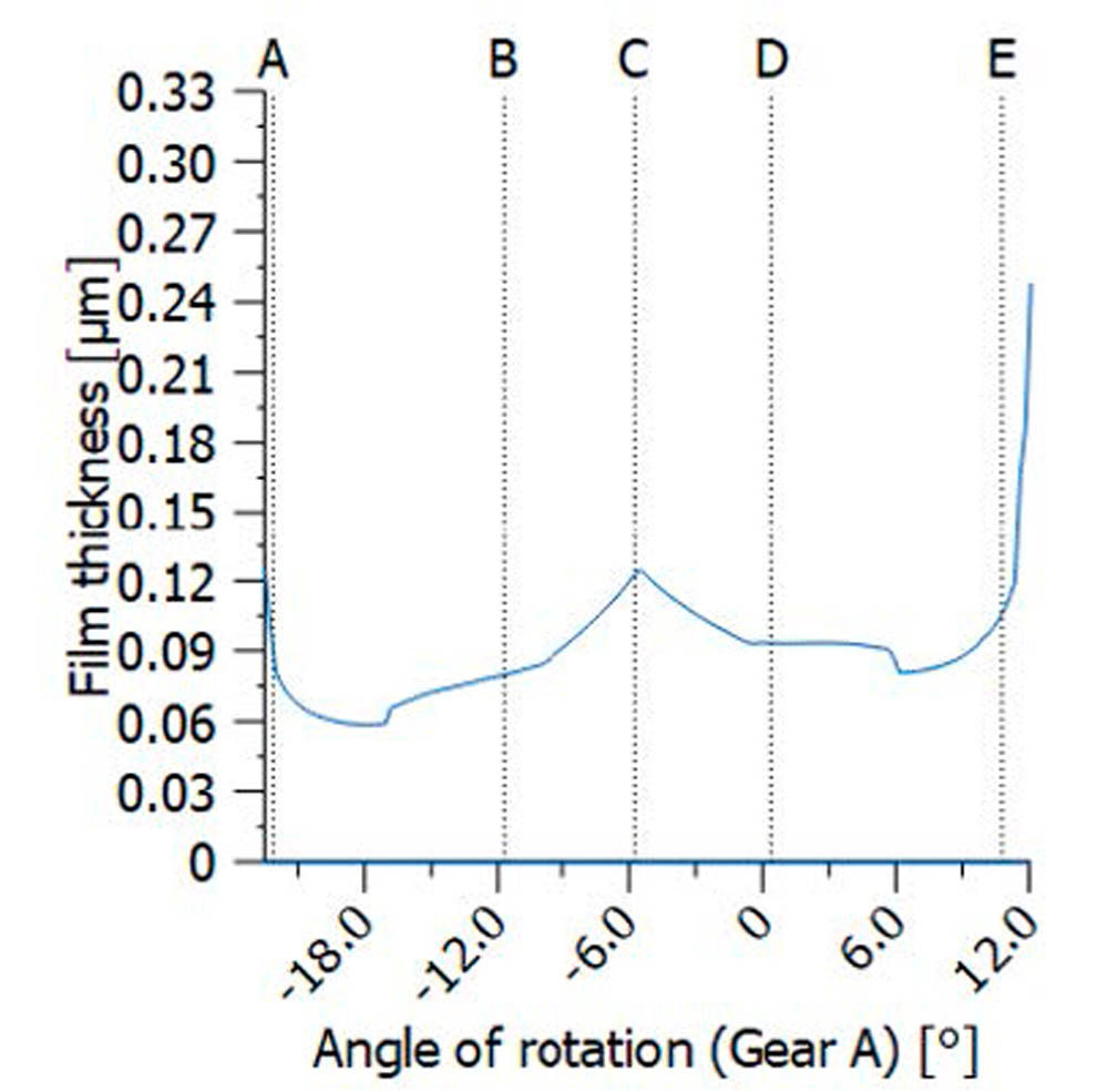

Figure 10 shows the variation of the lubricant film thickness along the tooth flank in a meshing cycle; this local thickness is derived from the Dowson and Higginson equation adopted by ISO/TS 6336-22.
As shown in Figure 11, the specific thickness of the lubricant film varies along the tooth flank during meshing, and the maximum film thickness occurs at the pitch point C due to pure rolling. The area between the start of the meshing A at the root of the pinion and the single contact point B presents the greatest risk of micropitting due to the lower lubricant film thicknesses accompanied by high-pressure contact stresses (Figure 9) compared to the other contact points along the line of action.
Figure 10—2D and 3D lubricant film thickness according to ISO 6336-22.
Figure 11—Comparison of specific lubricant film thickness.
The results obtained in terms of the specific lubricating film thickness m highlight the following points:
  • The unpeened (REF) and shot peened (SP) gears operated in a boundary lubrication regime (m
  • It can also be seen that the shot-peened gears have a higher m (Figure 11), as they have lower Ra values than the unpeened gears.

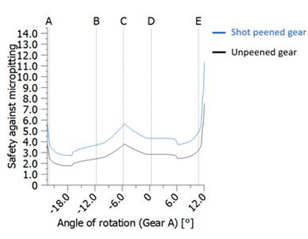

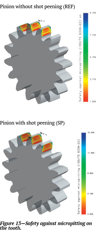

Figure 12 and Figure 15 show the safety of the gears against the micropitting according to ISO/TS 6336-22. The safety of the REF gear is lower than that of the SP gear because it has a lower local specific lubricant film thickness.
Figure 12—Micropitting safety on the path of contact of gears according to ISO 6336-22:2018.
Therefore, from the experimental tests conducted in this study, the ISO results of the specific lubricant film thickness provide a good correlation with the occurrence of micropitting on the tooth flanks, an example of the occurrence of micropitting on test gears is shown in Figure 14.

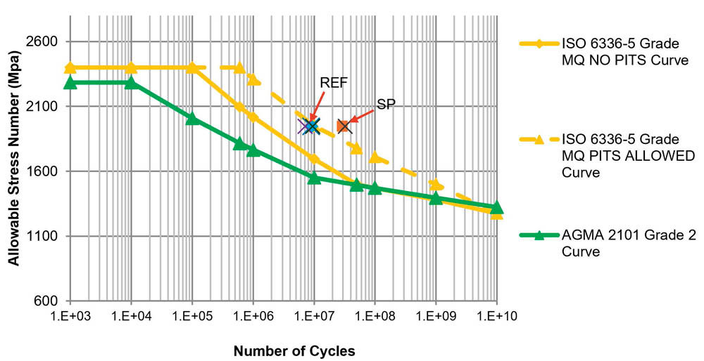

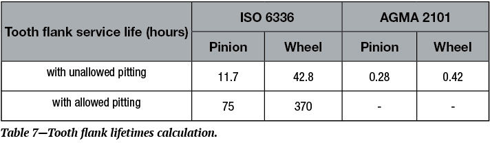

The theoretical lifetime of the gear is calculated according to both methods ISO 6336-2 and AGMA by calculating the number of cycles which leads to safety factor of 1.
The gear lifetimes obtained are presented below. The SHmin and SH are considered equal to one.
It should be noted that for all the tests carried out on the REF gears (unpeened) and shot peened (SP), no bending fracture at the tooth root was observed.
According to the ISO standard, the number of load cycles for the one percent probability of appearance of the first pitting on the pinion is 1.58 × 106 cycles (11.7 hours) and that for a generalized pitting is 10.12 × 106 cycles (75 hours). This correlates with the experimental results observed on case-hardened gears after 8.8 × 106 load cycles. The number of pitting cycles for the different tests is plotted on the Wöhler curves at the corresponding contact pressure corresponding to the nominal operating torque as shown in Figure 15.
Figure 15—Wöhler curves comparison of pitting cycles.
However, when comparing the lifetime calculated according to the standards with that obtained experimentally on the shot-peened gears, macropitting occurred after 27.56 × 106 cycles. The service life has increased by approximately 60 percent. This improvement can be explained by the increase of residual compressive stresses into the surface layer after the shot peening treatment.
The ISO standard considers the effect of shot peening on the improvement of the bending strength at the tooth root of carburized case-hardened gears. The benefit values attributed to shot peening are:
ML — 0 %
MQ — 10 %
ME — 5 %
But this standard does not consider this positive effect of the increase of the residual compressive surface stresses via the application of shot peening on the resistance to macropitting, which makes the gears load capacity calculations conservative.

High safety factors according to ISO 6336-22 (>2) do not indicate the absence of micropitting as demonstrated by the test results. These observations agree with those made by Olson et al. (Ref. 19).
Shot peening did not delay the appearance of micropitting on gears but its evolution to macropitting/spalling. The shot peening has increased the life of the gear against pitting by more than 50 percent. This improvement introduced by residual surface stresses due to shot peening is not considered in the current standard calculation methods.
