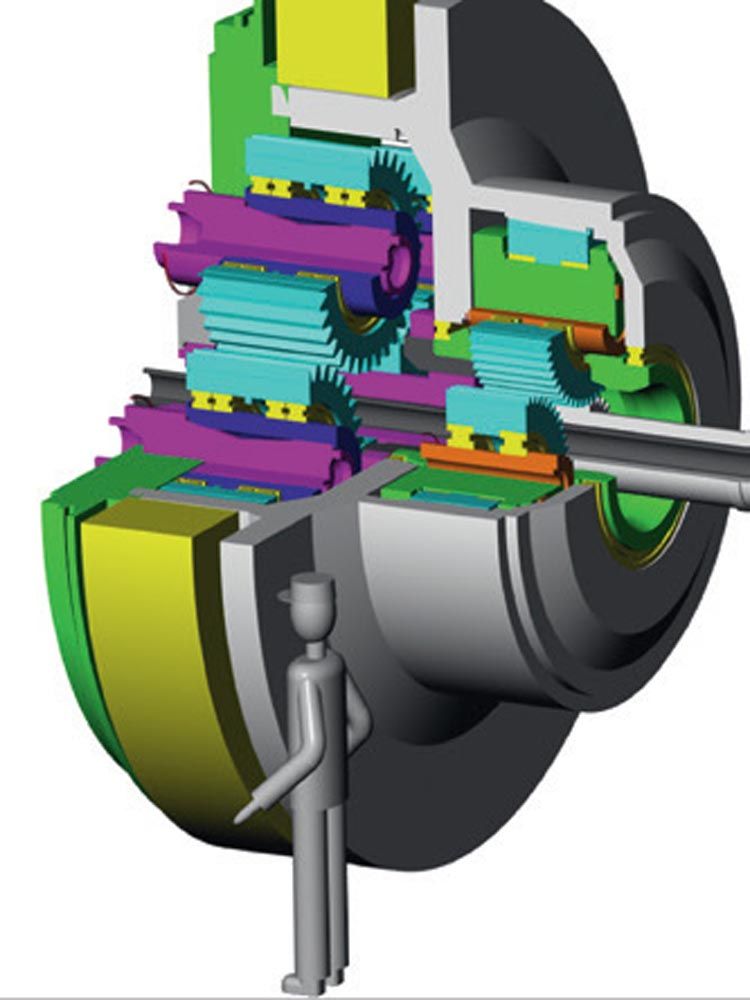

Figure 1—Top: Example 8 MW MGB with five planets, supported on flexible planet pins in LSS and conventional ISS (yellow body represents the turbine main bearing). Bottom: Service life of a planetary stage as a function of ratio and number of planets (Ref. 8).
Designs with a high number of planets face three major design challenges: 1) load sharing among the planets 2) load distribution along the planet’s face width 3) space for the carrier. The first two problems are related to the third in that since there is not much space for the carrier, it becomes soft, resulting in a larger misalignment of the planets concerning the sun gear and the ring gear. The solution presented here to tackle all three problems at once is using a single-walled carrier and cantilevered planet pins. The planet pins are of the “Flexpin” type, as invented and patented by Ray Hicks (Ref. 16). Such a design allows for a higher number of planet pins projecting from a flange, while each pin supports a planet gear for orbital rotation about the gearbox axis. No space is required between the planets for the connecting pieces connecting the two flanges of a conventional planet carrier design and planet outer diameters may nearly touch. As a simple rule of thumb use the credit card approach: if you can fit a credit card between the tip diameters, you should be fine. The simple construction of the single-wall carrier accommodates a larger number of planet gears, and hence the planetary stage will handle a proportionately larger torque. The condition is that the tilting of the planets due to the pin bending is managed properly. This paper focuses on “proper management.”
Number of Planets and Load Sharing

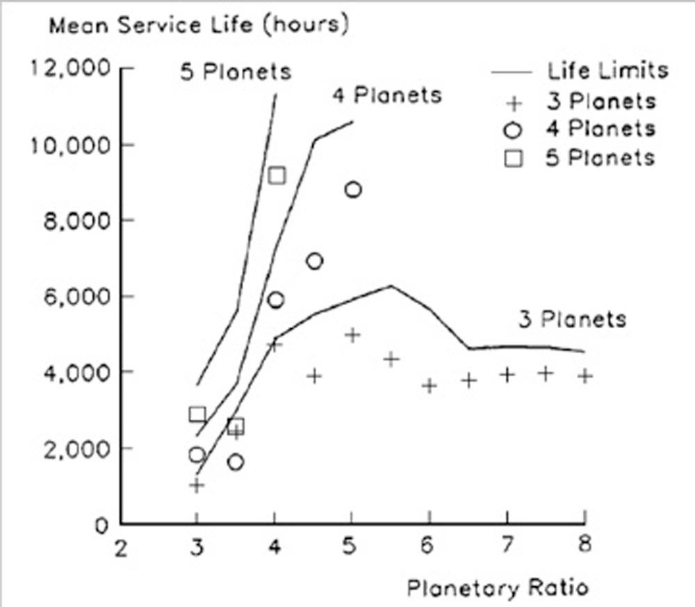

The basic design problem to solve in planetary gears is to ensure near-equal load sharing among the multitude of planets. A perfect power-split is not achieved and the level of unevenness in the power-split is highly dependent on machining accuracy and system elasticity. The load sharing among the planets gets worse with a higher number of planets, sometimes such that increasing the number of planets does not result in an overall higher power or torque capacity anymore. The load sharing among the planets is expressed by the mesh load factor Kγ in gear design and rating, e.g., along ISO 6336. The mesh load factor or load sharing factor Kγ is defined as Kγ = max(Ti) / average(Ti) where Ti is the torque transmitted through each planet or load path. The minimum value of Kγ is Kγ_opt = 1.00, meaning that each planet takes the same load. Typical Kγ values for planetary gear stages are in the range of 1.10 to 1.25. Kγ is used in the gear rating for all failure modes (e.g., scuffing, micropitting, tooth flank fracture, pitting, bending, etc.). Recommended design values are listed in Ref. 7 and shown below. They tend to be conservative when compared to tests.
A study (Ref. 10), on the combined influence of the number of planets, torque levels, and the carrier pinhole position errors on planet load-sharing and gear root stresses confirmed that a floating three-planet gear set has near-equal load sharing, regardless of the manufacturing error values. It also confirmed that the planet loads and gear stresses are sensitive to the carrier pinhole position errors. Other studies, e.g., Refs. 11–15, confirm the trends and to some extent the numerical values shown above.

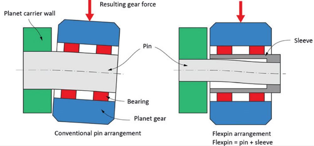

Figure 2—Working principle of the Flexpin arrangement (right). Conventional pin arrangement in single-walled carriers (left). Planet gear (blue) supported in a single-walled carrier (green) does not tilt if Flexpin (grey for the pin and dark grey for the sleeve) is used (right). Planet gear (blue) does tilt if a simple cantilevered pin (grey) is used (left).

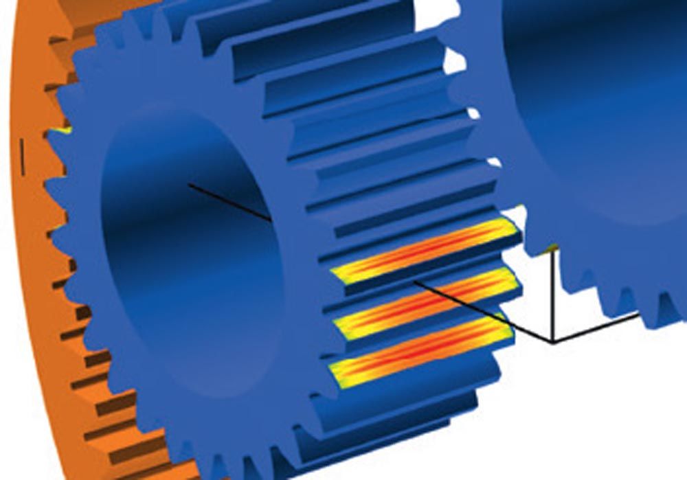

Figure 3—Contact stress distribution on planet tooth in mesh with the sun (not shown). Note gradient (left) and symmetry (right) in contact stress along the face width. Left: Conventional pin arrangement. Right: Flexpin arrangement. Compare to Figure 2 above.

Second, to the mesh load factor Kγ, the face load factor KHβ is considered in the gear rating, e.g., along ISO 6336. It describes the evenness of the load distribution along the face width in the mesh between the sun and planet and planet and ring gear. If the load along the face width is evenly distributed, then, KHβ = 1.00 applies. KHβ is defined as the maximum value of the line load width, divided by the mean value, KHβ = max(w) / average (w). Since the Flexpin results in a movement of the planet parallel to the gearbox axis (see Figure 2, right), the load distribution remains symmetric to the planet’s face width and hence optimal (see Figure 3, right). The resulting KHβ are then typically KHβ = 1.15 and the modifications applied on the planets are only a slight flank line crowning.

The single-wall carrier in combination with the concept of mounting the planet gears on Flexpins gives the design high reliability (because the contact between planet and sun flank and planet and ring gear flank remains near optimal for different torque levels) and high torque capacity (because of the elevated number of planets). Numerous gearbox designs for wind turbine MGBs using Flexpins exist. However, it must be said that the use of the Flexpin concept is not used in high numbers. Most of the leading MGB OEMs companies do not use the Flexpin in their design; this is a strong indicator against the use of the Flexpin for standard gearbox designs. It means that there are probably good reasons not to use Flexpins in a conventional gearbox design and this means that the advantages and disadvantages of the Flexpin design must be carefully considered.

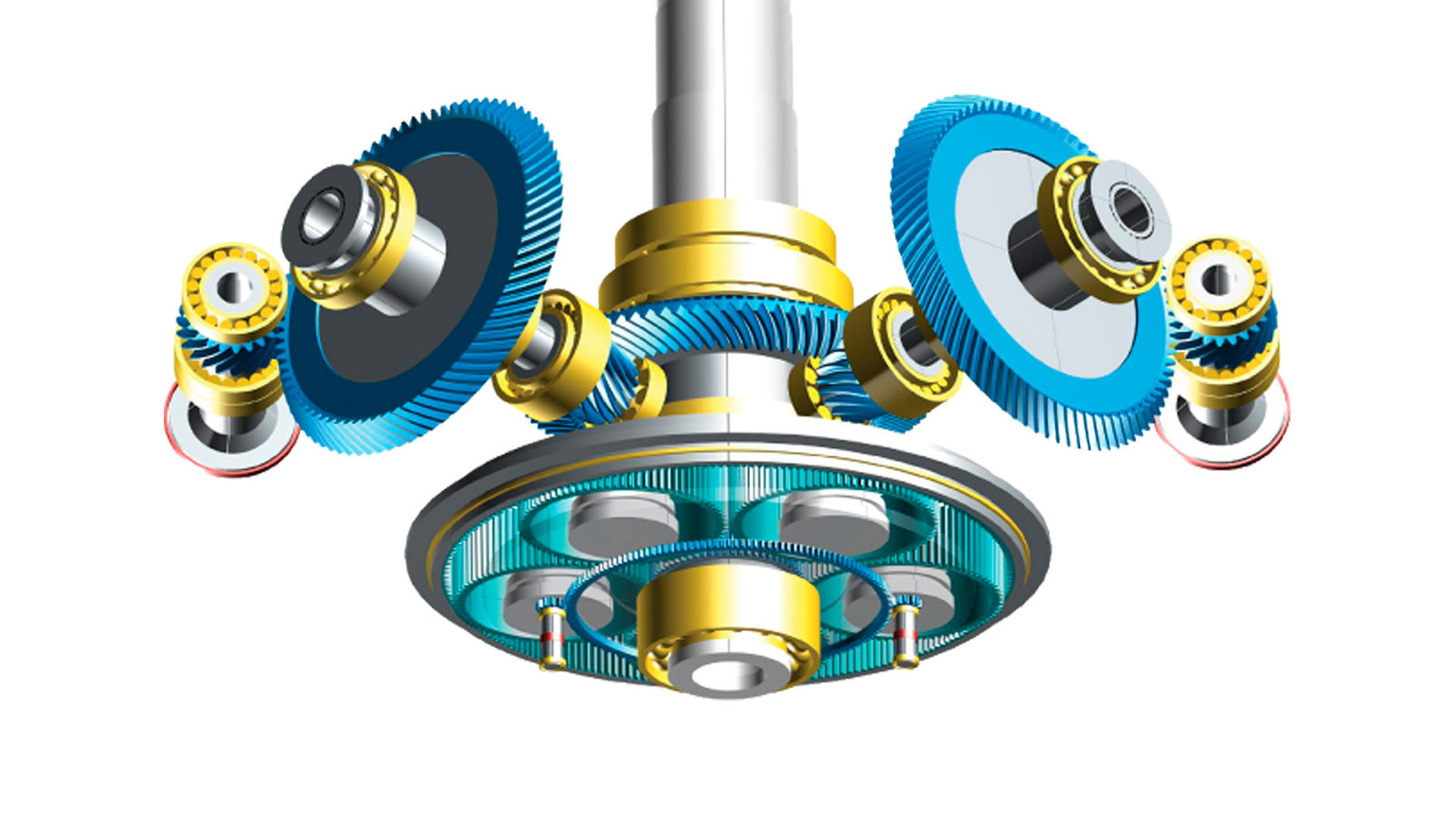

Figure 7—Top left: Gearbox design by MAAG (Ref. 17), believed to be the first wind turbine MGB featuring Flexpins. Top right: Design of a wind turbine MGB using Flexpins, having a compound planetary arrangement (sun gear of second stage connects to the ring gear of first stage (Ref. 19). Bottom left: SCD gearbox designed by the author (Ref. 9). Bottom right: Planetary stage with seven planets, 7 MW wind turbine MGB by WIKOV (Ref. 18). Flexpin highlighted in cross-sectional images.
