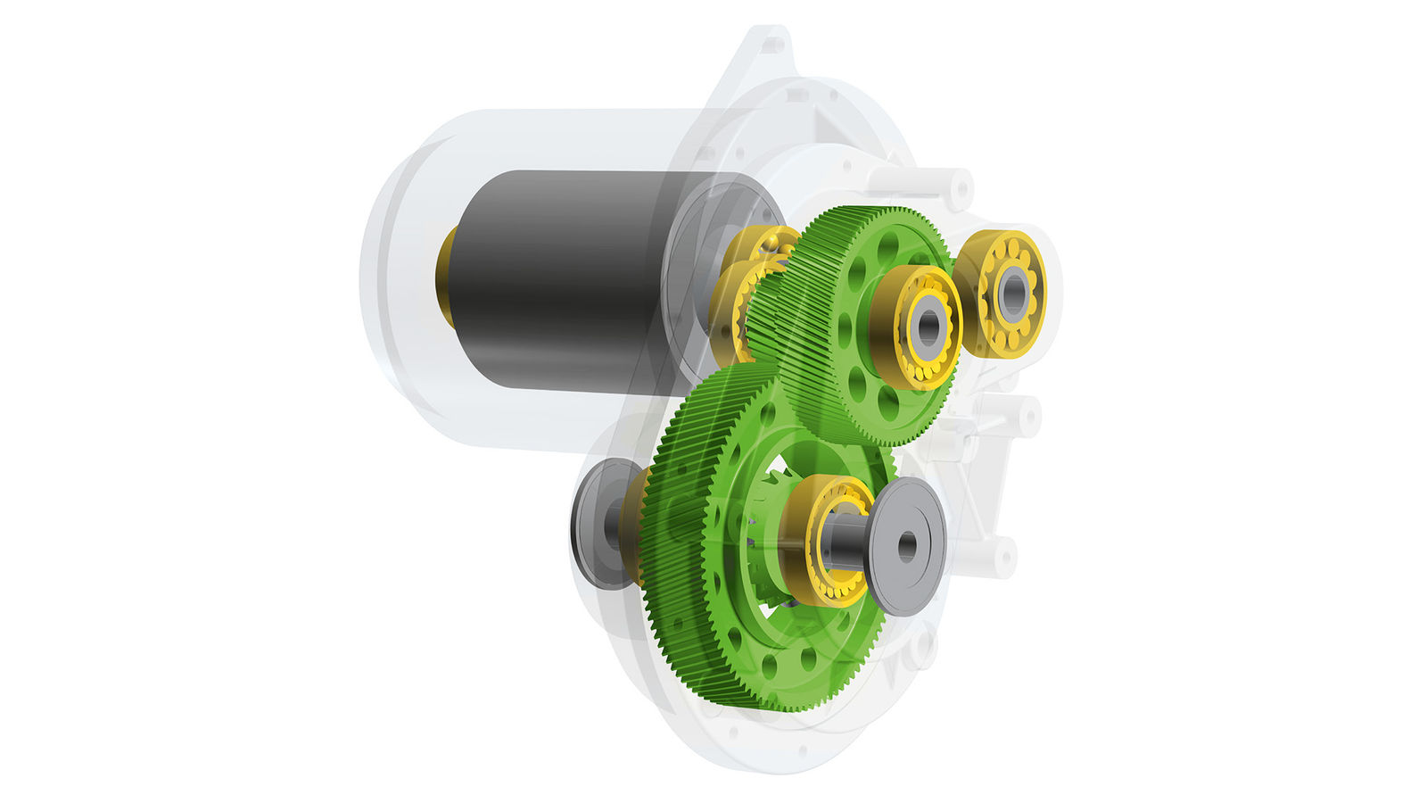

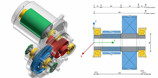

Manufacturing follows the design stage. Many design engineers assume that this step requires little attention. However, this can lead to problems, additional costs, or delays later. Figure 1 shows an example of a typical two-stage EV drive. The idler shaft has two gears, and the original idea was to manufacture it as a single piece. However, the pinion of the second stage is very close to the gear of the first stage. Hobbing teeth on the pinion in this position is not possible. Power skiving may also be unsuitable because optimal process parameters might not be achievable. One possible solution is to mount the gear after the pre-finishing step. Because of precision and noise requirements, the finishing step should be performed with the gear mounted. The same challenge arises for applying honing processes, as there is very little space available.
Even this simple design poses challenges for manufacturing and process engineers. This highlights the importance of considering manufacturing early in the design stage. It is not necessary to define every detail at this stage, but sufficient consideration should be given to avoid common manufacturing pitfalls.

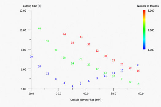

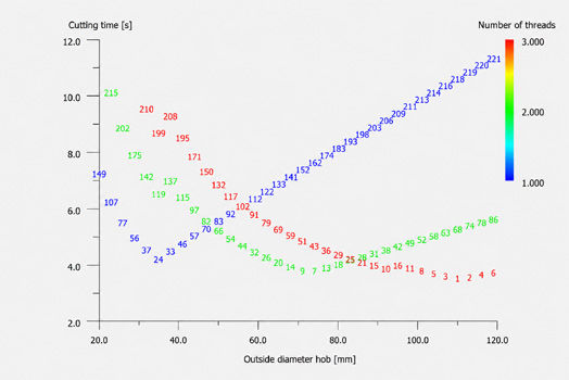

The built-in fine-sizing function of the hobbing process module systematically varies the outer diameter, the number of threads, and the number of gashes. It checks compliance with gear quality requirements, including the generation of flats and feed marks, as well as interference conditions. It then estimates the cutting time and usable tooth length. Figure 2 shows the resulting solutions, identified by their index in the results table, plotted as cutting time versus outer diameter, with the number of threads indicated by color.
Figure 2—Cutting time versus hob outer diameter, for one-, two- and three-threaded hobs.
For a given number of threads, increasing the outer diameter results in a higher number of gashes, allowing a larger axial feed rate. On the other hand, a larger diameter combined with a fixed cutting speed results in a lower rotational speed of the tool and the gear. A larger diameter also increases the approach distance. As a result, there is an optimal diameter that achieves the shortest cutting time.
More threads typically require a larger diameter because the number of cutting edges per gear tooth equals the number of gashes divided by the number of threads. To achieve the required quality, more gashes are therefore necessary. This explains why the solutions with two and three threads are shifted to the right. They show the same trend: increasing axial feed and decreasing cutting time as the outer diameter of the tool increases. However, because of the defined interference conditions, the maximum possible tool diameter is reached before the optimal cutting time is achieved. In this case, a single-thread hob results in the shortest cutting time.
To illustrate the general trend more clearly, Figure 3 shows the fine-sizing results for the same case, but without any interfering features. Optimal hobs with two and three threads are also feasible and appear among the possible results. In this case, they would slightly reduce the cutting time, with an estimated reduction of about 10 percent.

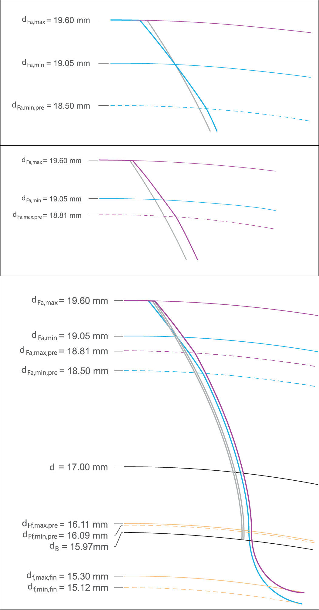

Figure 4 shows an example of such a rollout graphic with the maximum and minimum material conditions. To make the details easier to see, the upper-left section shows only the tip area for the minimum material condition, while the upper-right section shows the same area for the maximum material condition. Two profiles from the pre-finishing step are shown: the maximum-condition profile is pink, and the minimum-condition profile is light blue, with the defined stock tolerance between them. The two gray profiles on the left are involutes corresponding to the grinding step, and the finished tooth-thickness tolerance determines the distance between them.
Figure 4—Rollout graphic for the whole profile (bottom), the tip area in minimal stock tip condition (top), and the tip area in maximum stock condition (middle).
This example shows a gear with a tip chamfer generated during pre-finishing with a semi-topping tool. The finishing step removes part of the chamfer. The point at which the chamfer begins on the profile defines the tip form diameter.
The tip form diameter decreases as less material is removed during finishing. Accordingly, the minimum-stock condition determines the minimum tip form diameter, shown in the figure as the light-blue solid circle. The dashed circle indicates the start of the chamfer on the pre-finished tooth form and is included for reference.
The maximum stock condition, which corresponds to the greatest amount of material removed during finishing, results in the largest tip form diameter. In this case, the entire chamfer is removed, so the tip form diameter coincides with the gear’s tip diameter. Assessing these extremes is critical because variations in the tip form diameter can affect tooth contact, load distribution, and overall gear performance.
The permissible limits for the tip form diameter depend on the specific application. A smaller diameter may reduce the transverse contact ratio. However, if too much material is removed, as in this case, the chamfer may be eliminated. Ultimately, the designer must define the appropriate range of values.

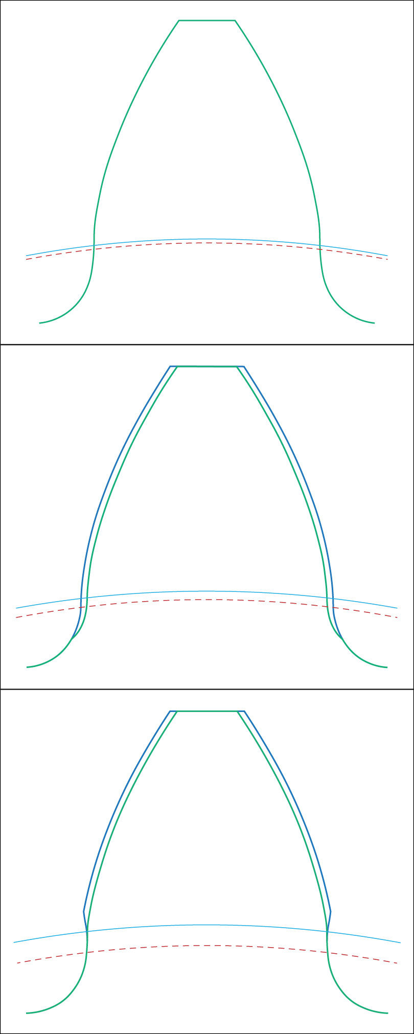

The root form diameter can be generated in three different ways, shown from left to right in Figure 5. The left subfigure shows a tooth generated in a single step without pre-finishing. As the root is generated, the tip of the tool creates the trochoid in the gear’s root area. The point at which the involute and the trochoid intersect defines the root form diameter.
Figure 5—Three different situations that define the root form diameter: Single manufacturing step (top), pre-finishing and grinding (middle), pre-finishing with protuberance tool and grinding (bottom).
The middle subfigure illustrates a process consisting of a pre-finishing hobbing step followed by a grinding step. The grinding disk or worm removes material along the flank down to the root, to a specified diameter determined by the grinding depth. At this point, the generated involute ends, thereby defining the root form diameter. Below this point, a grinding notch is created. Its rounding radius may be significantly smaller than that of the root area itself. This can reduce the tooth’s bending strength because of additional stress concentration and the removal of the highly compressive residual stresses created during heat treatment. To avoid the grinding notch, an artificial undercut can be added. This is produced with a protuberance tool that has a section at the tip with a smaller profile angle. The resulting shape is shown in the right subfigure. The blue tooth profile represents the pre-finishing step with the undercut. The grinding step then removes most of the undercut, and the rounded tip of the grinding disk finishes outside the gear material, while still within the undercut area.

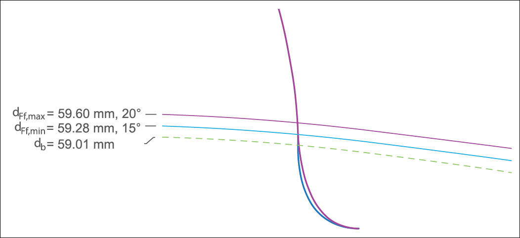

If the SAP is smaller than the root form diameter, a short-lead tool may provide a solution. A short-lead tool has a smaller profile angle than the nominal pressure angle of the gear. To generate the same involute while preserving the base circle, the tool module must be adapted so that the tool’s base pitch matches that of the gear. This adjustment results in a different lead, which is why such tools are called short-lead tools. Figure 6 compares the root produced with a 20-degree tool and a 15-degree tool. The red tooth form and pink root-form circle are produced with the 20-degree tool, while the blue tooth form and blue circle correspond to the 15-degree tool. The root of the blue tooth has a significantly smaller rounding radius. This provides more space for the involute to extend closer to the base circle, shown as the green dashed circle, before transitioning into the trochoid. As a result, the blue root-form circle of the 15-degree tool lies below the pink root-form circle of the 20-degree tool. Because the short-lead tool has a smaller rounding radius, the root strength is lower with the 15-degree tool than with the 20-degree tool. This can be compensated for by increasing the hob tip radius, which is feasible due to the smaller profile angle. However, a larger tip radius also increases the root form diameter, so an appropriate compromise must be found.
