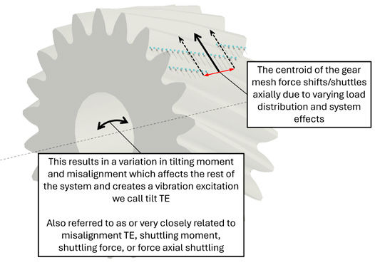

Linear or transverse TE is widely recognized as one of the main sources of gear whine noise. In contrast, tilt TE is less frequently discussed and is referred to by different terms, such as force axial shuttling, so it is worth clarifying, see Figure 2. Tilt TE results from the slight axial movement of the centroid of the gear mesh force as the gears rotate through the mesh. This axial shift arises from the varying load distribution along the lines of contact and is also influenced by the rest of the system, such as other gear meshes and bearing stiffnesses. By solving the entire system in the gearbox transmission error (GBTE) analysis at each rotational step, with all components accurately phased, these variations and interactions are effectively captured.

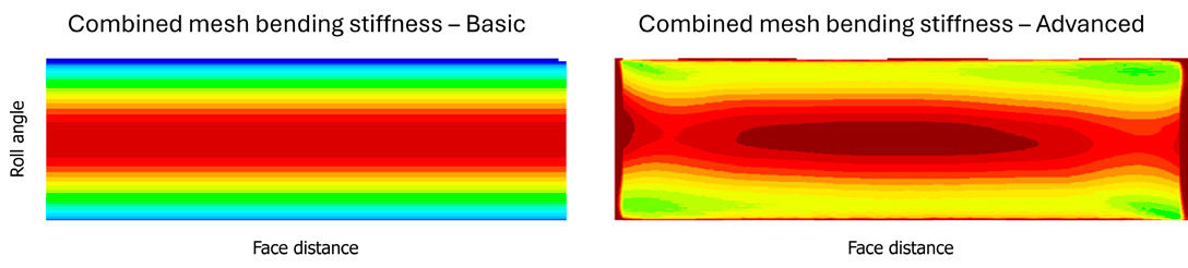

Similarly, the Advanced tooth stiffness model captures more effects than the Basic model, see Figure 3. Specifically, the material coupling within a single tooth captures Poisson’s effect, which causes the tooth to assume an anticlastic curvature that alters the load distribution and can result in peaks towards the side edges if insufficient lead crowning or end relief is applied. Coupling between adjacent teeth can cause peaks near the tip and root due to the highest-loaded teeth deflecting more, increasing the load on the teeth that are just coming into or out of contact, especially at the corners where contact starts or ends.

Considering these effects not only impacts the load and stress distribution, but also influences the mesh stiffness, which is a crucial part of the TE calculation. The combined mesh bending stiffness from the Basic model is a relatively simple curve that is constant across the gear face width. In contrast, the combined mesh bending stiffness from the Advanced model is more complex and varies with face width, see Figure 4.

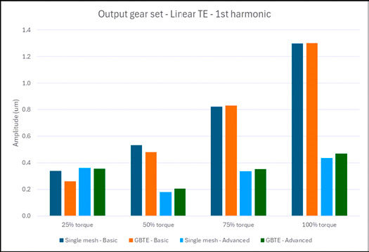

The initial results compare the first harmonic of linear TE from the output gear set across a range of torque levels, see Figure 6. These results highlight the difference in linear TE between the Basic and Advanced tooth stiffness models. At low torque, the differences are small, while at higher torque, the Advanced model predicts significantly lower linear TE. Further investigations, not shown here, indicate that this discrepancy largely stems from the variations in combined mesh bending stiffness mentioned earlier.
Figure 6—Linear TE comparison.
While the difference in linear TE between single mesh LTCA and GBTE analysis is relatively minor, the GBTE analysis uniquely predicts tilt TE, which the single mesh analysis does not account for and is therefore effectively zero. Similar to linear TE, tilt TE predicted by the Advanced tooth stiffness model is lower than that predicted by the Basic model, as illustrated in Figure 7.

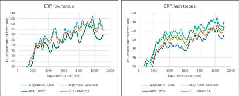

To assess the significance of these differences and the impact of considering tilt TE, the vibration and acoustic response can be studied. The subsequent results compare the housing equivalent radiated power (ERP) at high and low torque levels, which indicates the acoustic radiation from the gearbox housing. In addition, a comparison is made between GBTE analysis, with and without tilt TE, and single mesh LTCA, see Figure 8.
Figure 8—ERP comparisons with and without tilt TE included.
GBTE analysis with only linear TE and single mesh LTCA yields very similar ERP at both low and high torque, using both the Basic and the Advanced tooth stiffness models. However, the full GBTE analysis, incorporating both linear and tilt TE, consistently shows higher ERP. This suggests that the main difference in ERP between single mesh LTCA and GBTE analysis is due to the inclusion of tilt TE excitation. In regions with larger discrepancies between the two methods, certain modes are more easily excited by tilt excitation, which can be analyzed further and mitigated if needed.
A comparison of ERP for the four combinations of types of analysis and tooth stiffness models is presented in Figure 9.
Figure 9—ERP comparisons of all 4 combinations for low and high torque.
The single mesh LTCA with the Advanced tooth stiffness model yields the lowest ERP, while the GBTE with the Basic tooth stiffness model results in the highest ERP. The most accurate combination, the GBTE analysis using the Advanced tooth stiffness model, falls between these two extremes. Additionally, it is worth noting that at low torque levels, the difference between Basic and Advanced tooth stiffness is relatively minor, corresponding with earlier observations from the TE comparisons.
