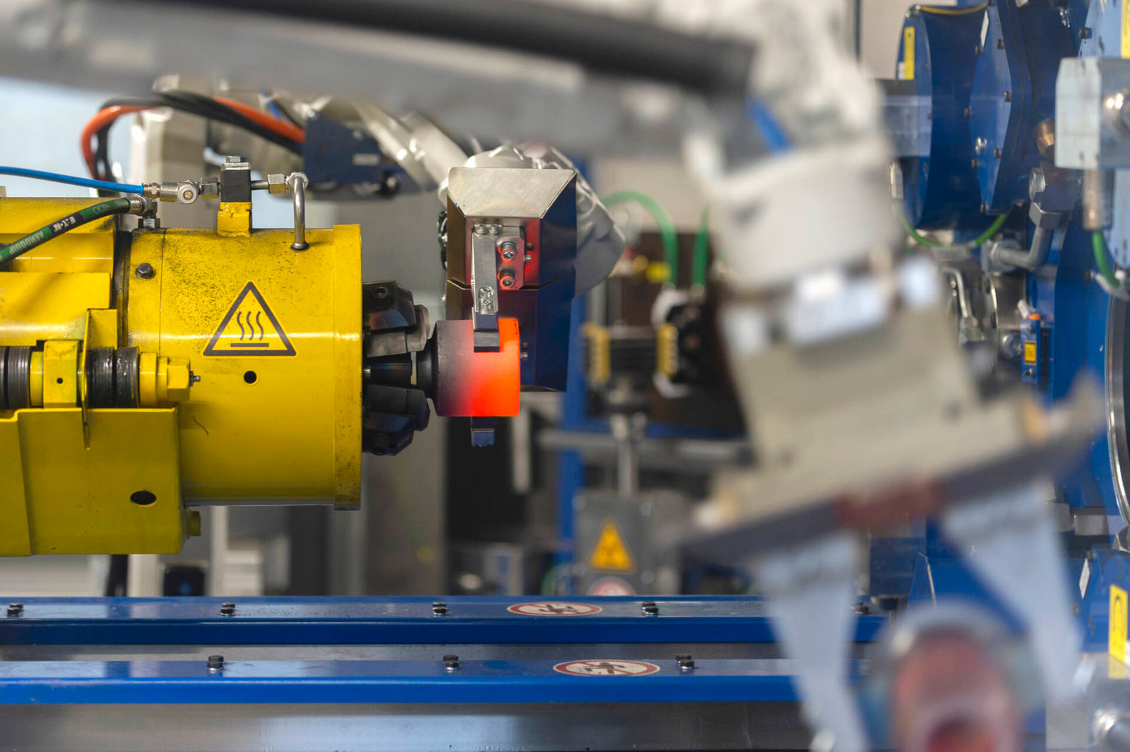

Each forging temperature involves a trade-off. Hot forging fills complex die cavities well but needs heavy machining stock and holds looser tolerances. Cold forging holds tight tolerances but fights high forming loads and limited formability. Warm forging of spiral bevel and helical gears runs in the 873 to 1073 K range (about 600 to 800 °C, or 1,110 to 1,470 °F). It lowers flow stress compared with cold work, holds better dimensional accuracy and surface finish than hot work, and produces a flashless near-net shape that cuts finish machining.
The hard part is filling the tooth lead on a helical gear. Producers handle it with floating-die actions, multi-axis pressing, and FEA preform optimization that sorts out material distribution before the finishing blow.
