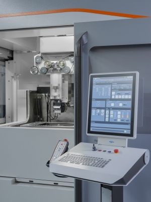

The new Uniqua human/machine interface (HMI), available for the CUT P Pro and the CUT X series, capitalizes on more than a century of EDM technology, with optimal functionality and ergonomics in a 19" vertical touchscreen, full keyboard and mouse. It is designed for every skill level, every approach and every user. For the utmost compatibility, Uniqua supports legacy file types from various EDM manufacturers. It also creates, imports, modifies and executes sequential (ISO-based) and object-oriented (dynamic) programs from previous versions of VISION and AC CUT. With offline and at-the-machine programming, ISO-based functionality and object-oriented programming, Uniqua provides a powerful graphic tool with integrated CAM and also ensures compatibility with major CAD/CAM programs.

Besides the new HMI Uniqua, machines in the CUT X series are equipped with the new wire circuit. Thanks to the unique twin wire plate, the users can choose between Twin-technology (the main cut being faster with bigger wire, the small corners' finishing with thinner wire), longer autonomy (two identical wires' spools for unattended, longer autonomy) and surface care faster erosion (two wires with identical diameter but different coating, to optimize the speed of the main cut and reduce contamination in finishing passes).
GF Machining Solutions is unique in giving the operator the possibility to work with open or closed guides, thanks to a quick and simple system of interchangeable cartridges. The distance from the guide to the workpiece has been reduced to guarantee the highest accuracy. New X-Technologies in GF Machining Solutions' database place an intense focus on high accuracy, high surface quality and high-speed results. The CUT X features all the latest functionalities of GF Machining Solutions' next generation of wire-cutting EDM machines, like ISPS.
