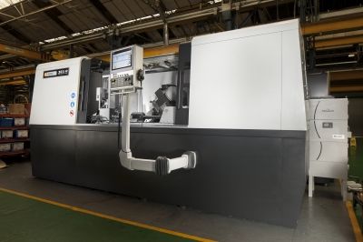

Holroyd EX Series CNC rotor milling machines have earned global acclaim for their high speed, high precision, high levels of efficiency and unrivalled build quality. Delivering class-leading reliability and performance, the EX range begins with the 1EX - a machine capable of milling helical components of as little as 150mm diameter - and offers stepped increases in capability, right up to the 8EX (850mm maximum component diameter) rotor miller. A ‘special order' 10EX machine is also available for components exceeding one meter in diameter. In addition, various bespoke EX models are available.
EX machines cut a full-depth groove by traversing the cutting tool through the material at the relevant helix angle, whilst at the same time rotating the component in the ‘C' axis. Accurate synchronization between the axes is maintained via CNC, with digital drive technology controlling all axis movements. The cutting head is able to remove so much material in one step because the majority of heat generated is transferred to the swarf chips. These are then removed from inside the machine by means of a conveyor system.
The flexibility of EX Series rotor milling machines means they are equally efficient at producing complex components with helical screw profiles, as they are at producing gear parts such as worm shafts. Indeed, in all manufacturing environments they will improve productivity through a combination of high-speed operation, powerful menu-driven touchscreen CNC programming, quick-change tooling, high power spindles and unbeatable rigidity.
