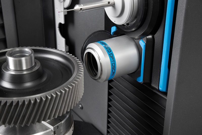

Klingelnberg Precision Measuring Center P 40 with Hybrid Metrology
Klingelnberg will also be presenting the tried-and-tested P 40 precision measuring center with hybrid metrology. Klingelnberg Hybrid Metrology is a smart combination of tactile and optical measuring technology. An optical sensor system developed specifically for gear measurement, as well as the rapid changeover between the 3D NANOSCAN tactile sensing system and the HISPEED OPTOSCAN optical sensor, enable flexible, fast, and highly precise measured value acquisition under all conditions.
