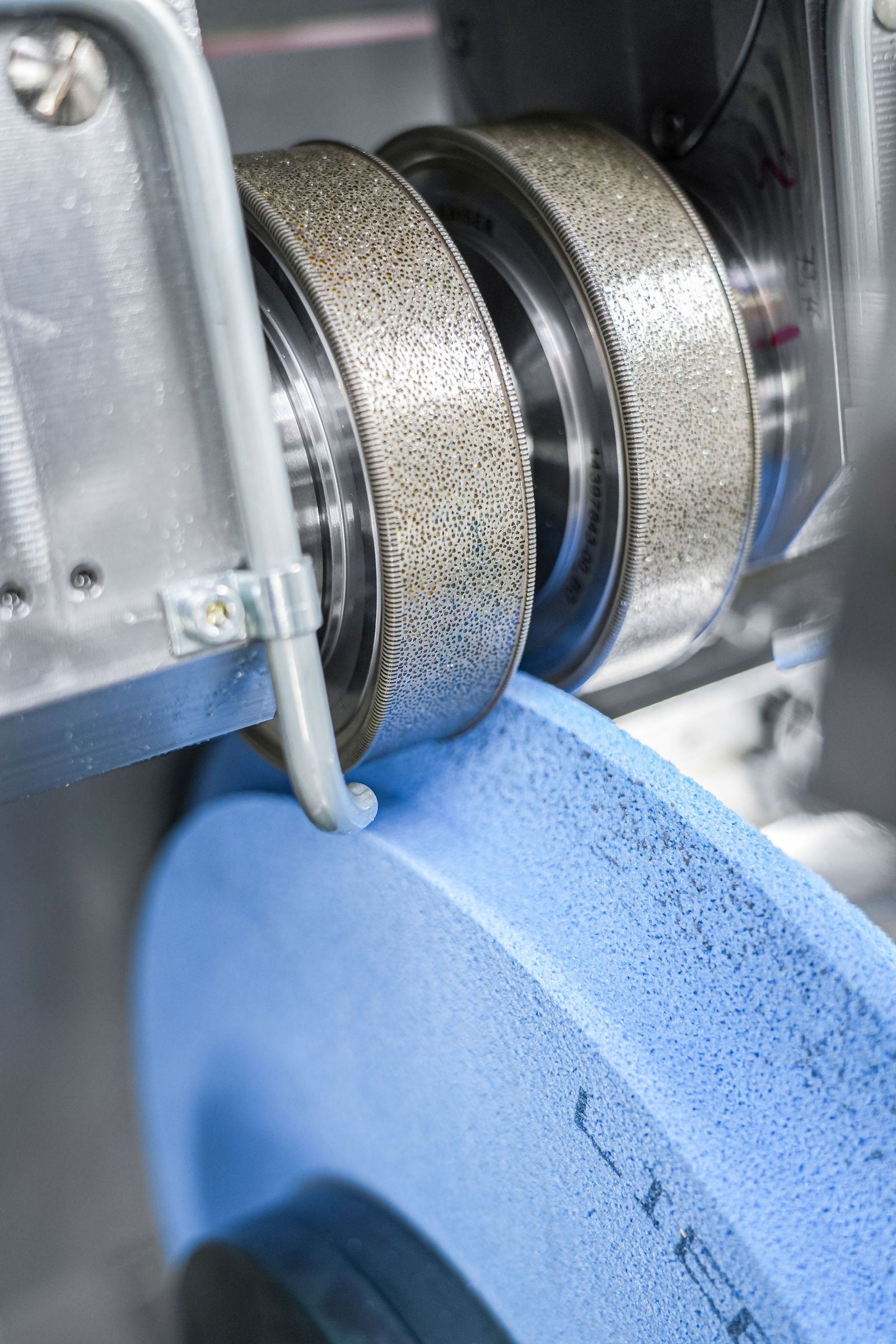

The high-performance PGH 450 FX grinding head allows a targeted combination of two grinding discs with different specifications in the dual-spindle configuration – from roughing and finishing through to fine grinding and polishing. This reduces machining times, increases process stability and lowers the risk of grinding burn. The result is excellent surface quality and high productivity, reducing cycle times by up to 35 percent.
The single-spindle configuration is particularly suitable for frequently changing components. An optional high-speed spindle is available for collision-critical parts, allowing the use of smaller grinding discs, including CBN discs where required. Internal gears can also be machined using optional internal grinding arms for the PGH 450 FX grinding head. Both options can be retrofitted if needed. Additionally, a swiveling probe enables in-machine gear inspection. The LHGearTec control system supports simple and reliable operation with its intuitive interface.
