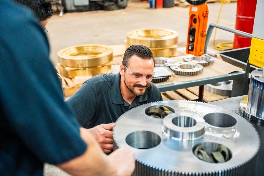

“We’re a specialty gear facility; we see everything come through the door,” said Jonny Wright of Gear Headquarters. “This Hera is the biggest advancement I’ve ever seen our company make, and I love bringing customers in to see it. It’s huge for us because we can process jobs faster and at a higher quality than we ever could before, keeping those customers happier than ever.”
Early results underscore the expansion from one-off, emergency replacement work to repeatable OEM production. Jason Spitzer of Helios Gear Products shared, “There was a part that used to be a 14-hour cycle with multiple cuts and a hob change. We got that down to about 45 minutes, and Jonny stood in front of the machine grinning like a kid on Christmas. I’ll never forget it.”
On the shop floor, Brad Stueve, the newest machinist at Gear Headquarters, added: “We had jobs that took three days on the older machines. Now they take about six hours. The finishes look almost ground-like, and the repeatability is insane.”
