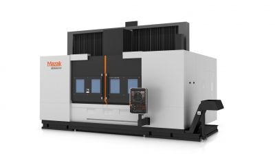

The new Mazak VTC-805E Vertical Traveling Column Machining Center brings high versatility and productivity to those shops that need to tackle long and/or heavy parts. The machine combines an increased Y-axis stroke, long bed/table size, high spindle speed and torque and Mazak's new SmoothG CNC control for efficient, powerful machining.
For manufacturers that need as much Y-axis travel as possible, the VTC-805E provides an extended Y-axis travel of 32" as a cost-effective alternative to a bridge-style machine. The machine's fixed table measures 82.7" x 32.3" (2100mm x 820mm), while its moving column design provides a 69.3" X axis and 28.3" Z axis.
With an optional center partition, it is possible to transform the VTC-805E's table into two separate work areas to process parts on one side, while operators load/unload parts on the other for an overall reduction in cycle times. A special turret-style magazine accommodates 40 tools for longer periods of uninterrupted production as well as for more part-processing versatility.
Mazak equipped the VTC-805E with a powerful 30-hp, CAT 50-taper, 6,000-rpm spindle that easily tackles a wide variety of materials including titanium, aluminum, steel and cast iron. And for even more power and speed, Mazak offers an optional 40-hp, CAT 50-taper, 10,000-rpm spindle.
The VTC-805E features the new Mazatrol SmoothG CNC that makes it easy to generate programs for off-centerline machining as well as angled drilling, milling and tapping operations. Several innovative programming, performance and monitoring functions bring optimum speed and accuracy to complex part production. Advanced hardware, including a tilting CNC panel and intuitive, multi-touch control screen, allows for complete ease of use, while an SD card stores up to 32GB of program data.
