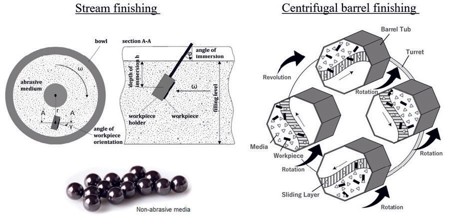

The adequate accuracy for gears used in electric vehicles is around ISO 1328 Grade 6, but high-speed gears rated for speeds over 20,000 rpm may have even higher quality requirements. The contact mechanics in the gear-tooth contact are sensitive to shape deviations at different wavelengths: form, waviness, roughness and microstructure. To optimize the load capacity and the NVH behavior, lead modifications are introduced (Ref. 5). Unfortunately, many traditional gear-cutting techniques, such as generating grinding, profile grinding, gear hobbing, shaving and honing, are plagued by twist errors. To address this problem, special process control or tool geometry adjustment methods have been developed to minimize twist errors in the manufacturing of gears (Ref. 6). To improve transmission efficiency, higher surface quality on tooth flanks is required. This leads to a wider use of advanced surface finishing technologies such as fine grinding or polish grinding (Ref. 7). For instance, with conventional generating grinding, it is challenging to go below Ra 0.5 µm, but when using a combined polish-grinding process, one can reach Ra around 0.1 µm. Mass-finishing processes such as accelerated surface finishing (ASF) and isotropic superfinishing (ISF) allow even smoother surfaces, with Ra down to 0.01 µm. Recently developed mechanochemical surface finishing methods, such as Triboconditioning CG process developed by Tribonex AB, can be used as the final finishing operation bringing about a triad of effects: (i) surface roughness profile optimization, (ii) compressive stress buildup, and (iii) tribofilm priming, which greatly improves the tribological and NVH behavior of gears (Refs. 8,9). Triboconditioning CG treatment can be carried out using standard mass-finishing equipment, such as vibratory tub finishers, centrifugal barrel finishers, and stream- and drag-finishers (see Figures 1–3). The major difference is the use of special chemically reactive process fluids and media types.
