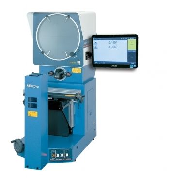

Mitutoyo Introduces New M2 2D Processor Package with PH-3515 Profile Projector
Mitutoyo America Corporation is pleased to announce the release of the new M2 2D Processor as part of a new package with the PH-3515 Profile Projector. The M2 2D processor updates the PH-3515 Profile Projector with a new touch screen tablet and easier 2D processing for measuring dimensions.
M2 2D Processor Features:
•Easy-to-use high-tech touch screen M2 geometric measurement display
•Graphics-based “part view” constructions: generate distances and tangent lines from within the graphical part view
•Geometric Tolerancing: measure features, set nominals, apply tolerances and view deviation results with only a few quick clicks
•Report Flexibility: Customize report data and format, including header, footer and graphics
•M2 Geometric 2D Measurement Software
•Optional Edge Detection
PH-3515 Profile Projector Features:
•ꬾ14” screen horizontal projector
•Horizontal projector is equipped with accurate linear glass scales
•Profile and Fiber Optic Surface Illumination
•10” x 6” Travel T Slot table for accessories
•Digital built-in angle counter
