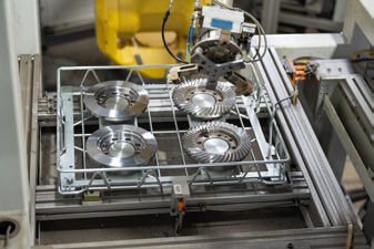

Croix Gear, a US-based manufacturer of custom gears, has recently achieved AS9100D certification, aligning its quality management system with aerospace and defense industry standards. The certification applies to the company’s full range of manufacturing processes and reflects implementation of documented traceability, process control, and continuous improvement protocols.
Best known for its specialization in bevel gears—including spiral bevel, straight bevel, hypoid bevel, and Zerol® configurations—Croix Gear serves a range of industries requiring application-specific gear geometries and high dimensional stability. The company also produces spur, helical, internal, and worm gears and maintains capabilities for high-accuracy gear inspection and quality documentation to customer specifications.
With AS9100D now in place, Croix Gear is positioned to support more complex requirements in aerospace and defense applications, where performance tolerances, material conformance, and process traceability are critical. The company’s bevel gear expertise includes precision matching, optimized tooth contact patterns, and consistent profile control across batches.

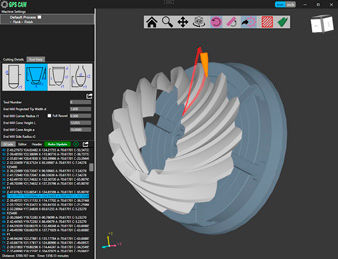

The GPS CAM module has been extended to simulate the production of straight and spiral bevel gears using fixed tools on 5-axis CNC machines. This workflow is suited to batch production where machine utilization and toolpath control are critical. Dontyne continues to support prototyping and gear testing, providing output in the form of CAD models, GPS project files, and inspection reports.

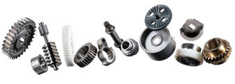

Forest City Gear, a precision gear manufacturer based in Roscoe, Illinois, specializes in fine- and medium-pitch custom gears for critical applications in aerospace, defense, robotics, medical instrumentation, and other high-reliability sectors. The company operates two facilities: its primary gear cutting and inspection plant and a dedicated turning facility known as Roscoe Works.
The company’s manufacturing capabilities include the production of spur and helical gears, involute splines, worms, worm gears, sprockets, and other cylindrical gear types. These components are produced in a wide range of materials and geometries, including small-scale parts held to tight tolerances for use in environments with extreme thermal, mechanical, or vacuum conditions. Their gears have been deployed in terrestrial and aerospace systems, including the International Space Station and various NASA rover platforms.
Forest City Gear supports both complete part manufacturing and contract gear cutting. Under its “Make Complete” workflow, parts are manufactured from raw stock through final inspection, including material sourcing, turning, heat treatment coordination, and finish grinding. Design-for-manufacturability input is offered at the early stages of project development. The “Cut Teeth Only” workflow applies to customer-supplied blanks and includes gear cutting, measurement, and final inspection. The company maintains a tooling inventory of over 7,000 hobs and 5,000 shaper cutters, enabling short lead times on a wide range of standard and custom profiles.

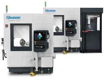

For bevel gear manufacturing, the Phoenix 100C supports small and medium-sized production with simplified setup and high accuracy for robotic and industrial gearsets. The Coniflex Pro Manufacturing System advances differential gear production with closed-loop process control aimed at minimizing surface stress, improving root strength, and reducing NVH.

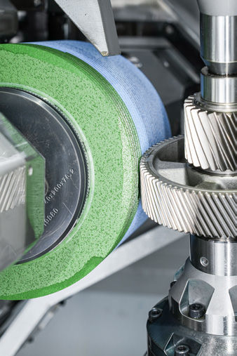

Liebherr-Verzahntechnik GmbH will highlight its latest developments in twist-free generating grinding, which include process optimization for asymmetrical gear teeth and the integration of fine grinding or polishing in a single machining cycle. Updates to machine kinematics and software functions now allow the use of dressable grinding worms at cycle times comparable to conventional generating grinding, with improved control of surface finish and profile accuracy.
The latest twist-free generating grinding process enables more flexible shift strategies. Enhanced kinematic control allows operators to separate shift position from shift length, minimizing profile deviations and allowing for precise definition of diagonal zones using the LHGearTec control interface. By segmenting the grinding worm to alternate between roughing, finishing, and polishing regions, users can influence tooth flank geometry and surface structure with greater precision.
These developments support applications requiring targeted load distribution, reduced excitation noise, or high flank surface quality. Standard dressing tools may be used, and double-sided dressing is supported, reducing tooling complexity and cost.
Liebherr’s technology is applicable to a broad range of transmission components, including e-mobility and heavy-duty industrial gearboxes. The process enhancements are supported by the rigidity and stability of Liebherr’s machine platforms and are designed to reduce both machining time and the number of required finishing steps.

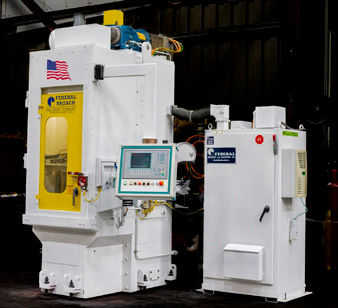

Nidec will feature several developments in gear manufacturing systems, including the Federal Broach MVRT, a dual-station, 10-ton vertical broaching machine with a 1,500 mm stroke. The machine supports both manual and automated load/unload systems and includes configurable integration options such as gantry, robot, and conveyor packages. Designed to accommodate variable production volumes, each station can be independently operated, minimizing idle time and mechanical wear. The machine features adjustable cutting and return stroke speeds and an electromechanical drive system designed for energy efficiency and low noise levels.
