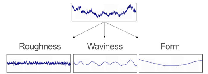

Separation of Form Error, Waviness, and Surface Roughness
A fundamental requirement of surface characterization is the clear separation of form error, waviness, and surface roughness. International standards define a cutoff wavelength—typically 0.8 mm (λc)—to distinguish between these components. Deviations with wavelengths exceeding this cutoff are classified as waviness, while shorter wavelength deviations are attributed to surface roughness. Accurate surface roughness evaluation, therefore, requires the systematic removal of both form and waviness components through appropriate filtering techniques.
Figure 1—Conceptually illustrates the separation using filtered surface profiles. (All images: Gleason Corporation)

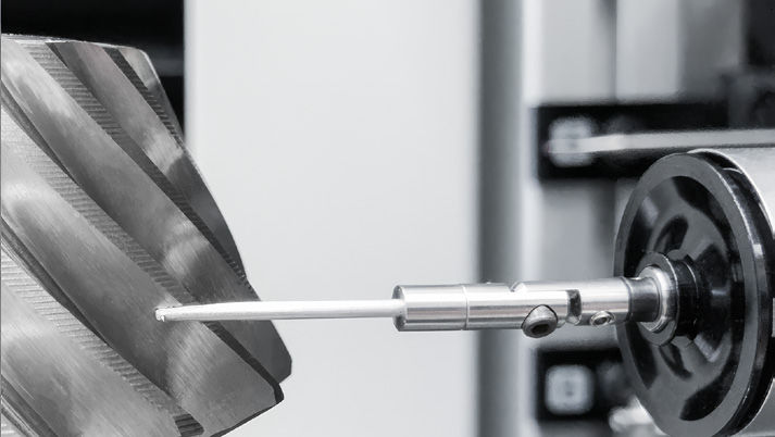

In addition to throughput limitations, conventional surface roughness measurement systems involve higher hardware costs. The extremely fine stylus tips required for high-resolution roughness evaluation are considerably more expensive and inherently fragile. These probes are highly susceptible to damage if not handled carefully (see Figure 2), leading to increased maintenance requirements and potential downtime. Furthermore, such systems rely on dedicated electronics optimized for high-frequency signal acquisition, adding complexity to the measurement setup.
Figure 2—Skidless surface finish probe.
In contrast, waviness evaluation does not require the same level of resolution or specialized hardware. By leveraging industry-standard spherical probe tips—commonly used for form measurement—it is possible to accurately capture waviness characteristics without the need for dedicated surface roughness instrumentation. This approach significantly reduces system cost and complexity while enabling longer scan lengths and faster measurement cycles. As a result, waviness analysis using spherical probes provides a practical and efficient solution for identifying surface-related deviations that influence noise, efficiency, and durability in bevel gears.

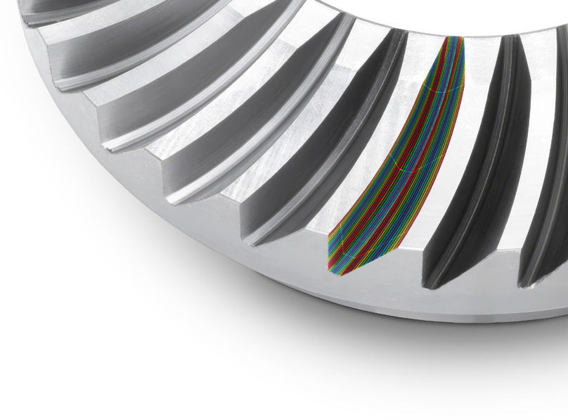

Figure 4—Illustrates waviness along the tooth depth.

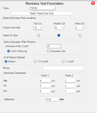

Software Implementation and Programming
Waviness analysis is fully integrated into the GAMA software environment, providing a flexible and user-friendly interface for evaluation. Operators can select individual or multiple grid columns, apply averaging functions, define independent tolerance limits for drive and coast flanks, and choose from multiple filtering strategies, including Gaussian and form-following methods, to tailor the analysis to specific application requirements.
All bevel gear measurements—including index, flank form, tip and root depth, and waviness—are completed within a single automated measurement cycle without the need for operator intervention. This integrated approach ensures consistent results, reduces inspection time, and minimizes the potential for user-induced variability, while supporting efficient and comprehensive gear quality assessment.
Figure 5—Shows an example of waviness programming within the GAMA interface.

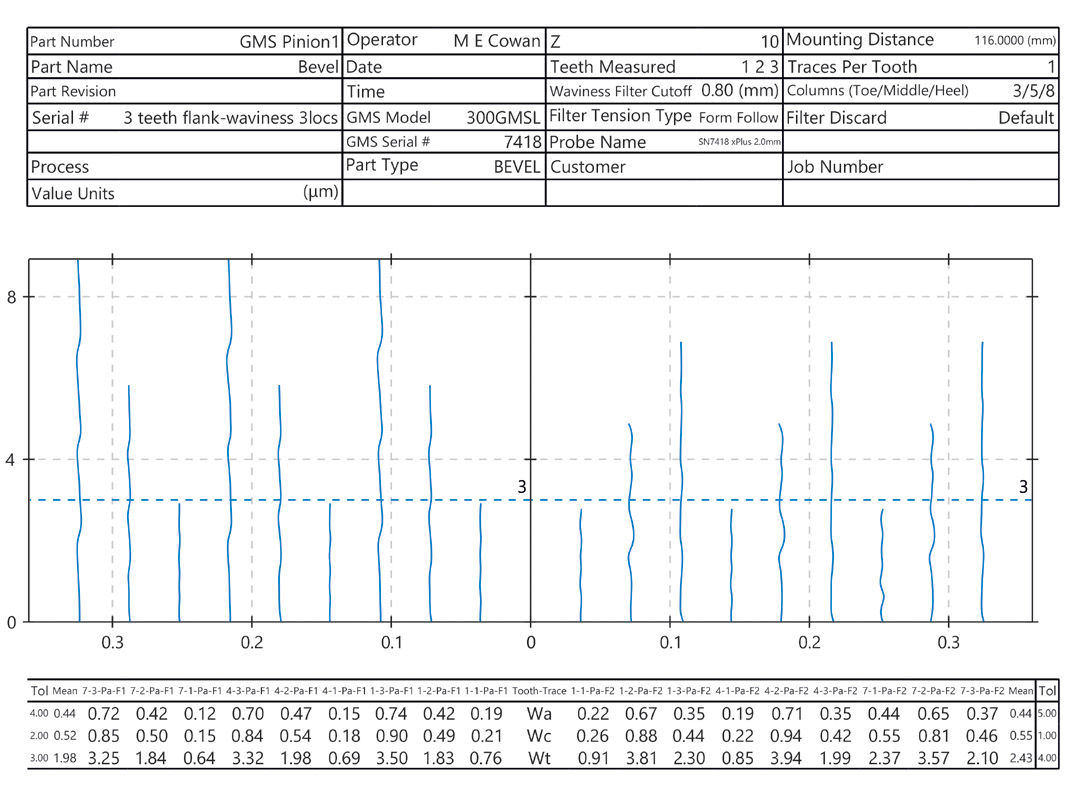

Advanced Waviness Charting
New charting functionality enables the visualization of multiple waviness traces for each tooth and flank, supporting rapid identification of systematic and localized deviations. Key waviness parameters—Wa (arithmetic mean waviness), Wc (maximum peak-to-valley height), and Wt (total waviness height)—are calculated for each trace and automatically compared against user-defined tolerance limits.
This enhanced visualization and evaluation capability allows operators and engineers to quickly interpret surface behavior, identify recurring patterns, and take targeted corrective actions, further improving process control and gear quality.

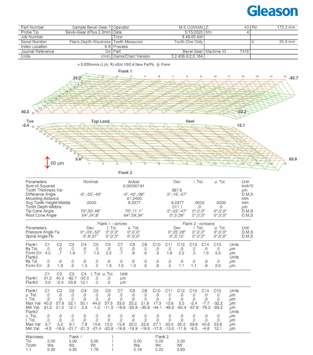

Enhanced Bevel Gear Charting
A new portrait-style gear chart consolidates deviation data, surface quality metrics, and key geometric characteristics into a single comprehensive report, enabling more efficient analysis and interpretation (see Figure 8).
In addition, a new bevel flank Form analysis has been developed to evaluate form deviations on a per-column basis along the flank form grid. This analysis incorporates the removal of longer-wavelength form elements—such as crowning (see Figure 7)—through second-order polynomial fitting. By filtering out these intentional macrogeometry features, the resulting form-deviation data more accurately represents localized surface variations critical to gear performance.
GAMA further enhances this functionality by allowing independent tolerance definitions for form deviations at each measurement column, organized across five distinct regions from heel to toe. This capability supports the application of region-specific tolerances along the spiral angle, accommodating intentional surface modifications—such as ENDREM—while maintaining precise control over critical areas of the tooth flank.

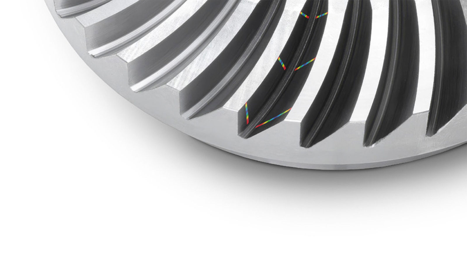

Bevel Gear Root Scanning
Root scanning capability enables the measurement of multiple critical features—including flank geometry, tooth spacing, top land, root depth and angles, as well as detailed root geometry—within a single automated inspection cycle. Root measurements are evaluated relative to theoretical design coordinates, ensuring accurate comparison to nominal values.
Nominal root data is stored in dedicated root definition files, allowing both standard flank form measurements and root scan evaluations to be performed within the same measurement cycle. This integrated approach improves measurement efficiency, maintains consistency between datasets, and supports comprehensive analysis without the need for separate setups or additional inspection steps.

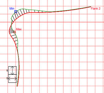

Figure 9—Flank and root fillet scan using nominal points from design software.
Figure 10—Root fillet scanning selectable locations along the face width.
