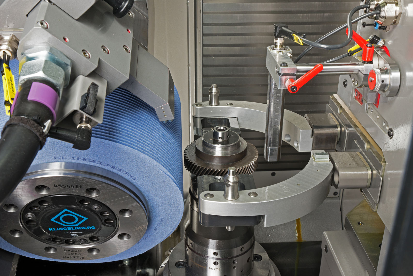

Figure_2_Closed-Loop_Speed-Viper.jpgClosed loop technology on the Speed Viper.

With the closed loop technology that connects Tremec’s measuring machines to the Speed Viper, the system calculates and analyzes the results automatically and suggests the required corrections where necessary in order to keep the process within the previously defined parameters. And the operator always has the freedom to accept the suggestions made by the system, or not.

“First, the Gear Designer software that we use to create programs and simulations to optimize the results of the microgeometry, cycle times, tool life, etc. Second, the closed loop system to keep the process under control. Third, an orderly sequence of steps when setting up the machine helps avoid human error – and trains the operators at the same time. Fourth, the machine’s rugged design is a key advantage,” Simental said.
The closed loop system, in fact, has exceeded expectations in terms of process control. The Speed Viper integrated seamlessly, so to speak, into the process landscape with flat hierarchies and a continuous material flow. As a result, Tremec was able to meet customers’ requirements for quality and delivery times.
