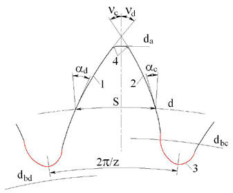

Modern gear design standards do not account for the geometry of asymmetric-tooth gears. Consequently, a conventional symmetric gear design is commonly applied to asymmetric gears featuring different pressure angles on their opposing tooth flanks. This methodology employs a customized asymmetric basic or generating rack to define the tooth geometry. Although technically practical, this approach restricts the full potential benefits that asymmetric gears can offer.
An alternative design approach for asymmetric gears eliminates the reliance on a basic or generating rack in defining gear tooth geometry. The Direct Gear Design method determines the asymmetric gear tooth profile by employing the drive and coast involute flanks derived from two different base circles, separated by the tooth thickness at the reference diameter. Additionally, a tooth tip circle prevents a pointed tooth tip. The optimized tooth root profile aims to minimize bending stress while preventing interference with the mating gear’s tooth tip.
Figure 2—Asymmetric gear tooth profile; 1—drive tooth flank, 2—coast tooth flank, 3—tooth root profile, da—tooth tip circle diameter, d—reference circle diameter, S—tooth thickness at the reference diameter, dbd and dbc—drive and coast flank base circle diameters, υd and υc—drive and coast flank involute intersection angles, αd and αc—drive and coast flank profile angles at the reference diameter, z—number of teeth.
The gear tooth asymmetry factor K is
(1)
The tooth thickness S at the reference diameter d is
(2)
where inv(x)=tan(x)-x—involute function of angle x (in radians).

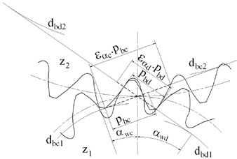

The asymmetric gear mesh is shown in Figure 3.
The drive and coast operating pressure angles are defined by Equations 1 and 3
(3)
The transverse drive and coast contact ratios are
(4)
(5)
Ref. 3 provides a detailed description of the definition of asymmetric tooth gear geometry.
Figure 3—Asymmetric gear mesh; 1, 2—indexes for the pinion and gear, αwd and αwc—drive and coast operating pressure angles, pbd and pbs—drive and coast base diameter pitches, εad and εac—transverse drive and coast contact ratios.

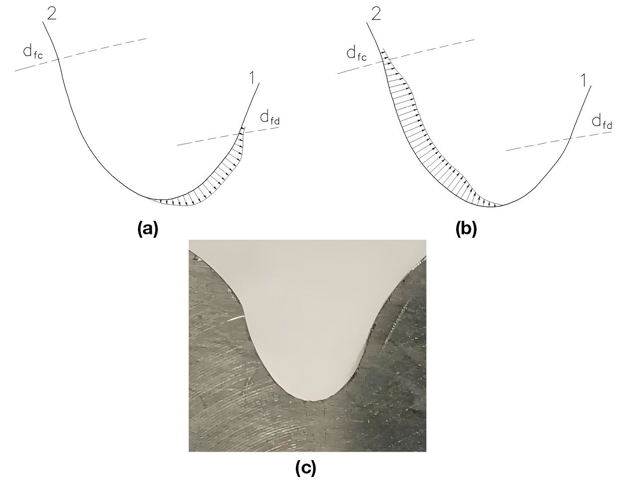

The Direct Gear Design methodology incorporates a tooth root optimization approach developed by Dr. Yuriy Shekhtman. This technique employs two-dimensional finite element analysis (FEA) using linear triangular elements for stress calculations. It is integrated with a random search algorithm to facilitate multiparametric iterations throughout the optimization process. The method utilizes trigonometric, polynomial, and exponential functions to accurately define the optimized root profile. As demonstrated in Figure 4, asymmetric tooth root optimization results in a uniform distribution of tensile and compressive bending stresses along the root profile, leading to a significant reduction in peak root stress values (Ref. 3).
Figure 4—Asymmetric tooth root profile optimization; (a) and (b)—tensile and compressive root bending stress charts along the optimized root profile; 1—drive involute flank, 2—coast involute flank; (c)—photo of optimized tooth root profile.

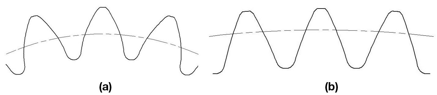

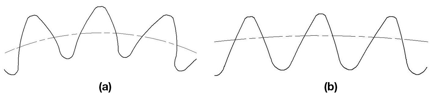

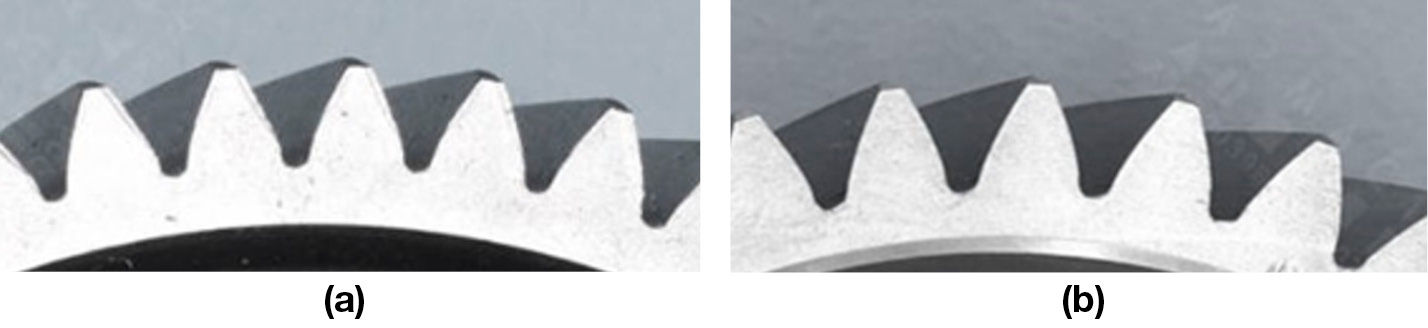

Figs. 5 and 6 show the symmetric and asymmetric gear tooth profiles. Fig. 7 demonstrates the experimental symmetric and asymmetric gears.
Figure 5—Symmetric gear tooth profiles; (a)—24-tooth pinion, (b)—83-tooth gear.
Figure 6—Asymmetric gear tooth profiles; (a)—24-tooth pinion, (b)—83-tooth gear.
Figure 7—Experimental gears; (a)—with symmetric teeth, (b)—with symmetric teeth.

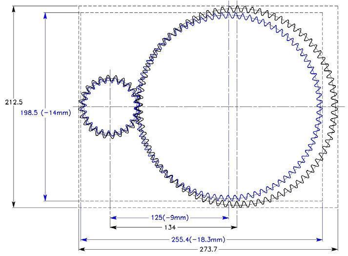

Fig. 8 shows an overlay of the original symmetric and reduced-size asymmetric gear stages, demonstrating a substantial reduction of the asymmetric gear stage cross-section.
Figure 8—Overlay of symmetric (black) and reduced asymmetric (blue) gear stages.
The dimensional reduction of the asymmetric tooth gear stage, as demonstrated in Table 3 and Figure 8, facilitates an assessment of the potential weight savings achievable through the application of asymmetric gears. The size reduction of asymmetric gears is characterized by their transverse cross-sectional profile, while maintaining identical face widths compared to symmetric gears. Consequently, gear weight can be approximated as proportional to the transverse cross-sectional areas of both symmetric and asymmetric gears, as illustrated in Figure 8.

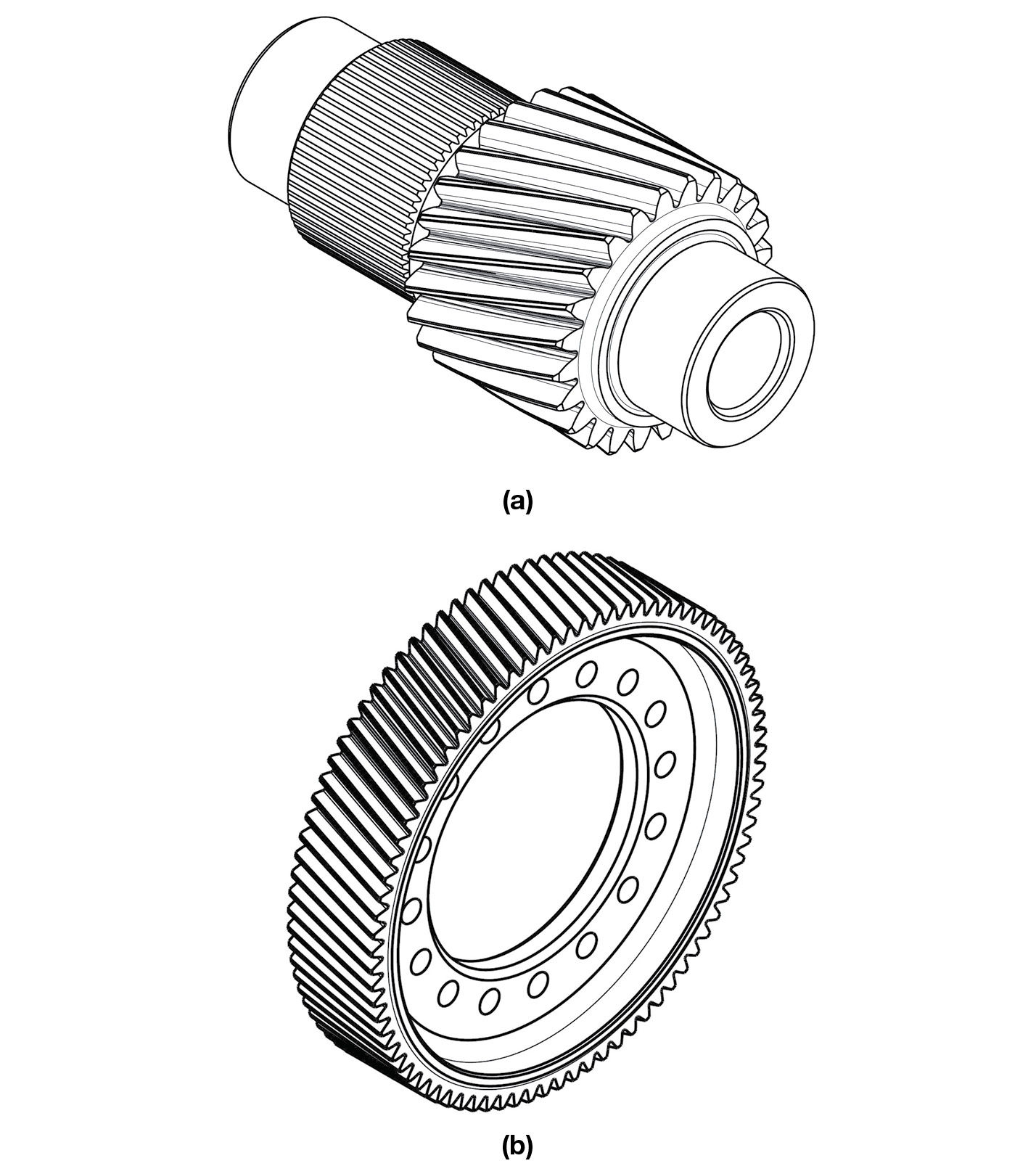

Gear weight is primarily determined by its structural design, which typically includes a central bore and machined relief areas aimed at weight reduction, as well as specific features that support integration with other gearbox components. Figure 9 presents common configurations for gear body design.
Figure 9—Typical driving (a) and driven (b) gear body designs.
