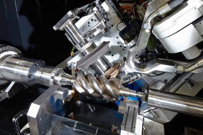

Zenith 400 helical profile grinder
The Zenith 400 represents the very pinnacle of PTG’s helical profile grinding technologies and is the first machine of its kind to offer three grinding wheel options: aluminium oxide, ultra hard plated CBN and vitrified, dressable CBN. The Zenith 400 combines a 420 mm diameter grinding capability, with a maximum component weight of 700 kg. In addition to being a high precision, helical profile grinding machine, the Zenith 400 also offers high stock removal rates and aggressive semi finishing, with production rates and accuracies tailored to each customer’s needs.
EX series rotor milling machines
Holroyd EX series rotor milling machines have earned worldwide acclaim for their high speed, accuracy and unbeatable build quality. The standard range of EX series models can cut rotor or worm helix profiles in blanks up to 850 mm diameter. Where 850 mm is too small, Holroyd can build a 10EX machine that can perform the same functions on blanks exceeding one metre diameter. The flexibility of EX series milling machines means that they are equally efficient at producing complex components with helical screw profiles and gear parts such as worm shafts.
GTG2 helical gear grinder
The GTG2 helical gear grinder sets new standards in the production of ultra-precise gears in diameters of up to 350 mm. Effectively a self-contained production cell within a single machine, the GTG2 offers: fast set-up to optimize production and minimize operating costs, fully automatic programmable cycles, a fully automatic grinding wheel balancing system, and the high power required for deep grinding operations.
