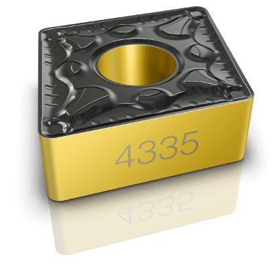

Cutting tool and tooling system specialist Sandvik Coromant has introduced its GC4335 insert grade for the turning of steels where unstable conditions or vibration issues prevail. GC4335 is designed to bring about secure and predictable machining as well as shorter cycle times and better machine utilization through reduced stoppages and longer insert life. Customers will benefit from an improved process with less risk of insert breakage as well as reduced cost per component and faster return on investment.
GC4335, which features Inveio coating technology for maximum thermal protection, offers greater steel turning endurance through improved edge-line security in comparison with the previous generation grade, along with greater resistance to flank wear, plastic deformation and crater wear.
