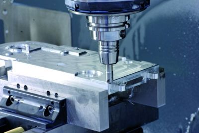

Schunk recently introduced the new Tendo Platinum toolholder. Tendo Platinum offers improved brazing technology by using a brazing and hardening process all in the same cycle.
The Tendo Platinum is balanced to G2.5 at 25,000 RPM. With improved vibration dampening and precise run out accuracy of less than 0.003 mm (0.0001") at 2.5 x clamping diameter, the Tendo Platinum works in configuration with the machine spindle and the cutting tool, to reduce wear and damage.
Schunk offers three lengths with two precision ground taper sized: CAT40 – 2.5", 4", 6" / CAT50 – 81 mm, 4", 6".
Schunk also offer direct clamping in both metric and inch sizes to assure improved accuracy and vibration dampening.
