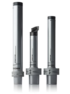

Seco has added turning bars to this patented line of damped tooling that brings increased productivity results to a wide variety of long overhang machining operations. Featuring the company’s new, patented GL connection, the same Steadyline turning bar performs both rotating and static operations to increase versatility while helping to reduce overall tool costs. Available in 6xD, 8xD and 10xD, a range of types, including Seco-Capto C4, C5 and C6, and a broad selection of turning heads for CN, DN, WN, CC, DC, TC, TN and RN inserts as well as heads for Snap-Tap threading, Steadyline turning bars can handle a variety of applications and operations, including roughing, finishing, threading and grooving. In addition, these bars feature coolant supply channels for enhanced chip evacuation.
