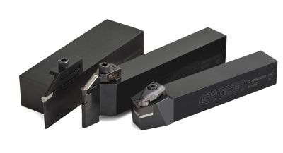

Furthermore, Seco has added new N-class (Quick-Line) ceramic insert holders to its comprehensive product portfolio. Available in standard shaft and Seco-Capto styles, these holders have special pocket designs and clamping systems that easily accommodate the different thicknesses and missing center-mounting holes that are common with these types of inserts.
